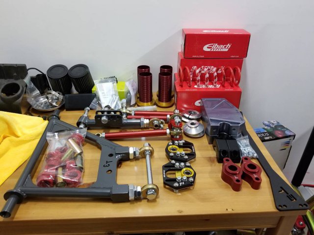

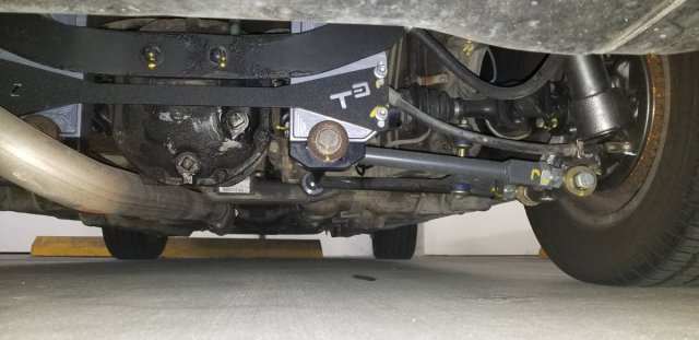

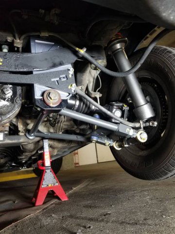

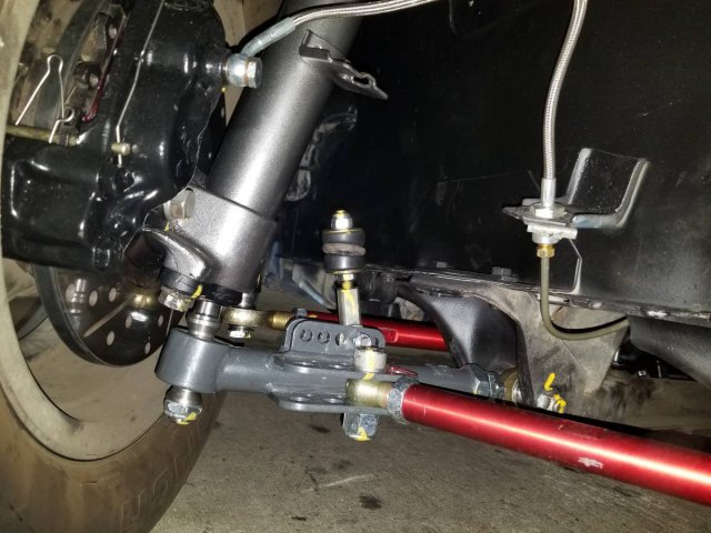

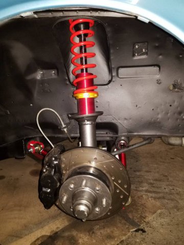

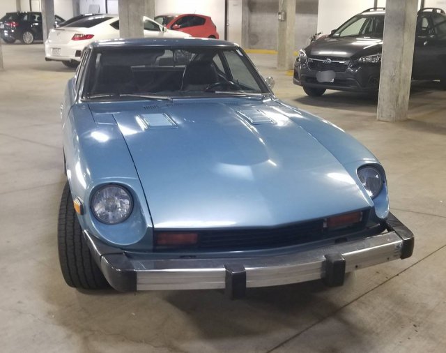

  1. Selling a perfect condition 1977 Datsun 280z. Los Angeles California $15500 75000 miles 3rd owner Original paint Great condition Inline 6 cylinder 4spd manual No rust! Rebuilt suspension: Full T3 rebuilt coilovers. Adjustable control arms. (front and Rear) New Adjustable steering Rods Solid Rear drop mounts And Dog Bone Tokico illumina shocks Eibach springs. Transmission: New clutch New master and slaves New u joints New Dif mount New interior: New seats covers and foam New carpet New soundproofing Brakes: Upgraded 4 piston front brakes SS brake lines New front brake hard lines New rear shoes and drum Engine: stock 6cyl engine Cali smog compliant Aftermarket MSA cat back exhaust. All original parts available and in good condition, if you're interested in returning it to factory conditions This car has been a project car and daily driver. It was a joy to work on and a super fun car to drive. Contact by phone or message (3 two 3) four 7 four -17 four four
