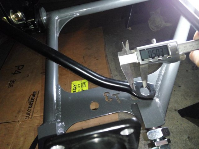

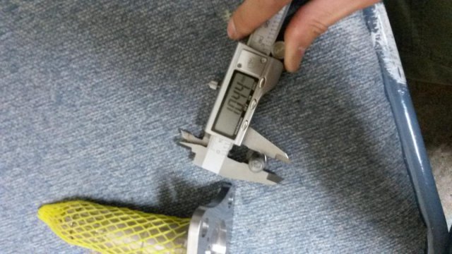

Were you looking for measurements of the ES bushing clamp? If so I can snag the dimensions for you tonight, I ordered up a universal one after measuring the ST rear sway drop bars a while back. Thought you were looking for the final dimensions of the bracket I've been measuring up. Only difference for me may be the thickness of material used as the ST rear sway drop bars are what they are. Yeah, I put a jack under the rear LCA with the coil turned all the way down so I wouldn't be fighting the spring. Once the frame just starts to lift off the jack I measured something like 1.5" between the sway bar endlink hole and the rear LCA endlink hole. With the CV in place at "ride height" it was something like a 1-2" swing up for the swaybar before hitting the CV. Would be maybe another 1/2" gained there with the sway bar spaced back due to the bends being positioned more optimally. It'll fit for sure, but need to find a good height for the endlink although it seems doubtful the suspension would ever reach full droop unless I start 2-wheeling around the track . Edit: Actually if memory serves (pulled the old sway off a year ago when I decided to rebuild the sus/brakes/drivetrain) the original sway setup I had was actually hitting the stock u-joints at full droop. Didn't drive the car enough to figure out if that was an issue, but I found that interesting. Also by design the "clamp on" style brackets spaced the sway bar back around 0.5-0.75". -

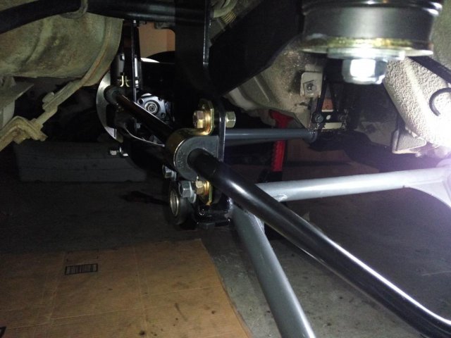

Thanks guys, Do you recall how far back you spaced your swaybar? Finally got some time to throw the rear diff in there and mock up the car at ride height. It looks like I'll need closer to a 1-2" spacer. I'm thinking with grade 8 swaybar mounting hardware (or better) this should be fine as the shear characteristics won't change substantially with a solid spacer. Thoughts? Edit: Also spacing back that far is to partially account for interference with the CV's. It's a really tight fit and the angle of the swaybar from the back is not conducive to good clearance. At full droop sway touches the CV's with a short endlink distance. Still figuring out the final measurements for this thing. -

Mike- thanks for the idea. Interesting concept, but I think I'm going to try to keep it simple for the first go around. Eventually I want to run heim joints for the sway bars, but that'll come later as I develop the car...want to get it back on the road first! seattlejester- not a problem. I'm going to measure out the dimensions this week and prototype up some brackets out of AL stock on my buddy's mill once I figure out what stock to order. Probably take 30 mins-1 hr total, but this is a slow moving project so probably won't get back to you until next week . -

Thanks! Great info in that thread. After a quick measurement, looks like 1/2" aluminum stock will do the trick just fine. -

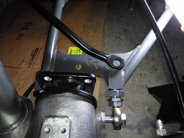

Hi all, Here the background: I have a really old swaybar setup from the 80's which used to mount via sandwich plates to the rear drop bars. I ended up finding ST rear drop bars for a good deal then figured out the old swaybar would work with the ST drop bars. My buddy is going to swing by sometime with the ST rear swaybar to compare dimensions but I'd like to avoid getting another rear sway if possible since I already had everything powdercoated. Even with the old sandwich "style" sway bar mounts, the spacing between the OEM control arms and sway bar endlinks was not ideal. I'm thinking once I get the diff and CV's in there to fab up some 1/2 to 1 inch spacer plates for the rear sway bar bushings onto the ST rear drop bars + measure out the appropriate endlinks at that time to ensure no binding or interference with CV's at ride height. Q's: 1) Is spacing the rear swaybar back pretty common on Z cars to prevent binding? 2) Any issues with this approach? I've attached some pics to show the issue. Thanks! Edit: Upon further research, I see this has been done before: http://www.typeischeap.com/Rear_Sway_Spacer%20(Custom).jpg

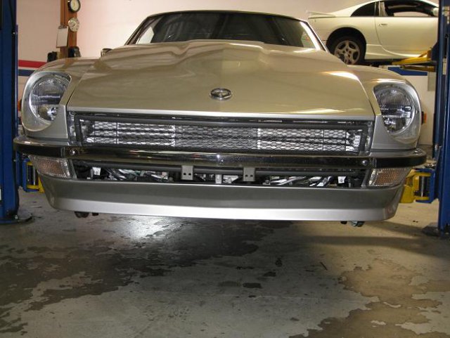

Thanks for the responses. Hmm...the MSA lip does look really close. Had to do a double take there, actually looked at that MSA pic the other night and thought it looked off. Any other takers?
Anyone have any ideas? Also where to get one? I've never seen it stateside, but I'm really digging how it's 1 piece versus the "euro"/aussie lips which bolt on to the lower valence. Thanks!

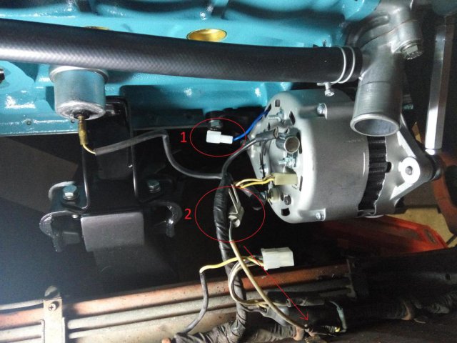

Thanks NewZed, There was some generic warranty info with the alternator but nothing really useful from what I recall. Good to know that plug may be unused on my application, I may just tape it off and hide it if that is the case- will cross check after work. I'll double check my service manual to see what purpose that condenser serves. Took a break from this project for a couple of months so it's a bit of a learning curve to get back into it. Should've taken more pictures! Edit: Interesting, just checked and it looks like it could be the 6v P-"Phase" terminal The alternator is "generic" and used for a lot of applications. The ZX Turbo happened to use the same alternator sometimes, but did not use that terminal as it was also "generic" in that car. P stands for "Phase" and the terminal is an auxiliary pickup point for partial alternator output, single phase - approx. 6V, to drive some tachs and other accessories. It's basically the same as a bridge tap on transformers. If you want to go hogwild with 6V, I am sure you can figure out some use for it, otherwise just leave it be. http://community.ratsun.net/topic/7063-280z-alternator-p-terminal/ Learn something new every day. -
Hi all, Hoping someone can shed some light on this: I am doing a 280zx alternator (non-turbo) swap into my late 1973 240z and am planning to use the conversion plug with a diode + rewire the factory fuel pump wiring to operate off of an oil pressure switch (late car, had the electric pump in the back). I purchased a remanufactured 280zx alternator and there are 2 connections I am unsure of: 1) The single blue wire and connector coming from the alternator (No idea on this one) 2) A condenser plugged into the chassis harness (What is this for? Should I keep and bolt to ground somewhere?) Anyone have any ideas on #'s 1 and 2 in the attached photo? Otherwise seems like a fairly straightforward upgrade. Thanks!

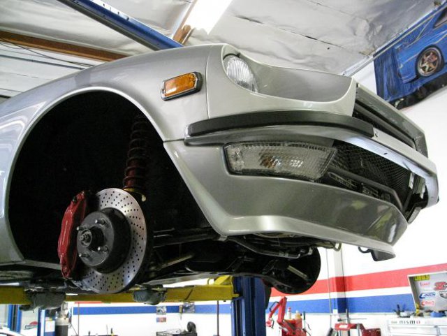

Just to confirm and a bit sidetracked from the OP's original question, I have 15x8 0 offset RKR's and with a square sidewalled tire they will fit both inboard and outboard speaking from my own physical mockups with full T3 suspension and brakes/OEM F/R hubs (e.g. F/R control arms, full coilovers, caster arms, wilwood disks). With AZC knuckles and outboard/fender clearance that is a different story and something I had not considered when picking up the 15x8 0 offset RKR's. I spaced things out with washers and you'll need something between 5-10mm spacers to clear at a minimum. I'm thinking closer to 10mm but memory is a bit fuzzy. Note however I want to run sticky 225's. If you are willing to run a stretched tire and/or lots of negative camber the dynamics change entirely. From my measurements and as casper9182 alluded to above, simple solution is to upsize to 16's or 17's so the AZC knuckles will clear in the barrel. That is, unless you want to stick with 15's (which is my case). Edit: I should also note I know a local z owner with AZC knuckles and 15x7's on the front in I believe 0 offset and no spacers. Last time I looked barrel doesn't extend inboard enough to hit the AZC knuckles. No tire stretch but can't remember the width. I know the rears are 15x7 running 225's. Clears inboard/outboard front and rear just fine.

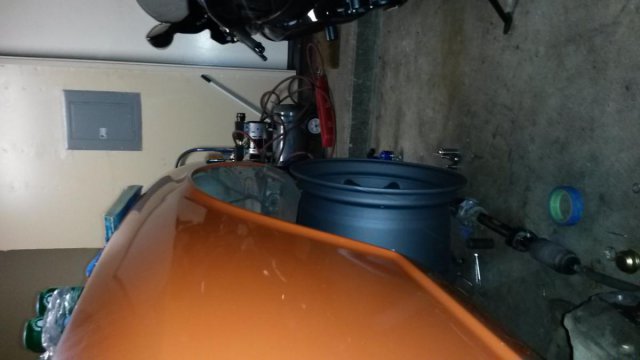

Curious about pic above. Have 15x8 0 offset RKR's and with AZC knuckles will probably need ~10mm spacers to clear. If the OP pic is something like a 15x8/15x9 -10 to -15 offset then I'm assuming 225's fitting under the factory arches without negative camber + roll + pull is out of the question? I've attached a pic when I threw a 15x8 0 offset RKR on the other day for a quick visual. Granted there is no load on the suspension, things aren't looking too peachy if a 10mm spacer gets thrown into the mix although 15x8 0 offset looks like it'll fit excellent to the fenders with good clearance on the back.

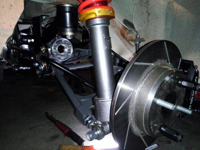

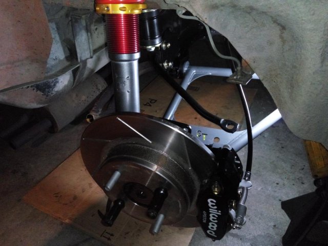

I recently did the full T3 coilover setup and I would recommend purchasing a 20ton Harbor Freight press or similar if you have the space to do so. Here's what I pressed which is fairly universal and not just T3: 1) Front hub Inner Wheel Bearing Races 2) Rear Hub Wheel Bearings After that it's all a bolt-on affair. I paid something like 100-150 for the press after tax during a Harbor Freight sale which happens frequently and the entire process took me about 2 hours drinking beers with friends. In those 2 hours we were also cleaning things, generally messing around, and installed Nismo studs on all 4 corners so you could probably get this done in an hour if you're really on-point. You can take the parts to any shop with a press and does suspension work, really. the 100-150 and 2 hours of labor and beers/some BYOB should give you a ballpark comparison of what it would cost you versus a local shop quote. I'm in CA so shop prices here are pretty high unless you're friends with the owner. Edit: As RebekahsZ mentioned, you can (and I have) used the press for a lot more than just wheel bearings. I've actually used the press for every vehicle I've owned including my motorcycles and others. It all comes down to if you have the time, space, etc. As with most tools, It'll save you a lot in labor for the long run if you actually use it.

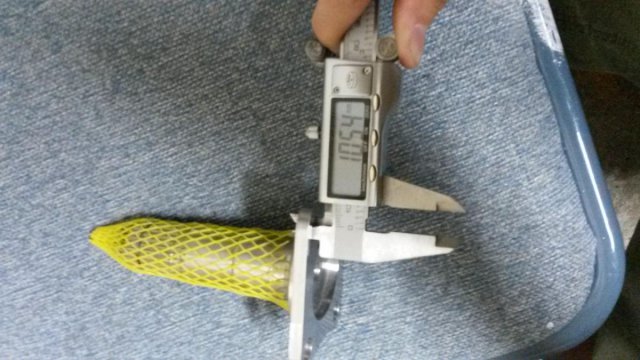

I finally got around to knocking out the old "D" type half-shaft studs from the Datsun R180 to install onto the Wolf Creek Racing R180 Axle Adapters and ran across an issue. Basically the OEM 240z "D" type studs which I was under the impression should be a press fit (based on tapping out from the OEM diff) dropped right in with no effort into the Wolf Creek Racing R180 Axle adapters- I've attached some pictures with measurements for reference to show what I'm describing. Can anyone confirm that the half-shaft studs should be a press fit? Here is the part I am referencing: http://www.wolfcreekracing.com/index.php?option=com_content&view=article&id=22&Itemid=31 I did a bit of searching as well and found this post: http://forums.hybridz.org/topic/78123-subaru-wrx-sti-r180-side-axles/page-13?do=findComment&comment=864749 It looks like the OEM studs should be a tight press fit but just wanted to be sure before contacting Wolf Creek Racing to see what my options are here (I'm assuming either return the parts or tack weld each stud). Thanks! Edit: By press fit I mean interference fit
