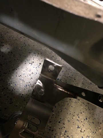

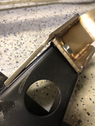

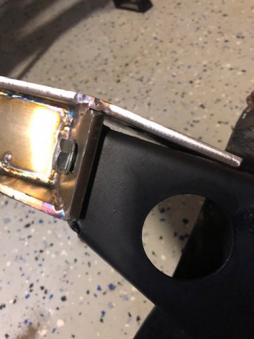

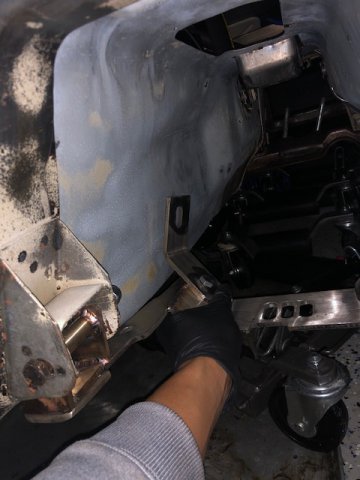

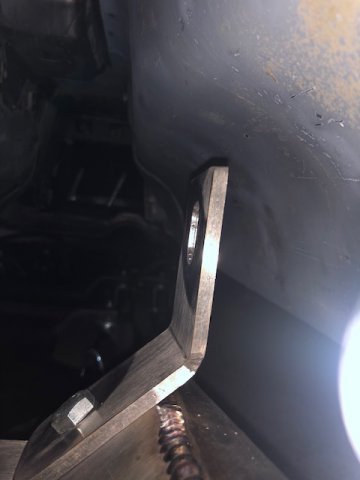

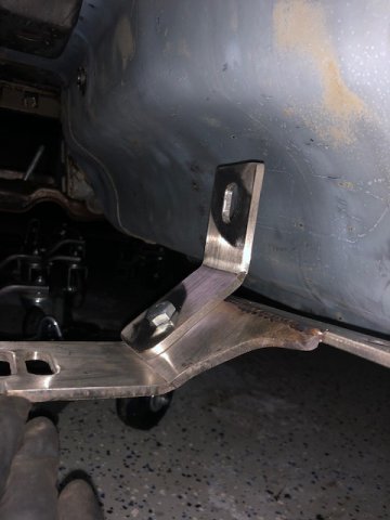

So i was able to speak with CX Racing customer service. I spoke with a representative who was familiar with the LS / S30 platform and he said that on 280z's since the trans tunnel is wider, you would only use the front set of adapter mounts, and not the rear mounting tabs that required drilling to the seatbelt hole / trans tunnel area. For the motor mount issue, i sent them an email with photos and they told me they'd review the photos, and if there was an issue with the mounts they they'd send me a new set. Not bad so far! Keep in mind that my mounts were purchased about 4 years ago, and they are still willing to look into this issue for me. I'll keep everyone updated, but so far my experience with CX has been good and responsive so far. -

Hi everyone, i'm finally getting around to mocking up my LQ9 and T56 combo in my 75 280z using the CX Racing kit, a couple of things i noticed and i wanted to see if anyone else has had these issues before reaching out to CX Racing. 1 - the mounts dont sit flush on the subframe ( Photos 1 & 4) . The bolt surface mates up fine, but the side pieces that have "cx racing" stamped on them have a fairly big gap against the stock subframe. This is present on both mount pieces 2 - The transmission mount. I ended up using the adapters that connect to the stock tranny ears. with the tranny mount installed, the rear bracket points (Where theyre supposed to bolt through the seat belt holes) don't line up on the drivers side. the passengers side i can probably fanagle, its not too bad ( Photo 5) , but the drivers side tunnel on my 280 has a larger hump, and the bracket is no where near even possible to bolting up, theres maybe a 5" gap before it reaches (Photos 2& 3 ). Last photo is taken in the car through the shifter showing the gap between the mount and drivers side tunnel. Has anyone had these issues before? Hoping this isn't a major flaw with the parts, i hear CX customer service can be hit or miss. And for some reason i can't find the youtube video for their install either..
