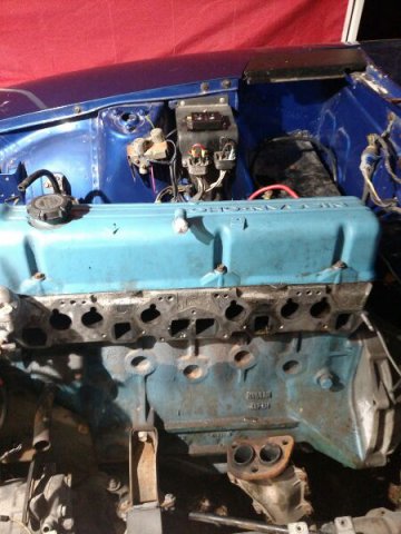

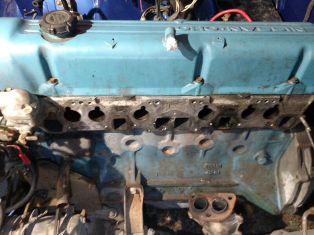

Soooo, alot has gotten done but it seems like for every thing i get done a new problem pops up. Everything is assembled at this point, for now. while installing the exhaust manifold i managed to crack it and afterwards realized its a round port manifold on a p90 head, i bought one from a member here and i have it but havent put it on yet because i want to avoid unnecessary assembly/ reassembly. after researching the manifold issue i found out i have a p90 head on a block with stock dished pistons (bought a scope and looked through the plug hole) dropping my cr and I already have bought the intake and holley setup so im not going to switch to a turbo build this far along and i dont want to shave the p90 so that leaves the option of finding a n42 head to match the exhaust manifold i have. is there a stock cam that would work better than one that comes in the n42? the car starts right up, idles ok and runs decent but theres definitely alot of room for improvement in the power its producing, anyway, just a quick update, rims and tires that are going to be ran for a while are on, the carb still needs to be tuned, thinking about buying a gunson color tune, any advice on them? seems like it should be adequate to get it close enough until I bring it to a shop once everythings installed completely for tuning. i guess the next step is to find someone wanting to do a turbo build that will trade me a n42 w a cam for my p90

Have a p90 head mounted on my n42 block, have Holley na set up so turbo isn't a feasible option, looking around for n42 head, willing to trade my p90 for it and cash one way or the other depending on what you have

So I dove in, spent over 1000 so far in parts with out doing all my homework first. After looking for a replacement exhaust manifold discovered that I have a n42 block with p90 head. Everyone seems to want them for turbo builds but having just put a Holley 390 and Bob sharp intake and a turbo is not the way I want to go. I'm under the impression that unless the pi put flat top pistons my cr is gonna be 7.4. After alot of work I don't want to end up w a car that is less powerful than stock. So there's a few options, shave head, flat tops etc. I'm not ready for a top or bottom end overhaul right now. Is the logical solution to find someone that wants to trade a n42 w possibly some work done to it?there's one on eBay for 350 w spray bar? Is this fair? Wat should a p90 sell for, car has been running, idling, revved but not driven yet so p90 seems in good working order, thanks for any ideas all

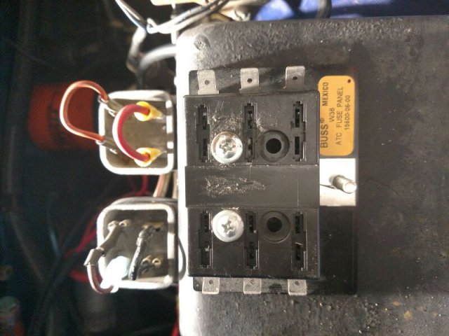

Also ordered the intake/exhaust stud kit from z store, looks like efi intake was secured to block w larger bolts and bsr manifold attache thru 2 smaller holes on either side of large bolt hole. Patiently waiting on parts now

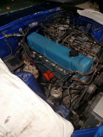

Yesterday was a long day but still managed to motivate myself to put a couple hrs in. The intake and all efi components under the hood along with some wiring has been removed, everything came apart easily , not all the nuts and bolts were the same size so I can tell it was reassembled by someone not paying attention to detail, I now have a tub full of efi parts, if anyone has need for stock efi stuff let me know, dropping resistors, and, ecu are all good, injectors were shot, a few were solid varnish on the nozzles. Also because I usually do my summers in Maine to avoid the heat and this isn't a daily driver I decided to

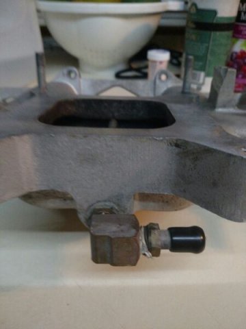

I was fortunate to have the paint and body work already done, I'm far from set up to paint a car, I just did a pretty good backyard paint job on my 92 Honda vt1100 shadow but a motorcycle is a far cry from the setup needed to make a car come out good. I've often wondered what world someone must be living in to ever consider taking a unibit to lug nuts holes by hand and expect it to work. Intake gasket came today so tmrw I'll start stripping the old setup, no one has any ideas on how to set up vaccum ports to bsr Holley intake? There's only a few ports, does anyone know what must be hooked up to vaccum for car to run right?

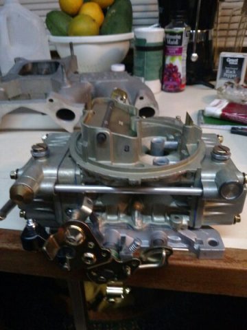

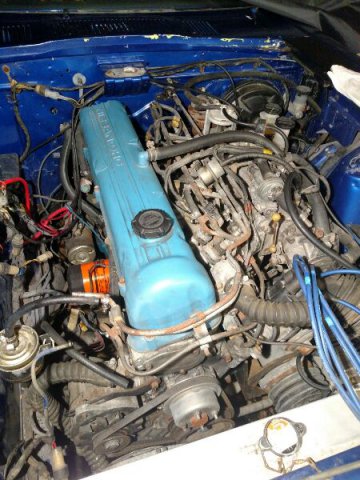

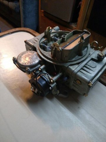

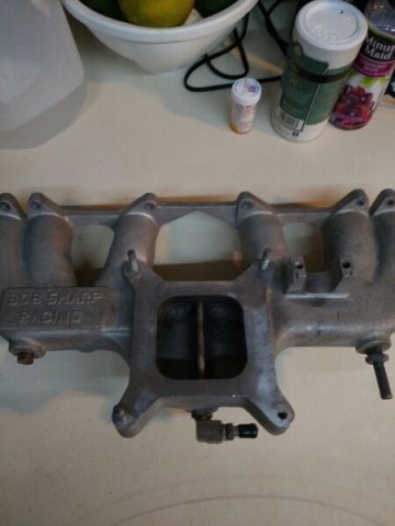

The efi system was a mess, missing pieces, stuck injectors, butt splices and wiring gremlins everywhere along with the typical corrosion on terminals, after a week of tinkering it started, ran super rich, in somehow I later realized dumped at least a quart of gas into the oil. Things were hooked up incorrectly and after a while I made the decision to start new and do the Holley 4bbl conversion. I started ordering parts. I've bought a Bob sharp racing Holley intake, Holley 390 cfm carb, intake gasket, adjustable fpr w gauge and a distribution block to add circuits. The carb fuel pump will be ordered tmrw along with the throttle kit and air cleaner and a few relays to set up a fuel pump circuit and electric fan circuit. Here's a few pics of the parts I have so far. My first question is about the ports on the bsr intake. Facing the intake so that the writing on the intake is right side up, the port currently blocked off on the left should have an 1/8" Barb for distributor vaccum advance?, on the right the larger one is brake booster?, below the plenum there's a chamber with a port on each side, I think it's the water jacket like the Clifford intake advertises? Never seen on up close so I'm not sure tho. And one side is blocked off, so if its supposed to heat the mixture to better atomize the fuel by passing water from radiator through it then why would one side be blocked off? Not blocked, but a port with a cap on it? Fgoing to start stripping efi stuff and try to get intake installed this weekend if gasket comes in the mail so any ideas would be great. I'll try to take some pics as I go, sometimes get caught up in the work and just want to get it done. Thanks

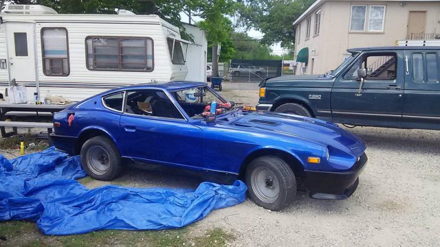

Hey all, new here, posted a few times and and decided it was time to start my own thread. I know a little, know I need to learn a lot and am open to suggestions and input and am sure I'm going to have questions along the way. The story on the blue dog is that she was acquired in trade for a cpl weeks of nights and weekends working on one of the po's other cars. She was a far from finished project that had been sitting for 4 years. She came with a lot of uninstalled parts including the aero body kit, new in box which was fortunate because I had to put the bumpers from blue dog on the other 280z I was working on in trade. I temp painted and installed the body kit, rear hatch glass, head lights door handles blinkers tail lights, seats and all the other bits and pieces remove for paint. Installed the bigger master cylinder, drilled slotted rotors and Toyota 4x4 calipers up front and 240sx w drilled rotors in back, still need e brake cable. I bought a windshield but an overzealous neighbor who was helping managed to break it. I have since found another one for 20$.
