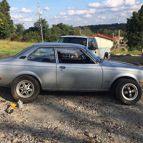

I didn’t consider using these on this car untill now, but they are 7” wide I assume. I’m not a huge fan of them, but they won’t cost anything.

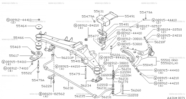

Well honestly I’ve never layed under a ZX long enough to even know what the suspension looks like. I did come across this exploded view of the crossmember and control arms. Assuming this is actually correct I think making a new LCA would not be out of the question for me. Using threaded heim joints would make the toe very adjustable. As for camber, I have seen mention of camber plates. Is that really a thing for these cars and if so it would seem to be pretty easy. I have also also seen coil over conversions, but they are pretty pricey. I’m changing my plans for the car now. I am either going to sell it, or sell my 78 Dodge colt and make this car my daily driver. I am unsure what I am going to do. Can I get 245s on the stock wheels? So a 245-55 r14
Looking through Rotas site, I really like the Shakotans. I have seen them on zxs when I googled it so it’s a possibility. They kinda go completely against the budget idea that I had but though. I did not see offset options on their site though. I tried searching for into on custom LCA but did not find any results. Fabricating it would not be a problem between the what I have and what friends have. As for tire size, I want to go as wide as I possibly can for traction and for looks but I think with the minimal power and weight of the car the costs to go that wide would not be worth it.

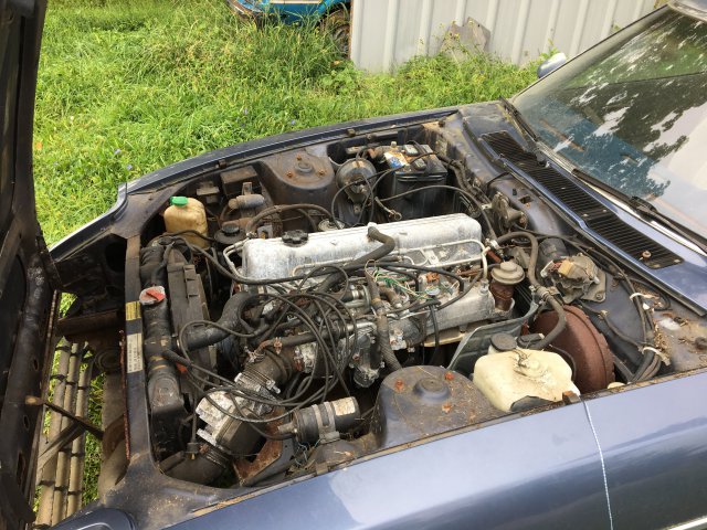

Wow I am surprised a 275 will fit in the stock wheel wells. That’s pretty exciting though. I have been a bit lazy on searching on the forum. I need to spend more time looking and I am sure I will find all my questions answered already. I have never messed with a MAF efi system outside of repairing my stock vehicles. I’ve only worked wth speed density. I am glad to hear it’s pretty basic, so trouble shooting shouldn’t be to painful. I mainly want to remove the smog equipment just to clean everything up. Also what’s the little blower for on the passenger side of the engine? Sorry i should of been more clear on the dash pad. I would like to find a stock dash to drop in it, are they hard to come by? The previous owner had a carpet cover on it. I wouldn’t be against a cover like you suggested g tech, if they fit well.
Well I see there’s always a few ZXs on eBay being parted out, and Car-part.com seems to have quite a few on there. I figure I could get some steel fenders from one of those 2 places. They will be easier and fit better than glass ones anyway. I really wanted the wheels for my dodge colt, but your car looks really good with them, I may just leave them on the car for now. I wanted to source either some aluminum slot wheels, or steel “circle track” wheels (not sure what they are called). I’ve ran megasquirt on a few of my vehicles and I would like to go that route someday. I could easily set up a crank trigger and run LS coil packs in waste spark. For now getting it running with what it has is the goal. Few questions that I do have -Are aluminum slots or mags hard to find for the ZX? -What’s the widest tire than I can fit under it front and rear? -Will the efi give me fits removing the smog and she? -Are lower quarter latch panels available? I kept coming across stuff for Zs but not ZXs. -Are good dashpads obtainable? I jist really want want to make this a autocross Car. I’ve ran on the track with my GTI but my friends have gotten into autocrossing and I am dieing to try it. This seems like a great foundation for that. Thsnks for rhe reply!

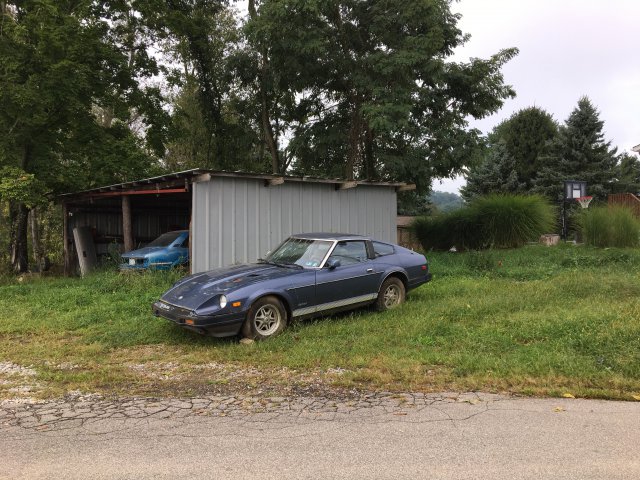

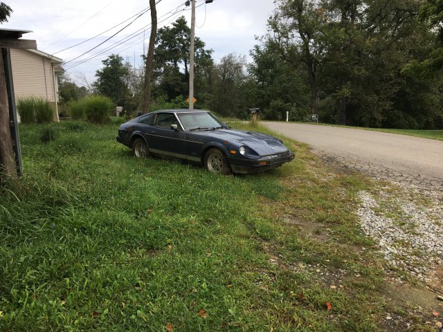

I bought this car for a very good price. It was advertised with no title which I was fine with because I wanted the wheels for my 78 Dodge colt and I could use parts from it on my 260z. When I arrived to buy it the owner found the title. So that changed my plans. I still want to steal the wheels for my colt, but I want to make this car a DD/autocross Car and maybe a track Car some day. Previous owner replaced a lot of parts and said he had the top end off and that he think the cams timing is off. The engine harness has been cut up, someone used crimp butt splices for the injectors so I will have to go through all the wiring. The shell is very solid aside from the rear lower quarters, fenders and valance. My goals/plan -Pull too end off engine and check it out -Clean up wiring -simplify vacuum system/remove smog stuff (I know some advise against it) -clean up engine compartment (plumbing and wiring) -shave rear bumper, repair rust -new fenders and valance (not sure if I will go steel or fiberglass) -clean up interior -simple stereo (amplified 2 way components) -respray the Car the factory color Im currently getting a game plan, I want to do this on the cheap, but not incorrectly. I will post pics when I make any progress.
