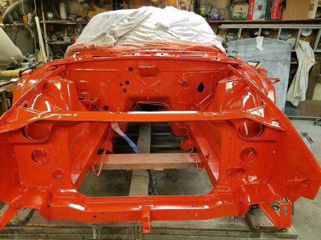

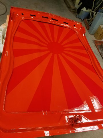

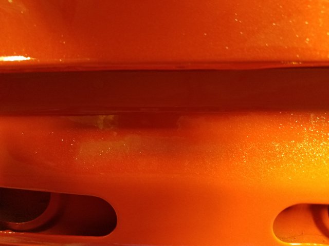

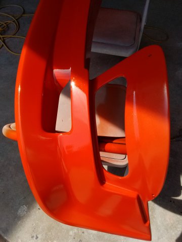

The wife is making all the decisions on body and paint for this car. She wanted orange base with micro fine metal flake .004 in the base not the clear. When the clear is applied the base has just flashed and the flake comes through in various amounts so some looks like orange and some metal. Then the car was set in the sun foe a few weeks. Brought back in the shop went over with 600 grit wet then re cleared with mandarin candy. I have not been able to capture the effects at all with a camera yet. So here are a few pics that show a little.
That looks like a very professional paint job. Candy is very hard to do people do not realize how steady and consistent your coats need to be.
