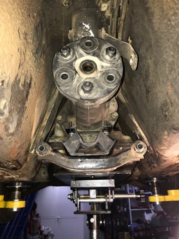

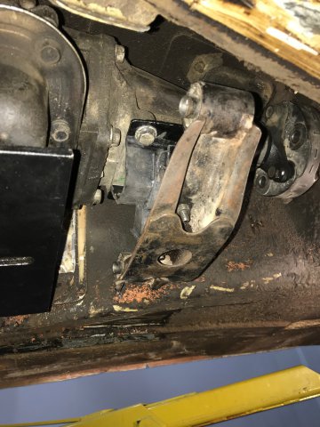

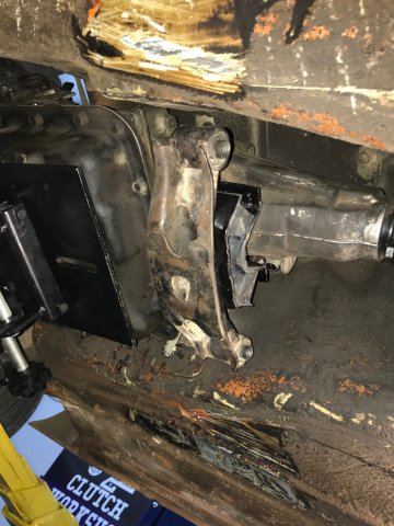

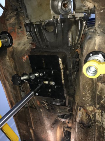

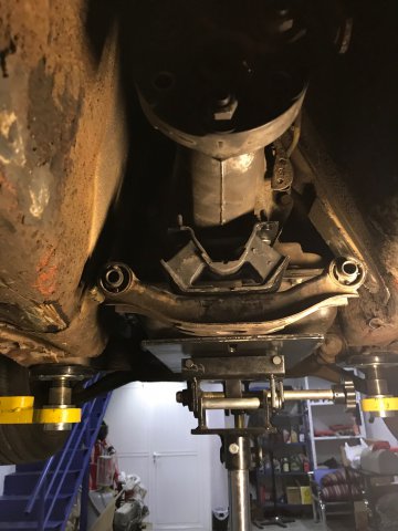

  1. Alright guys, cxracing engine mounts, LS1 + 4L60e I modified the 4 speed 240z transmission cross member (drilled two holes) for the stock 4L60e mount to sit in. Now the most important question: How should I fabricate the cross-member mounting point to the frame/body? MY Ideal: replicate the stock 240z tansmission mount brace (weld peaces of metal to the trans tunnel to support it and fabricate two ears on each side for the cross member to mount to. CONCERN is: the trans tunnel wont be able to support the extra weight of the 4l60 (about 88 extra lbs from the 4 speed). Then I can add a reinforcement from the frame rail. Note: I can not use the already supported part of the trans tunnel because of the taller/ different position of the trans mounting points. Advise please. Ideas are welcome ATTACHED PICTURES.
