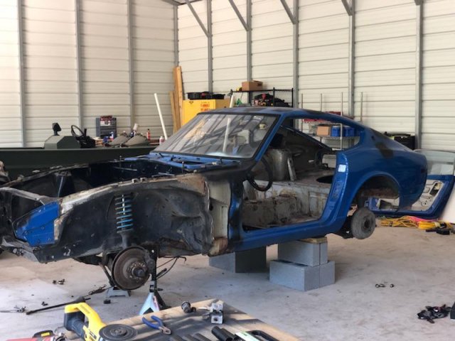

It has been far too long since I've posted anything new on here but the build is moving but slowly, got back from deployment and had a ton going on. So I'll post up all the pics and progress I currently have. I completed the refreshing of my r200 diff to find out that it was an r180, so I made a trade to a guy in town that owns a massive amount of z's and parts. The r200 is almost complete now along with getting the stubs welded to my caveman adapters for my 300zx axle conversion. Also I completely restored my 3 smaller gauges to like new condition and I am working on the speedo and tach. I did a full write up over in the interior faq section so if you have any questions go take a look. Also, I've completed the disassembly of the 5.3 which had dropped a lifter. I purchased 243 ls6 heads for 50 bucks and have new valve train to go in them and they will be off to the machine shop in the next few months. The engine block will be after that which will be getting bored to 5.7l and new components. Welding on the project starts shortly as I'm currently completing mods to my shop. And funds are low due to the new baby. -

So got some more stuff done today. Gonna start sanding the hood tomorrow I decided I'm going to keep the cowl hood. So time to fix the fiberglass areas. I was in harbor freight today and the sandblasting cabinet I wanted had the wrong sticker on it. So instead of 179 i got it for 119 plus 20% off that. Score!! -

So I got a decent bit of stuff done today. Cleaned the front hubs, cut the dust shields painted both, got my front and rear control arms buttoned up. Here are some pics. My hubs were terrible -

Looking for advice before I buy new wheel studs. I am replacing all 16 of my studs during the resto. Should I go with the OEM length or should I purchase the extended ones. Need a answer pretty soon as I am almost done with the front suspension. I will be postings a bunch more pictures in the next couple of days. I ended up taking my rear stuff to a local machine shop and they got the spindle pins and all the bushings out for 40 bucks so I am happy. -

So I took a sawzaw to the first pin. It's almost like it's welded in the strut tower piece. So I'mma get some heat on it and try to get it expanded a little and punch it out. Any tips on those bushings? -

Track I tried to use my press but I can't get it level so it isn't really working. I only have a small 12ton manual press. Would it be worth buying the tool for 60 bucks? -

Yessir the pin is out. And I have been putting penetrating oil on it for about 3 days or so. And yeah the mount kinda blew my mind as to why haha. -

Alright guys I have two questions I've done alot of research on the spindle pin, mine will not budge an inch even with a hammer, how should I get them out.. Second on this diff/suspension mount have y'all ever seen them wrapped before like in the pic. -
