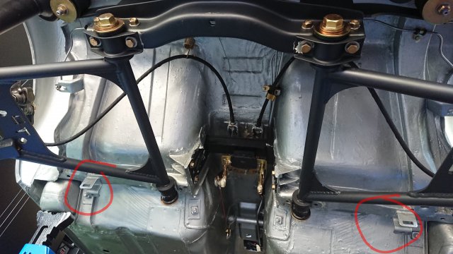

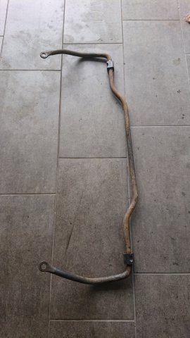

  1. Hello together, thanks a lot for your help! I've actually updated to the MSA bar which fits perfectly in my Original mounting points. Regards, Bastian
  2. Hello together, I'm actually searching for a Performance rear sway bar that fits into the stock mounts of my 260z. See my added pictures of the original bar and the mounts on the chassis...the bar went to the front of the diff. Does anybody have a hint for me where I could find a right one? Thanks a lot! Kind Regards from Germany, Bastian
