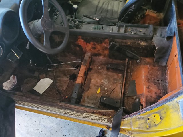

	Yeah dont get me wrong this one has a few spots that need repair. I'll need to do a little metal replacement, but it much better than the old one. And just as I say this the car cover gets blown off and it gets rained on, lol. Looks like I got some drying to do tomorrow, sigh. The floor was horribly lap welded back together so I'm thinking I'm going to replace that, I'll get some interior pictures soon.

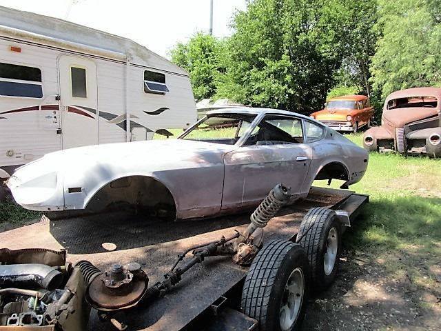

	So I think I found just a shell in Southern TX that just needs floors. That I'm OK with so will update when I find out more. Asking $1800 and includes an RB26 motor.

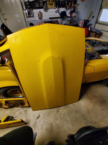

	Yeah as frustrating as it is, I think I might have to go that route. I though about even just replacing the hood and rebuilding the supports but there are so many other areas that need extensive work, I just can't see making it happen. If I had more confidence in my ability to rebuild that whole section maybe it would be a different story.

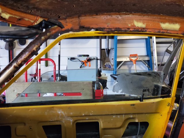

	@rturbo 930 yeah I'm going to finish tearing it down, and maybe use this as practive doing patch panel work in other areas. Then depending what else I find maybe I have just pay a professional to fix the roof and supports, cause it definitely expends over to the A Pillar.
	@Neverdone I do have a welder (MIG and TIG) and while I don't have experience forming sheet metal I'm more than willing to give it a try and learn. My main concern came in when it comes to replacing stressed structural members like that. @JMortensen well good to know there is maybe some hope. Most of the problem seems to be on the internal panel, moving forward toward the A pillar.

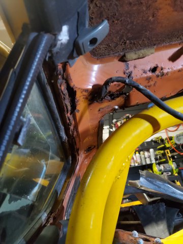

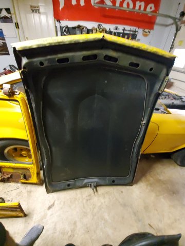

	SO pulled out more some panels and trim and found this!! Concerned this is a more than repairable section since it is part of the main support, any comments?

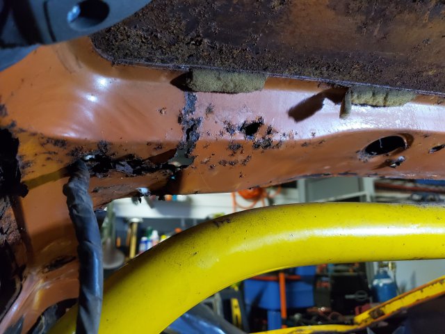

	As I pulled out the interior trim I noticed that the roof rear support had some major rust at the corners, is this a repairable spot or is it more of a hassle than it's worth considering I'm just starting this project and have other major areas of rust to contend with? This is a 71' 240z that I picked up at an auction in the hopes of a resto-mod project.

	So I'm really going back and forth about putting it on a rotisserie and doing it all myself (I have basic welding ability and own a TOG, MIG , and Plasma cutter) and sending over to a body shop to have them do the sheetmetal work. Right now I'm probably look at new floors, rockers, and rear deck sill (and the hard to find part underneath it). Have a lead on a used rotisserie local that I could pick up. Any advice one way or the other? I'm gather all the books, YouTube videos, and forum posts I can on rust repair and sheetmetal fabrication, but haven't actually DONE any yet, lol.

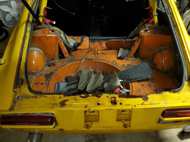

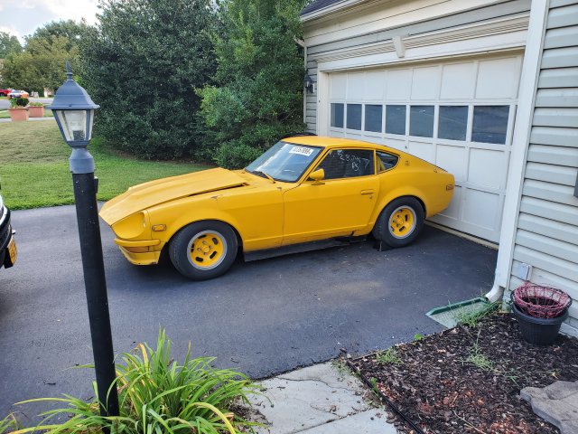

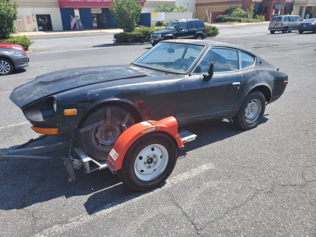

	Welp here we go down the rabbit hole! So I purchased this bright yellow 1971 240Z, sight unseen (yeah I know) from a Copart auction, hoping for the best but prepping for the worst. The plan was to take it all the way down to the shell, do any body repair required and like a phoenix from the ashes, bring something special out of it. So I had a 331 with aluminum heads and Edelbrock intake setup for EFI I had built out from a previous project (Locost 7 that never came to be) that is still wrapped in plastic and waiting a home. I want to put a full Apex Engineered suspension in it, as some other neat features as we go along, but first thing first, we have to get it apart. From when I rolled her off the truck I could already see the rusted floor pans, the aircraft turbo charger someone mated to the SU carb, the hugh speak box in the back and the yellow. .. .everywhere. The trunk was rusted shut and so I have my work set out for me. Finally got the trunk open after a day or two and the expected hatch sill damage was there, in addition to a good port of the hatch itself being rusted away
