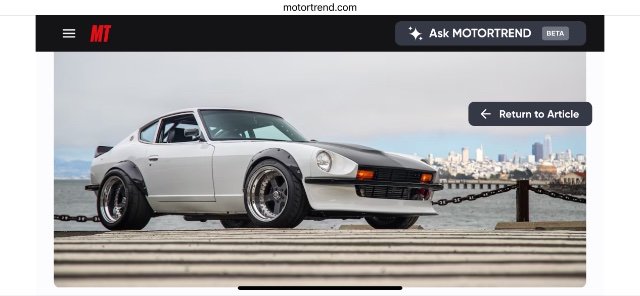

  2. Thanks for that response . I know you are right about most dams needing slight mods to fit but the ones I have bought just cannot be altered to match the missing metal I took out of the fenders. Skillard has a whole dam and splitter combo that might work but its $750 before mod and paint. Here’s what I am after….. plus I have the 3 piece stock valance to work with if need be.
  3. At the end of four year restomod on 77 S30….did not expect this problem. I cant seem to find the right air dam for the front that will work with my 2 inch cut fenders and ZG flares and wider wheels. Have ordered 3 different ones from Motorsport Auto and the Z Store and none of them match up because of the modified wheel wells. Anybody else have this issue and a suggestion on which dam will work with my setup? I kept the turn signals in the grill as stock. Cheers all
