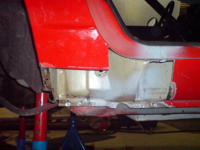

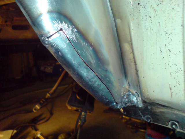

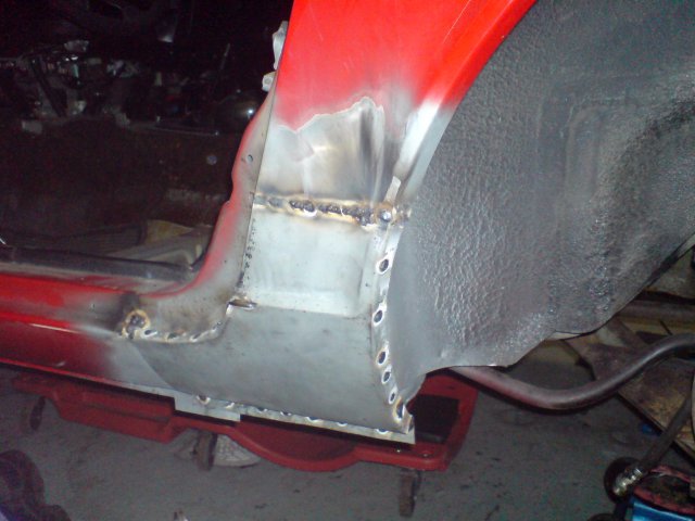

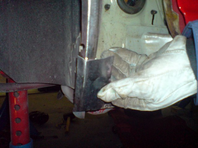

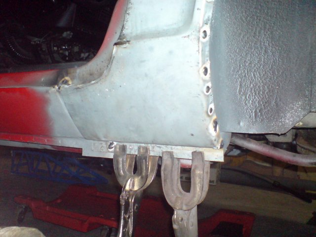

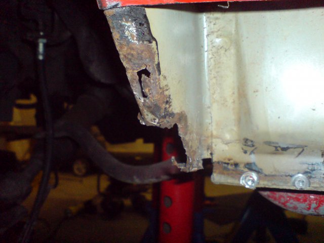

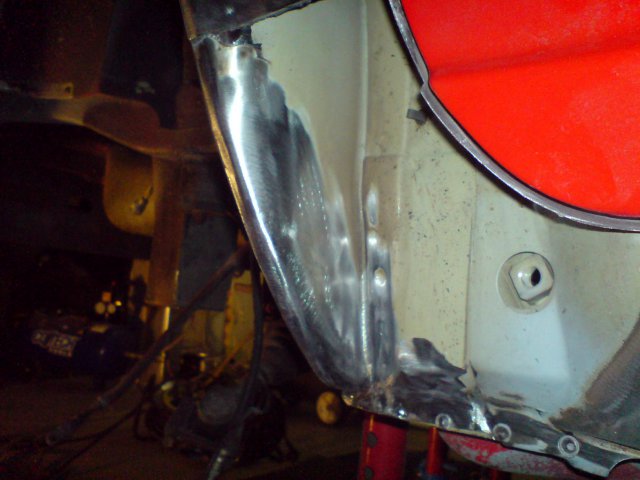

  1. More pictures of rear rocker fix. Wheelarch: spot weld a piece that is just a little too large, then cut both the new and the old in one cut to get it perfect before welding, same trick with the new TABCO parts, spot weld and cut together with the original material. Best regards ESS
