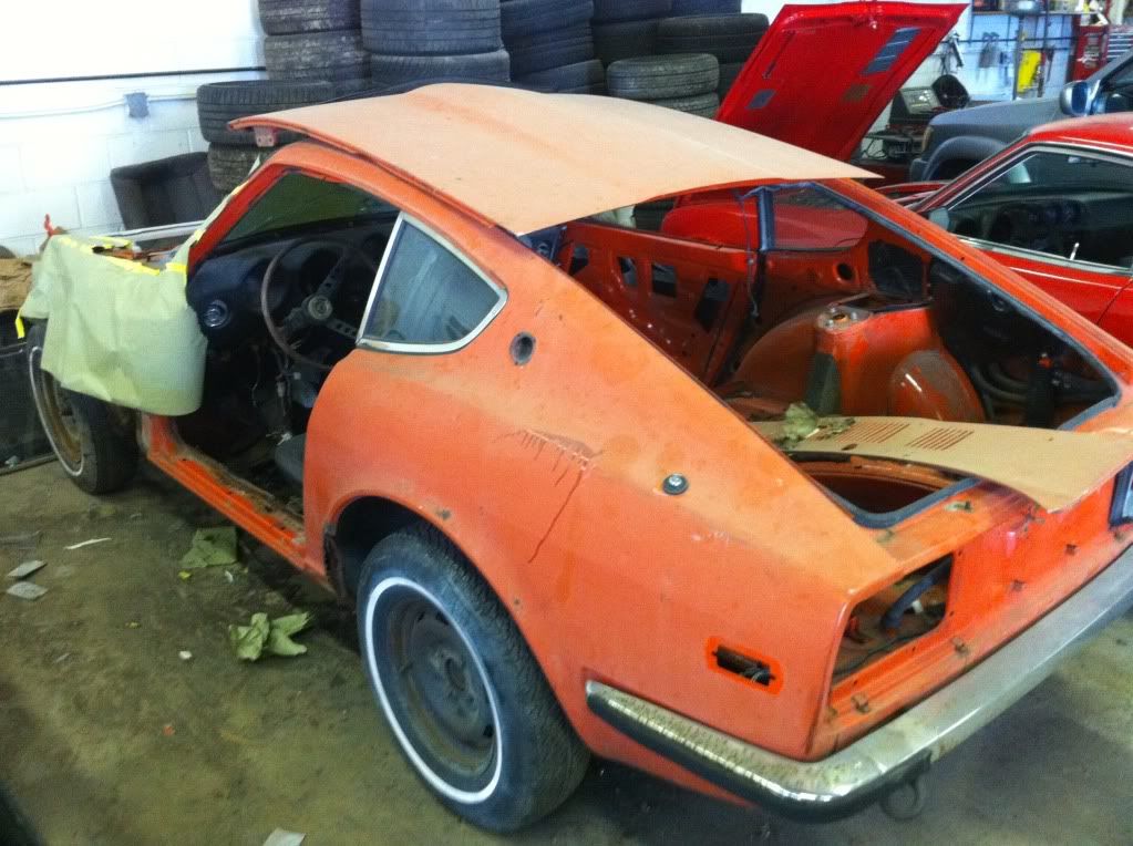

The Looker (now parts car):

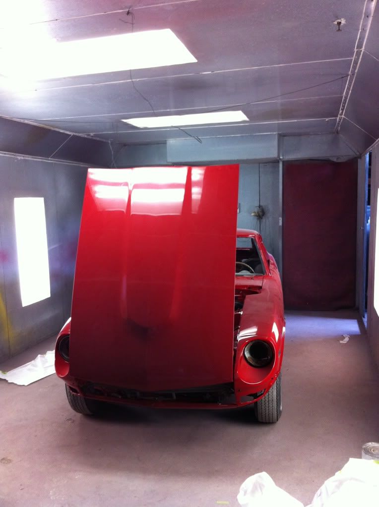

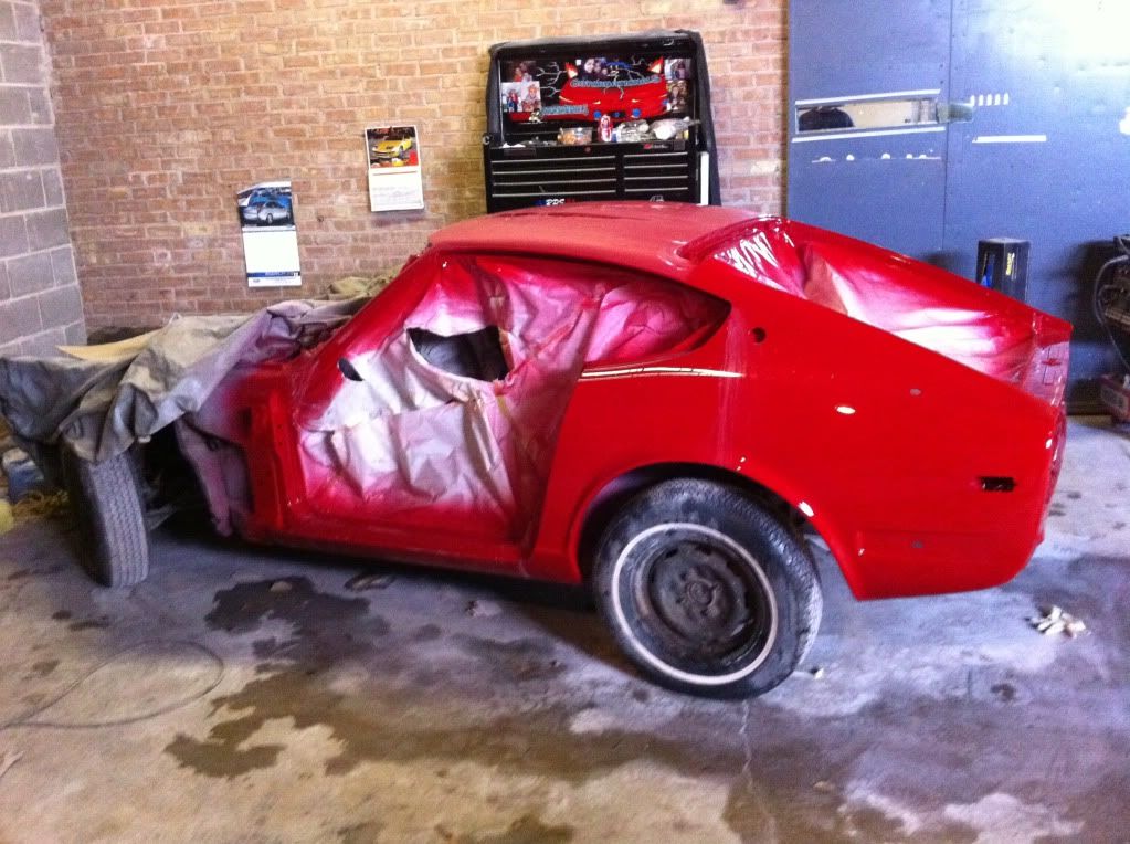

Decided to have it painted Nissan Solid Red A54 from the new 370Z - modern color I can duplicate with ease, and keeps it in the proverbial family.

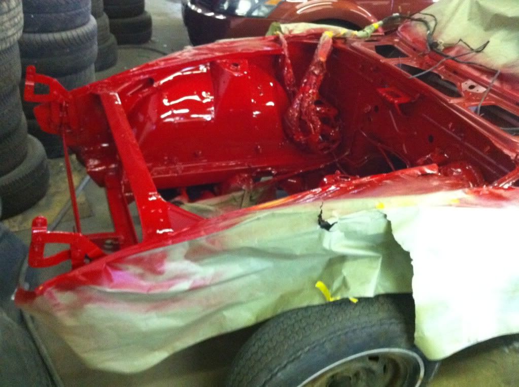

Engine bay painted:

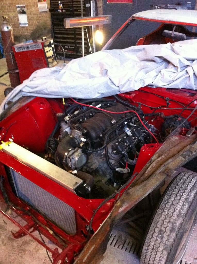

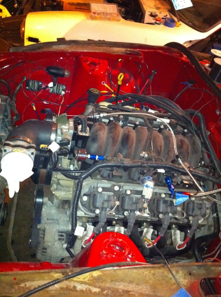

Engine and trans in place, still not hooked up:

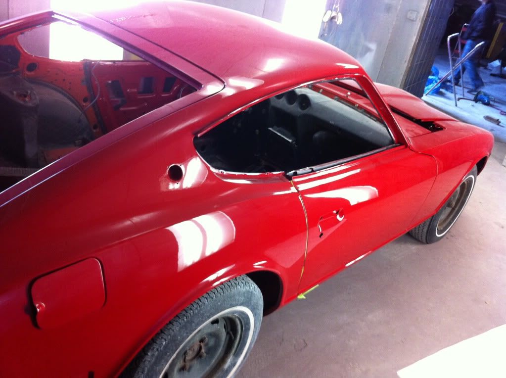

Body work finishing:

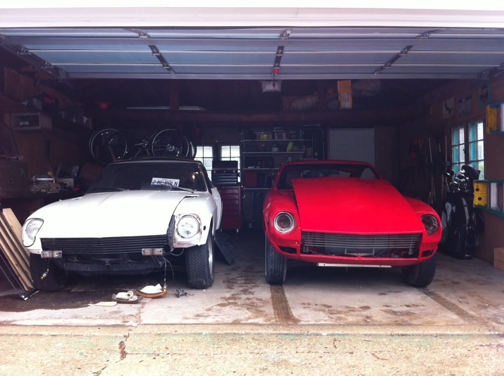

Which brings me to this last Sunday, May 15:

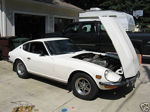

As you can see, the white Z has had to make some sacrifices along the way, mainly a nose job, loss of a driver door, and the rear hatch.

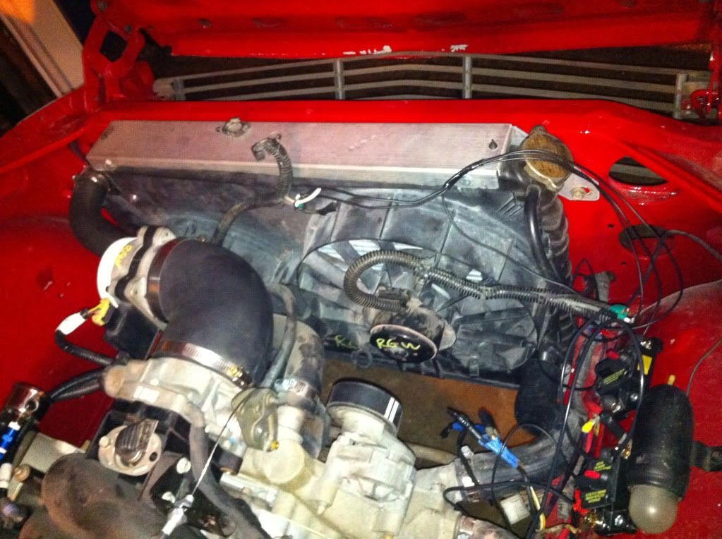

Got the stock LS1 fan shroud trimmed and mounted:

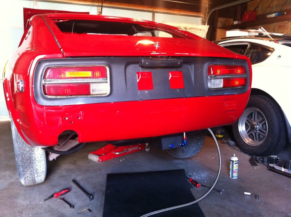

Got my fueling routed and installed.

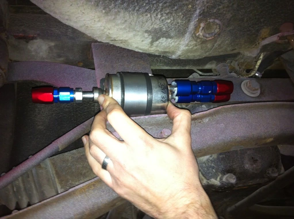

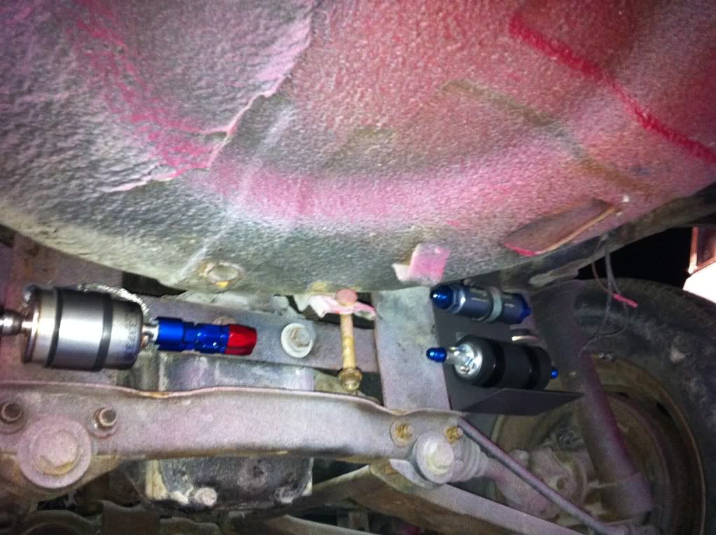

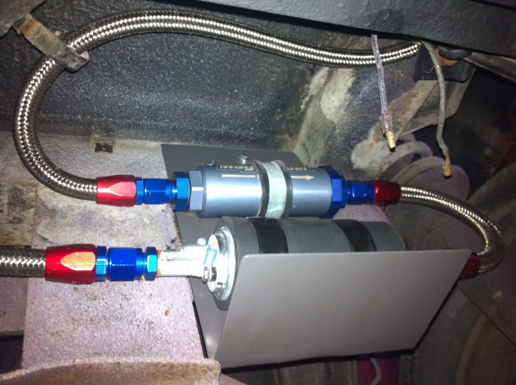

Running -6AN from the sump to a pre-filter, filter to walbro exterior, walbro to corvette FPR, and FPR to rails, with return to either a pick up or vent tube on the tank.
The filter and pump on the right, FPR on the left.
Mid-plumbing process
With relay powered on, steady PSI at the rails!

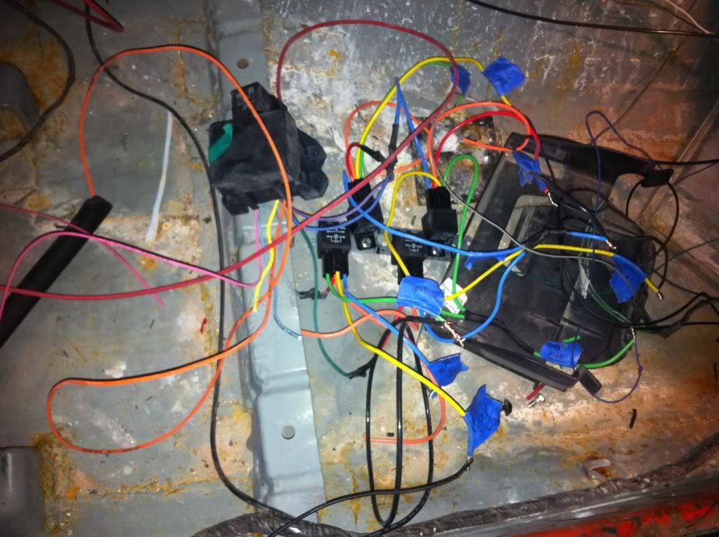

Next was finishing the wiring. Oh. My. God.

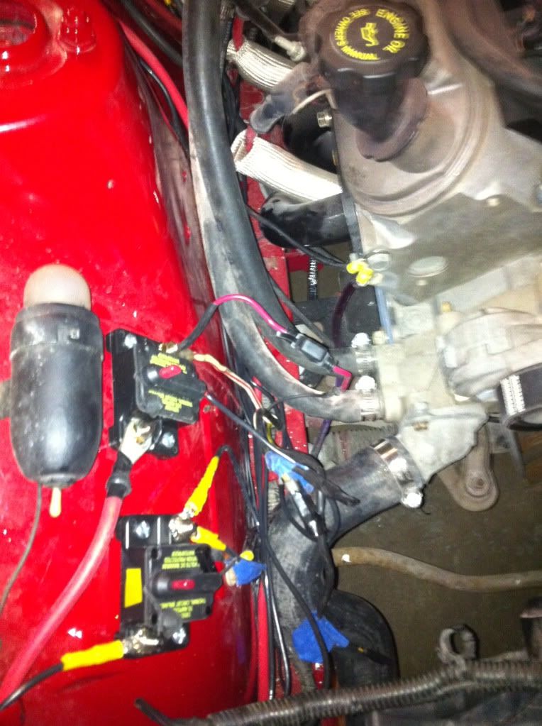

First, we elected to have two curcuit breakers, one for constant power, one for switched:
Next we had to pick apart the wires needed for the body, and the wires for the LS1, wire up fuses and relays to run the fans and fuel pump, and select a location. I chose the passenger footwell for the relays, ECM and fuse block. The rat's nest when we started:
(sadly, I haven't taken a picture since it was cleaned up, I should do that this weekend)

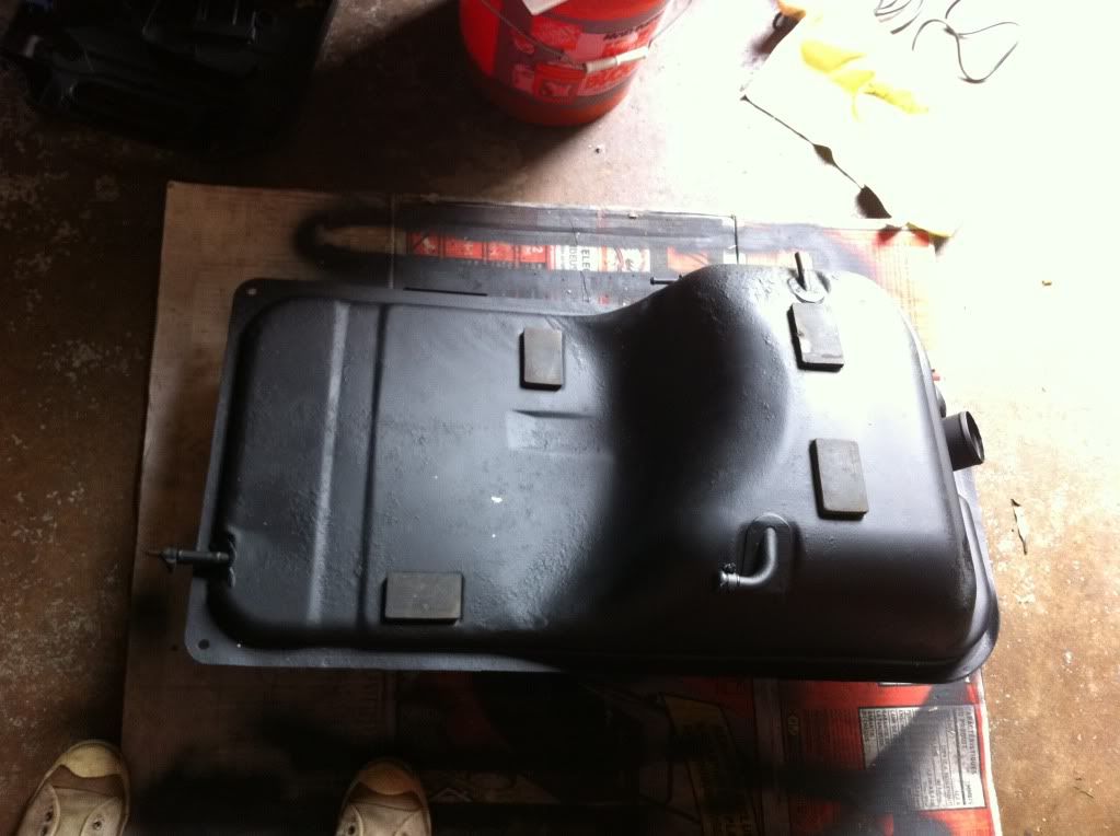

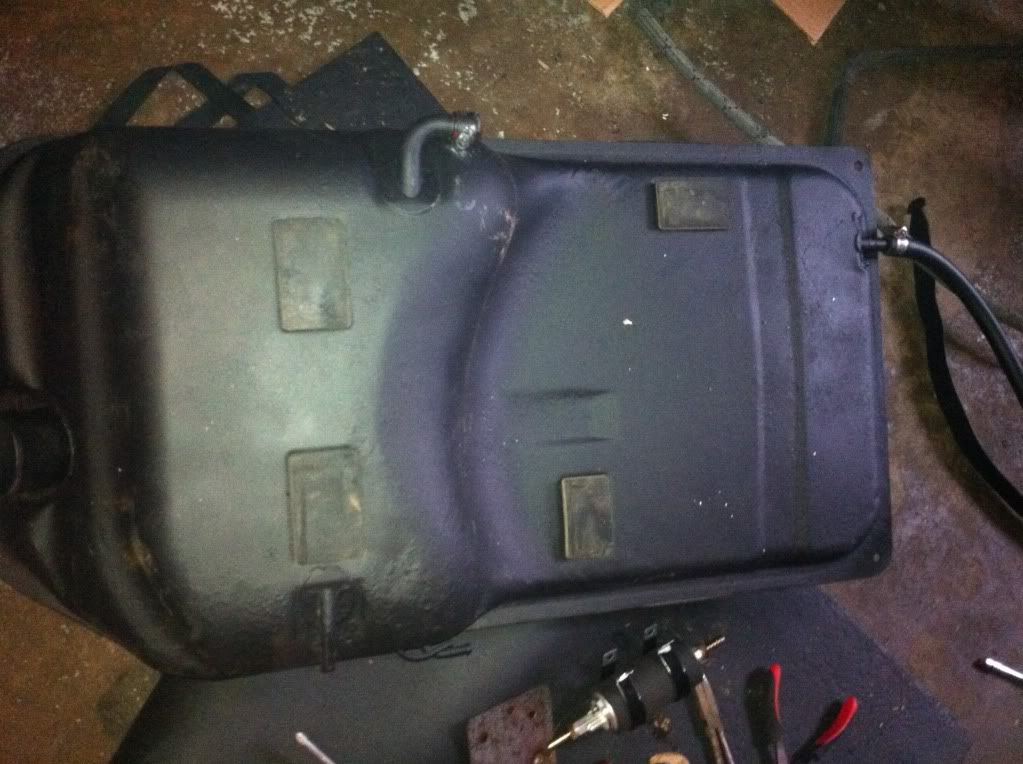

Next I dropped my tank and took it to a radiator shop to be cleaned/boiled and have the sump welded on. Again, you can do this all yourself, but I would be doubly nervous of welding a fuel tank that has ever held fuel.
It goes without saying that you want your tank to be sound, and if it is not, now is the time to do so. Mine was solid, so all they had to do was weld the sump on. Between the sump ($65) and the clean/weld job ($90), I was at $165 for a tank that should support FI. Sadly, I had them center the sump on the tank, not on where it would fall under the car, but that is just an aesthetic issue that may or may not matter to others.
Make sure when they weld the sump that they drill several holes in the tank to act as baffles - the sump came with a template, but if you are making your own or use another brand, several small holes, not one large opening, are needed to connect the sump to the tank. See here: http://www.competitionengineering.com/catalog/images/c4040-c4041_inst.pdf
Next up was finishing the tank, since in the process of cleaning and welding, they will expose most if not all of the original steel. I had to sand the tank and then hit it with 3 coats of rustoleum black paint. I will eventually get it powdercoated, but I wanted this thing on the raod before winter.
Next I had to decide how I wanted my fuel, evap and return lines to be routed. I knew that the stock hard lines would be fully taxed if not overwhelmed on an LS swap, so I chose stainless braided lines for ease of use, limited weather and time of use (3-5,000 miles per year, April to October mainly). I am sure that people would push me toward new hard lines if I let them, but I know a lot of high performance, high power and hig mileage guys using braided lines with no ill effects, and they are MUCH easier to work with IMHO.
I also chose to keep the evap canister in the passenger c pillar area, since it is rumored to make filling up easier. This meant I needed the following connections from the gas tank:
1 Outlet
1 Return
at least 1 evap line

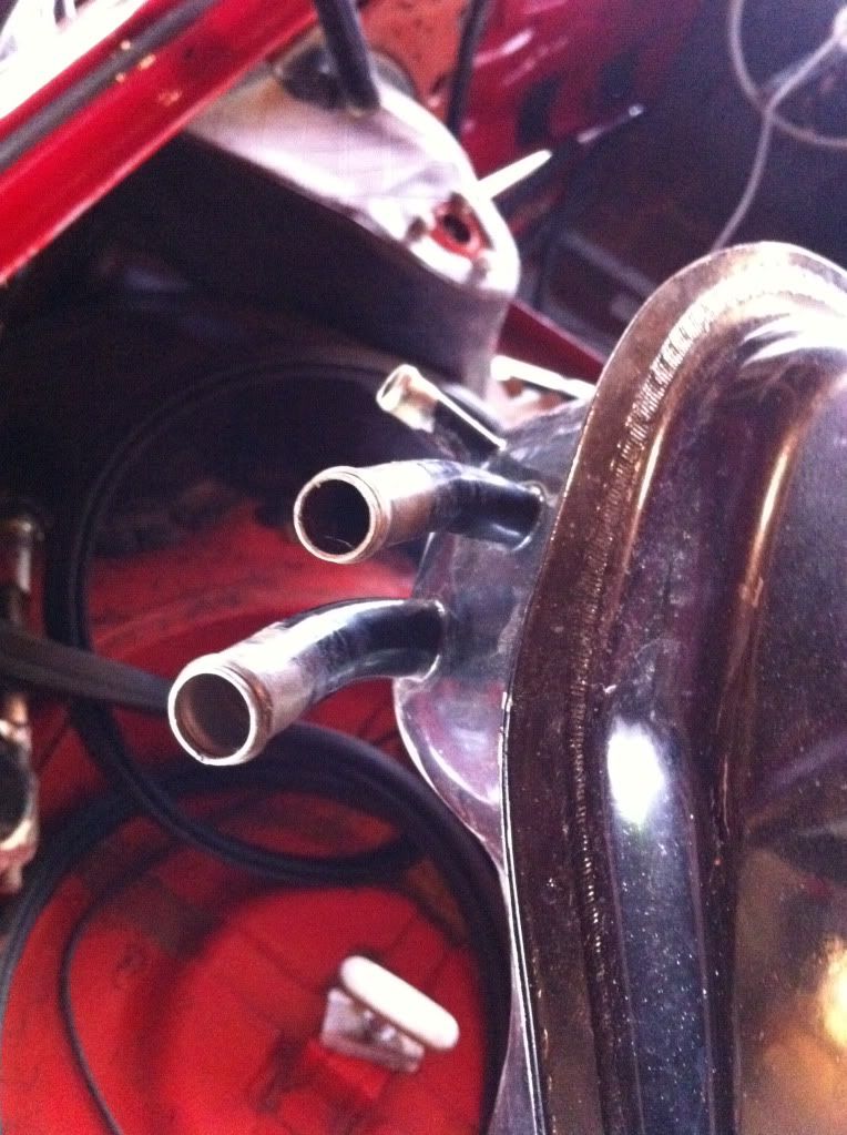

Obviously the sump will handle the outlet, but I didnt want the return line at the bottom of the tank - no reason other than my own concerns about cavitation or pressure on the system, and probably unfounded. Still, that meant chosing a return location on the upper side of the tank.
Since I was workign with -6AN lines, I figured I would use the most closely sized bung on the tank, which happened to be the topmost, passenger side evap tube line, facing the bottom in this picture.
Using this meant I had to cap the corresponding hole on the evap tank itself. JB weld and a fine mesh screen for durability worked fine.
That left me with two choices for the evap tank line, and again, I wanted the highest point I could, so I chose the highest remaining bung, the "L" shaped on the bottom of this picture.
I routed that through the existing hole and grommet in the rear to the evap tank.
Since the lower evap line was in the middle of the tank, and would therefore have fuel in it, I opted to delete that line as well and just run one evap line. Again, JB weld sealed both the gas tank bung and evap tank bung. I capped two of these three lines:
I still had two openings, the original outlet and return lines. More JB weld, and those were capped.
So now I had a tank with an outlet, an inlet and an evap line, and an evap tank with one connection to the gas tank, plus the stock connection to the filler neck. I also had an extra outlett on the sump, but a threaded plug from summit fixed that.

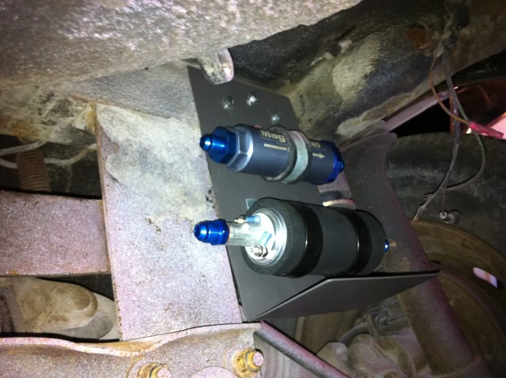

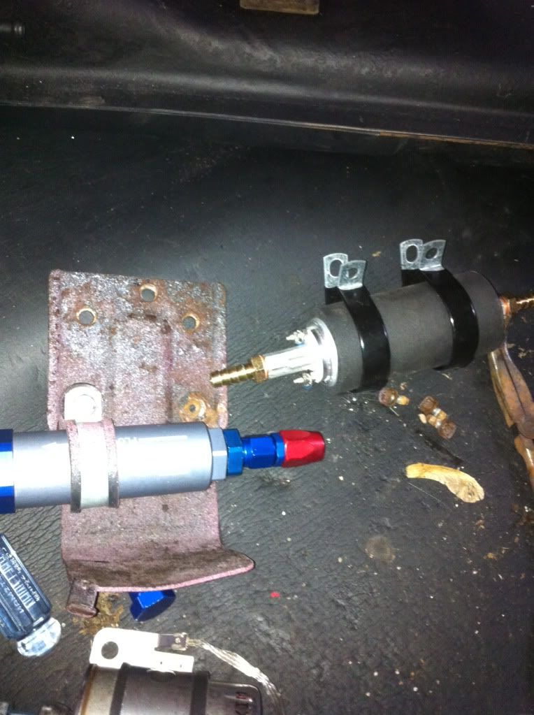

I planned out a prefilter, a walbro 255 lph in line pump, and a corvette FPR. As it happens, the 1973 model already had wiring for an external fuel pump, and while I wasn't going to reuse that wiring, that location already had a bracket that would fit my Walbro 255lph pump nicely.
However, the pump and prefilter wouldnt both fit.
So a $5 piece of steel from home depot, some cutting, bending and rustoleum yielded a bracket that fit in the stock location and fit both the filter and pump.

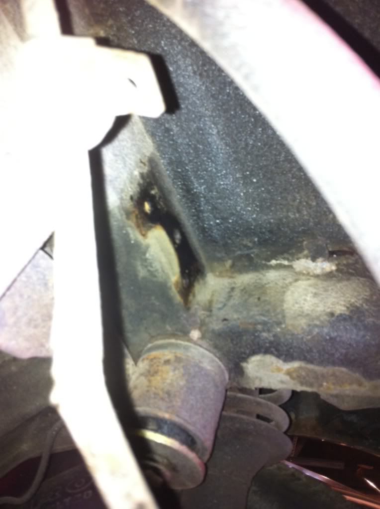

The PO of my Z had put a small hole on the support bracket for the dirver side lower control arm, which would accept the crovette FPR perfectly.

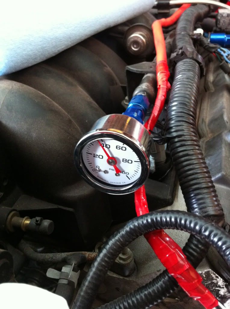

I also took time to add a pressure gauge at the head of the rails; removing the schrader valve and adding a gauge in its place.
