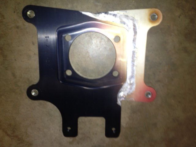

TheMission Posted April 15, 2012 Share Posted April 15, 2012 If shauns kit is the same I picked up, is '85 300zx non-turbo rotors. I've got the prototype of my attempt at the bracket completed. I've found a machininst and am going to source, cut, and drill my aluminum myself to save cost, but need the machining to spec done by him... Here's a pic of my test fit prototype. It's rough, but all that really matters is hole spacing and the machining specs of the inner and outer cuts on the bracket. It looks nifty. Quote Link to comment Share on other sites More sharing options...
RebekahsZ Posted April 16, 2012 Author Share Posted April 16, 2012 Looks super. The e brake cable will be very close to the strut tube. Make sure you completely mock up to be sure that clears. I just picked up some ceramic pads to try. The porter fields have to be warmed up to work well which hurts spontaneous use of the hand brake. It needs to work cold. I will report back. I am glad I was right-you did fine without my drawing. That pretty much looks the same. Quote Link to comment Share on other sites More sharing options...

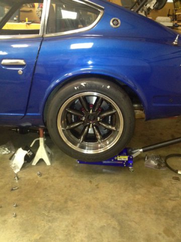

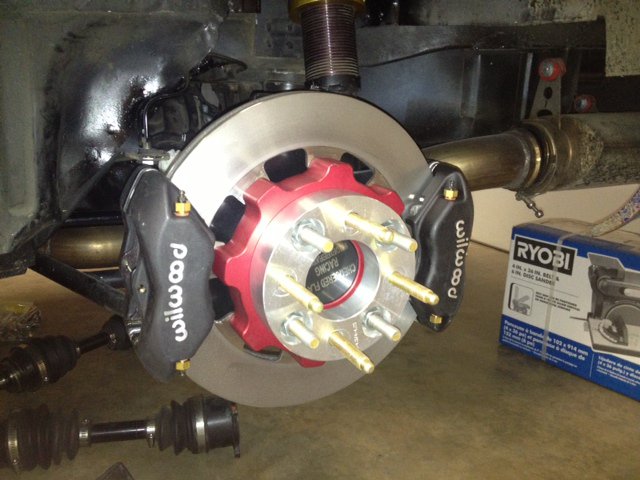

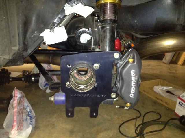

RebekahsZ Posted January 11, 2014 Author Share Posted January 11, 2014 (edited) Got tired of crappy performance of my maxima based drifting brake and decided to re-do it with AZC components. I can now lock the wheels with slicks going down a straight road at 30mph (haven't tried faster). Used Wilwood's highest friction compound pad. Going to be a chalk-block man this year and perhaps do the AZC cable parking brake next year - gotta do some other things on the car other than brakes. Edited January 11, 2014 by RebekahsZ Quote Link to comment Share on other sites More sharing options...

seattlejester Posted January 14, 2014 Share Posted January 14, 2014 That's some serious braking power! May I ask what you use it for? I thought you were more into drag racing and such, I would think a front staging brake would be more useful? Quote Link to comment Share on other sites More sharing options...
RebekahsZ Posted January 14, 2014 Author Share Posted January 14, 2014 I'm more into everything. I use it for holding my position on a hill at a stop sign or my driveway and loading on a trailer. I use it when bumping up to the second staging light at the strip. Now that it actually works, I may use it for some parking lot horseplay. I use a solenoid for locking the fronts for burnout. Quote Link to comment Share on other sites More sharing options...
