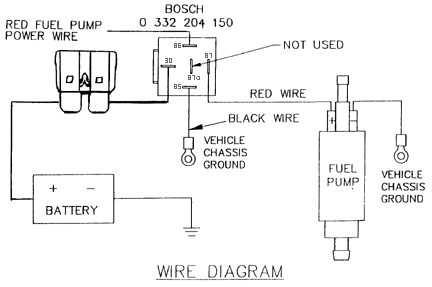

stwrangler Posted October 24, 2011 Share Posted October 24, 2011 (edited) I tried the search and didnt find anything helpful. this a 78 280Z, SBC , carburated.. I used the stock wire to run a holley fuel pump. Got home turned the car off and the fuel pump stayed on. I have it down to this, if I unhook the charge wire from the alternator the pump turns off ( all other wires are unhooked from the alternator ), if I hook the charge wire straight to the battery the pump come on. any ideas ? Edited October 24, 2011 by stwrangler Quote Link to comment Share on other sites More sharing options...
David GArcia Posted October 24, 2011 Share Posted October 24, 2011 Check your wiring. You must have wired in the fuel pump to run at all time. If you just want to add a kill switch and turn it on manually that is also an option. I suggest you wire it into a hot when engine on wire. Quote Link to comment Share on other sites More sharing options...
stwrangler Posted October 24, 2011 Author Share Posted October 24, 2011 its been good for 2 years, this is the secound motor in this car.Im hoping to find out what the problem is, if for no other reason then to know what broke. I'll most likly wire it to come on with my primary fan. Quote Link to comment Share on other sites More sharing options...
NewZed Posted October 24, 2011 Share Posted October 24, 2011 I found this link a while ago that explained a scenario like yours. Might be worth reading - http://atlanticz.ca/zclub/techtips/fuelpump/moreinfo.htm Quote Link to comment Share on other sites More sharing options...
stwrangler Posted October 24, 2011 Author Share Posted October 24, 2011 Thank you NewZed that sounds like my gremlin., Quote Link to comment Share on other sites More sharing options...
