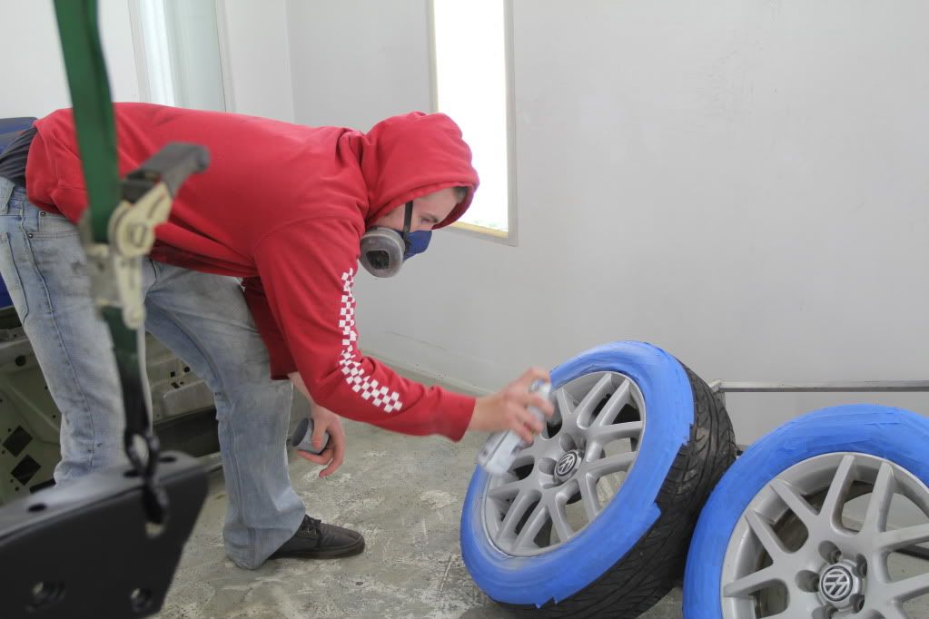

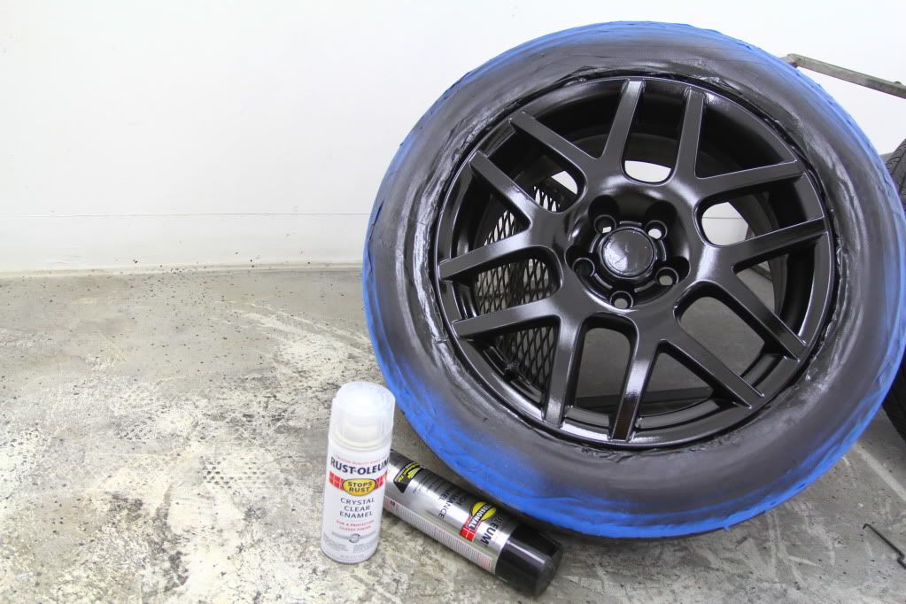

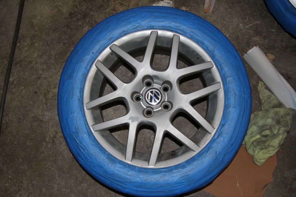

Took wheels off, taped everything off.
used a high grit sand paper to take off everything and remove blemishes.

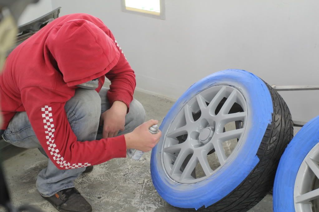

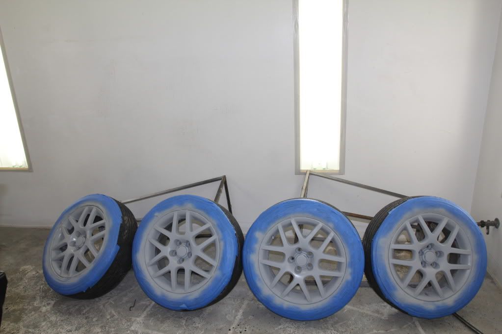

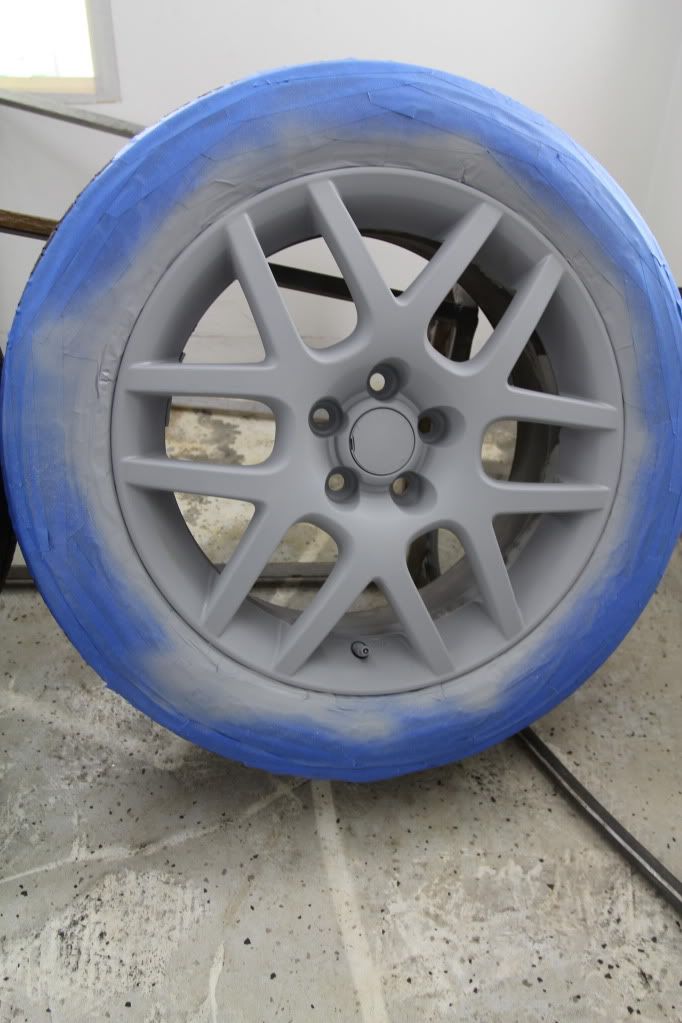

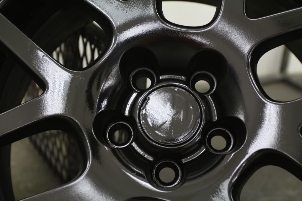

primered a few coats, sanded each coat smooth.

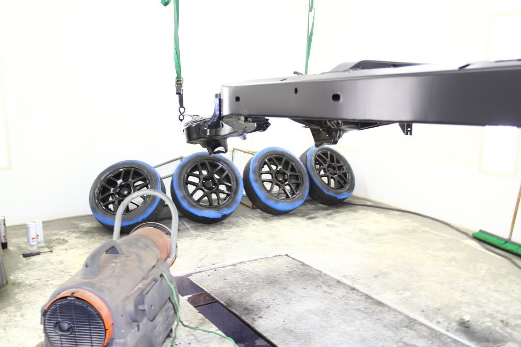

2 coats of black
some clear coat later
done in a fully heated vented paint room, set at about 90 degrees. Was super nice compared to the outside 40 degree and raining weather.

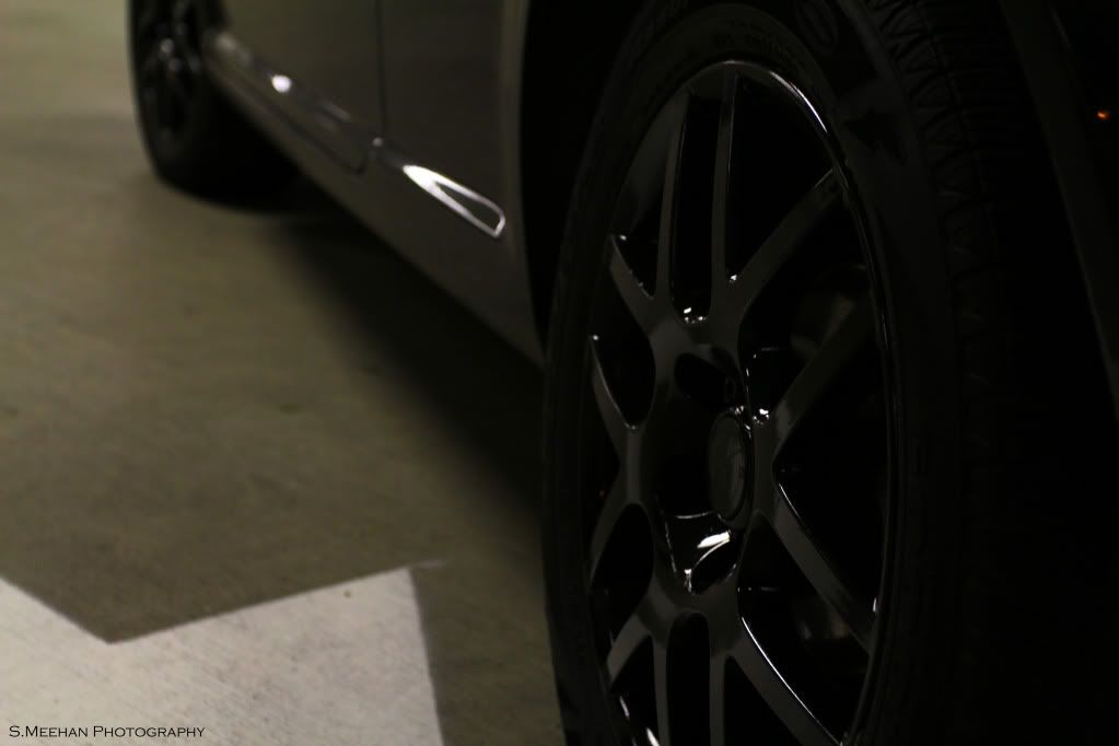

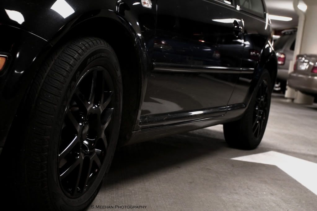

Final product
