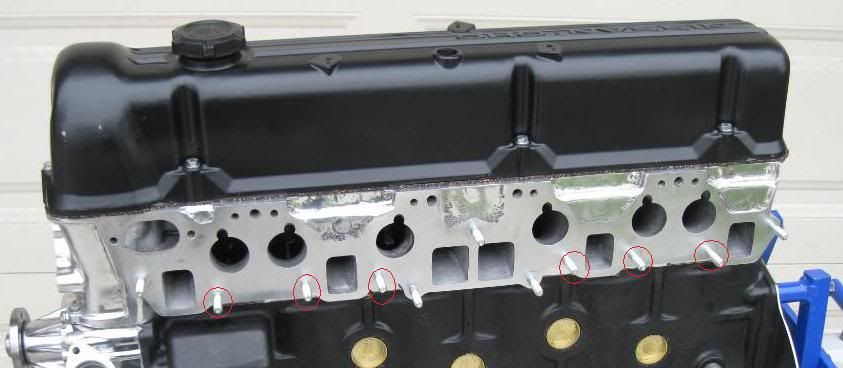

JSM Posted March 12, 2012 Share Posted March 12, 2012 (edited) First, your pics are not showing up. Second there are nuts on studs that hold the bottom of the intake manifold on as well as hold the header on. I would secure it first with all the nuts and then see how it runs. EDIT: If memory serves me correctly the red circles share holding the intake on: Edited March 12, 2012 by JSM Quote Link to comment Share on other sites More sharing options...

NewZed Posted March 12, 2012 Share Posted March 12, 2012 The intake manifold isn't leaking gas, the carburetor or the fuel lines to it are. JSM's circles are in the right spots. There is a thick washer-shaped curved piece that goes over those studs to span the gap to the intake manifold and clamp it on the edges. The studs apply clamping force to both the intake manifold and exhaust manifold (header flange in your case). There's no reason for your clutch linkage to increase engine speed unless the pedal is rubbing on the throttle linkage. The PO might have run a cable linkage to your carburetor and the clutch pedal is pressing on it. Also, check the carpet down by your feet. Quote Link to comment Share on other sites More sharing options...

NewZed Posted March 13, 2012 Share Posted March 13, 2012 Follow the flow path of the gasoline from the filter through the lines to where ever it ends. It doesn't flow through the intake manifold. You're missing the clamping washers. Each stud or bolt holds between the intake and exhaust splits its clamping force between them. It's probably not idling because you have a huge intake manifold vacuum leak. You have quite a bit of work to do to get things right. If you've been trying to run it with the gas leak and the vacuum leak, you're on the edge of an engine fire. Lean backfires and gas fumes are a bad blend. The pictures are better, at least they are equally gigantic. Good luck. Quote Link to comment Share on other sites More sharing options...

randy 77zt Posted March 13, 2012 Share Posted March 13, 2012 On the original z engine the intake and exhaust manifold flanges are close to the same thickness.when you bolted it to the cylinder head they were then clamped with the same pressure under the bolts with the shared thick washers.this is why aftermarket header gaskits are hard to seal on a z.the intake and exhaust manifolds must be the same thickness-this can be corrected by machining .get the original mounting washers-try courtesy nissan.holley carbs can be made to work but its probably jetted rich and the power valves are probably blown.my pic wiould be a set of z therapy su carbs with oem nissan manifolds. Quote Link to comment Share on other sites More sharing options...
NewZed Posted March 13, 2012 Share Posted March 13, 2012 Here's what they look like - http://www.thezstore.com/page/TZS/PROD/14037N36 Don't know why MSA calls them "spacers", maybe because they span the space between the manifolds. Even the pros are confused. Quote Link to comment Share on other sites More sharing options...
beermanpete Posted March 13, 2012 Share Posted March 13, 2012 It's not the original pump. And the gasket came like that and for some reason shifted to that position when the exhaust manifold was put on. It won't move to the correct postition. I'm not driving it at all since I found out the gas was leaking. The gasket is installed correctly. The intake manifold shares mounting hardware with the exhaust manifold. There are several studs that are common to both manifolds. These studs do not pass through a hole in either manifold, they are between a port on each. A very thick, large diameter washers spans the gap between the two manifolds and a nut is placed over the washer to tighten it down. It appears that you are missing some of this hardware, or it is not installed properly. Your fuel pump may be correct, but you should measure the fuel pressure anyhow to verify what is it. Even a fuel pump designed for use with carburetors can be intended to be used in conjunction with a pressure regulator. If the pressure at the inlet to the carb is more than 4 or 5 PSI if could force the float valve open, or at least raise the fuel level required to close it. Either way the result is the same, flooding. Since you say there is no fuel leaking on the outside of the carb then it must be leaking inside which will happen when the fuel pressure is too high, of if the float valve or float itself fails. In the case of the Holley, the power valve can also cause internal flooding, as has already been said. Quote Link to comment Share on other sites More sharing options...
