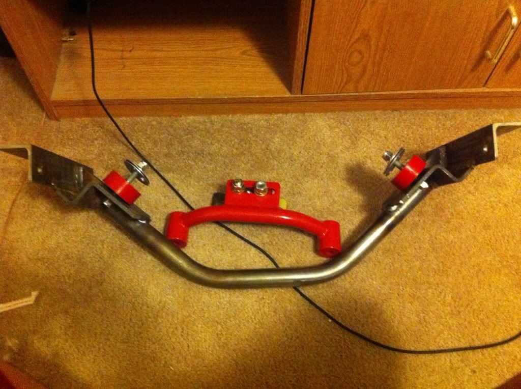

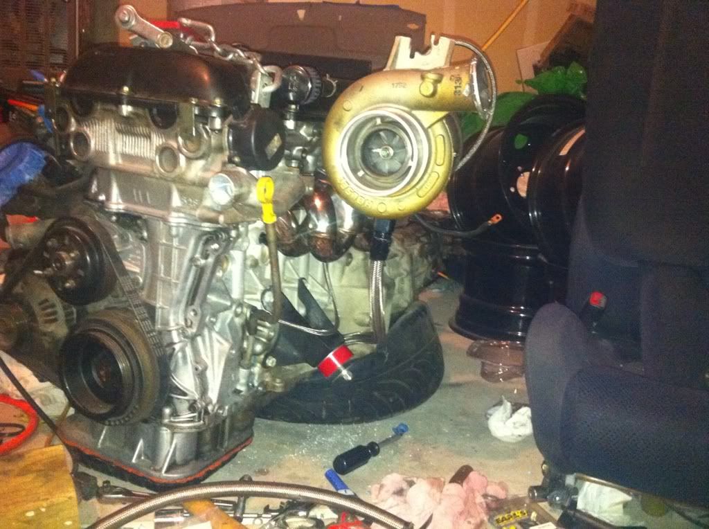

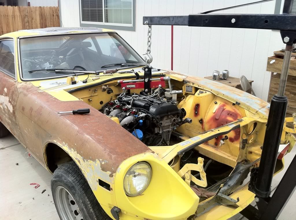

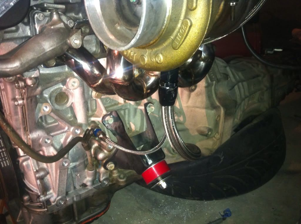

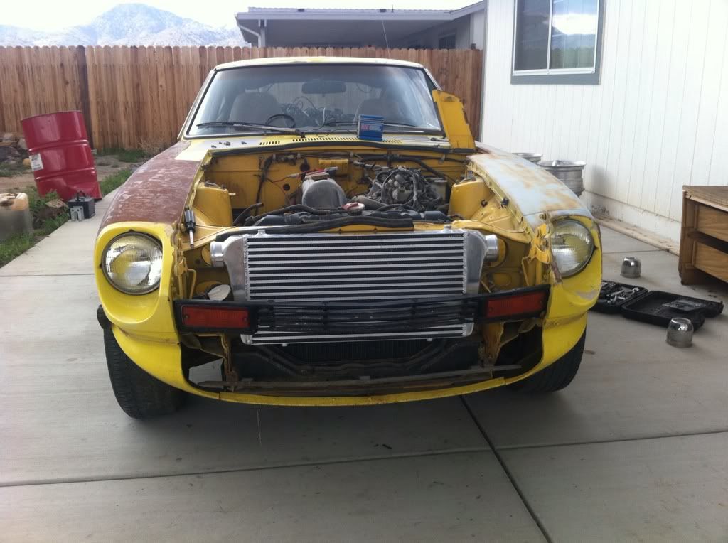

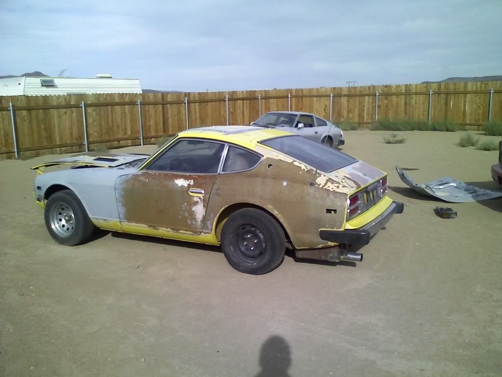

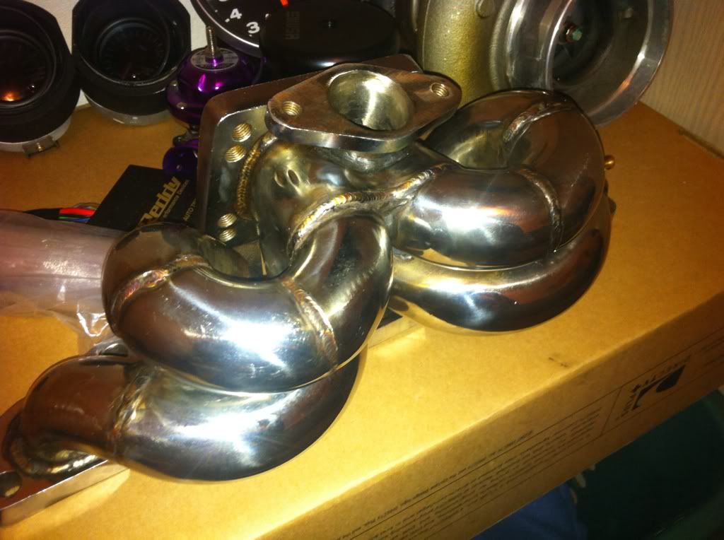

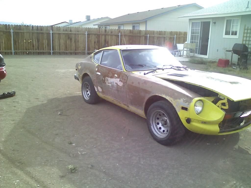

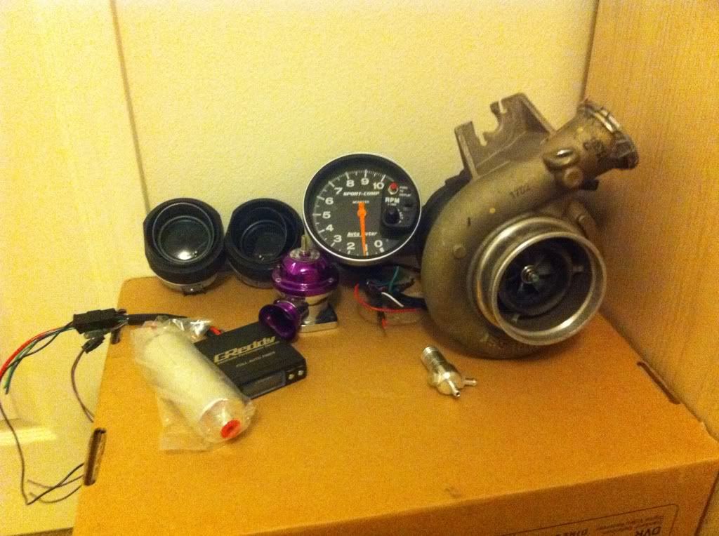

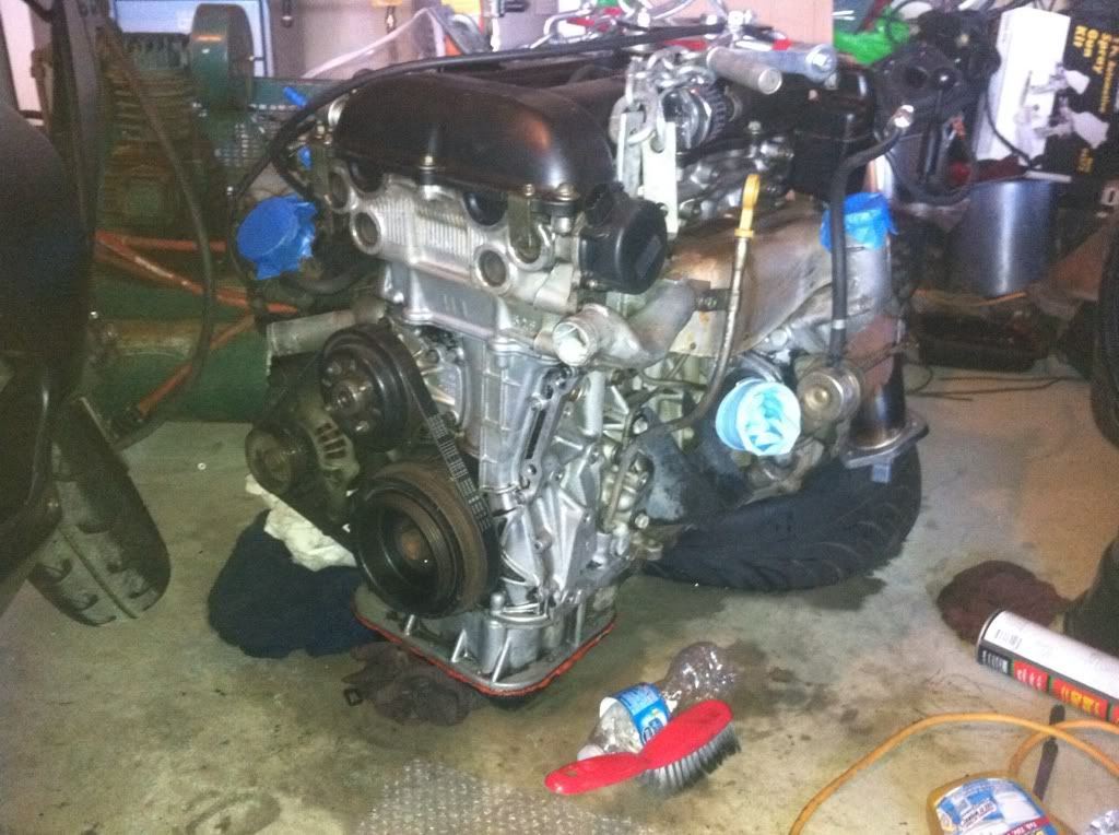

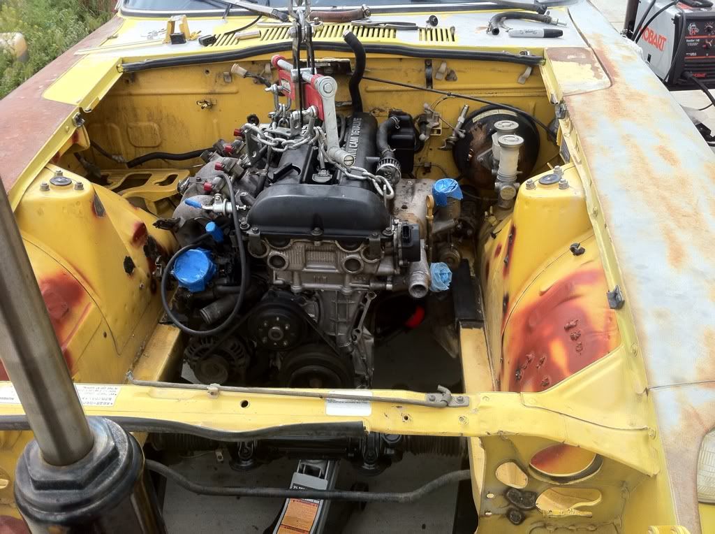

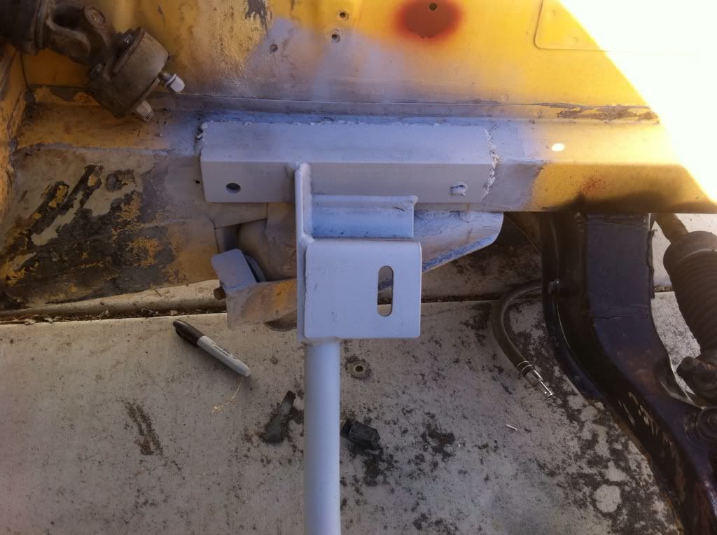

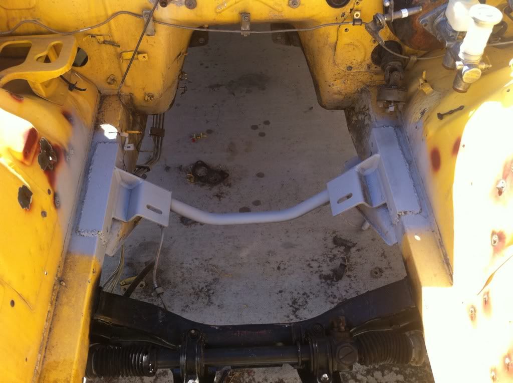

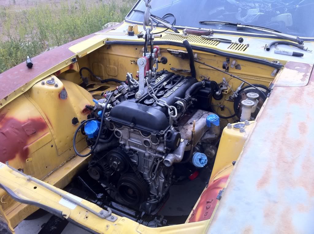

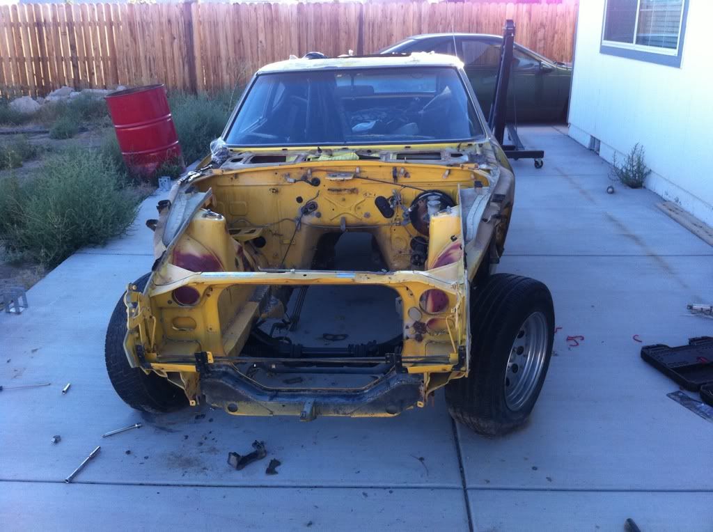

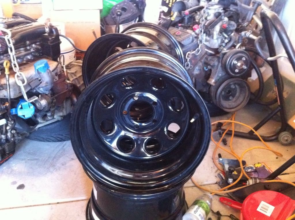

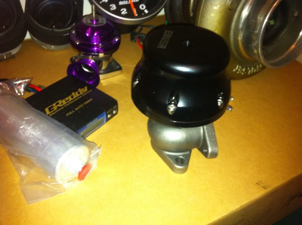

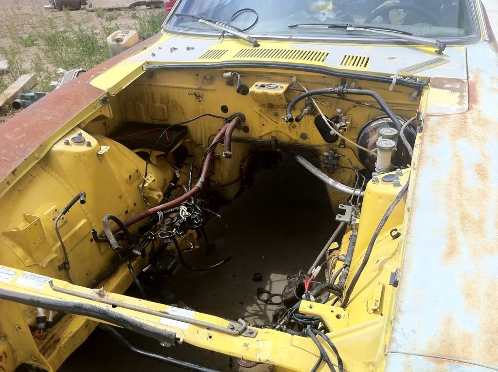

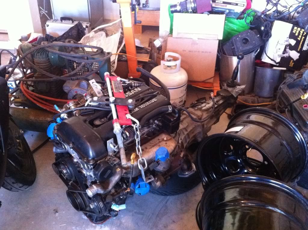

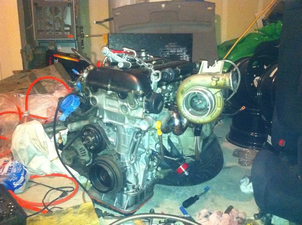

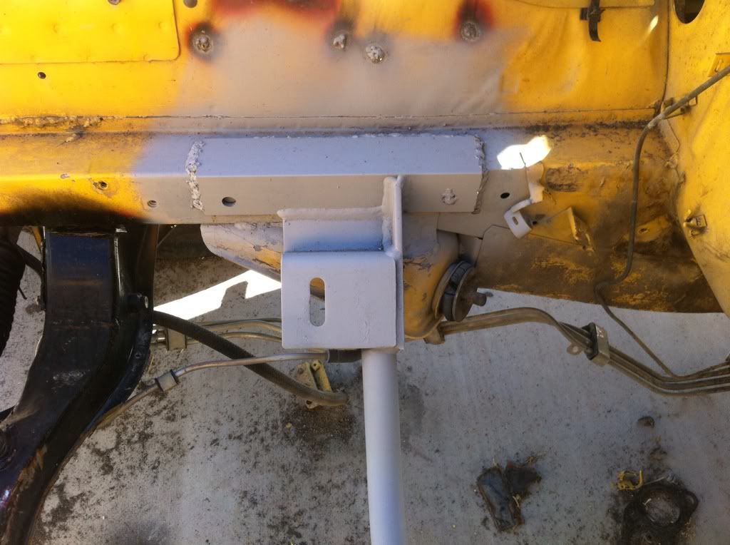

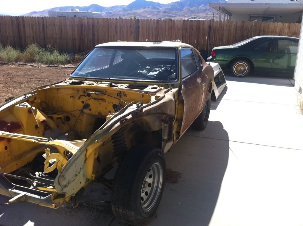

Nv_s30 Posted March 27, 2012 Share Posted March 27, 2012 Ive had my 77' 280z for almost 4 years but just started working on it. I decided to do a blacktop sr20det swap with a Holset hy35 running 15psi for daily driver. When I started to do work on it Here are some pics of me starting most of the work and parts I have I am missing some pics I'll be doing updates soon tho. Test fitting the motor before I weld in the mounts. My brother welding in the mounts How the car sits just moved so now it's in my garage Some parts I have. I have many more just no pics of them lol Motor before new turbo And new turbo how it sits Will update soon sorry for so many pics on the first post ha Quote Link to comment Share on other sites More sharing options...
cockerstar Posted March 27, 2012 Share Posted March 27, 2012 Looks like you're making some pretty good progress! I would seriously consider having someone with some more experience look at those welds on the engine mounts though. They don't have any kind of penetration and are very weak. Quote Link to comment Share on other sites More sharing options...
Nv_s30 Posted March 27, 2012 Author Share Posted March 27, 2012 I had them redone they did have penetration but our old welder gave out so we bought a nice Hobart gas welder Quote Link to comment Share on other sites More sharing options...
Overkill Z Posted May 9, 2012 Share Posted May 9, 2012 Just checked out your build... Looking good! Also you have to mount the intercooler lower then you have it FYI Quote Link to comment Share on other sites More sharing options...
VKLR Posted May 9, 2012 Share Posted May 9, 2012 I just got my SR swap done. Trust me you will want to go to the rubber mount instead of the poly. Quote Link to comment Share on other sites More sharing options...
Nv_s30 Posted May 10, 2012 Author Share Posted May 10, 2012 Just checked out your build... Looking good! Also you have to mount the intercooler lower then you have it FYI I just set it in there to see what it would look like lol Quote Link to comment Share on other sites More sharing options...
Nv_s30 Posted May 10, 2012 Author Share Posted May 10, 2012 I just got my SR swap done. Trust me you will want to go to the rubber mount instead of the poly. Really? Why is that? Quote Link to comment Share on other sites More sharing options...
VKLR Posted May 10, 2012 Share Posted May 10, 2012 With the poly bushings i feel like my gauges are going to pop out of the dash. Driving is fine but at idle it vibrates too much. Quote Link to comment Share on other sites More sharing options...
Nv_s30 Posted May 10, 2012 Author Share Posted May 10, 2012 O damn I'll keep that in mind. But how does the sr feel in the Datsun? Quote Link to comment Share on other sites More sharing options...
VKLR Posted May 11, 2012 Share Posted May 11, 2012 I just did my alignment tonight. I need to install my good wheels and tires to see how it handles. Other than the horrendous vibration at idle i really like it. I'm currently running stock boost, actually a tad below stock boost. Good power, i feel at this point it's slightly faster than the L28. During my project i kept flipping back and fourth between "it's going to be worth it" to "why didn't i just rebuild the L28". I still have a few things to do but glad i went with the SR Quote Link to comment Share on other sites More sharing options...
Nv_s30 Posted May 11, 2012 Author Share Posted May 11, 2012 O really alright so I hope with my setup I'll be happy. Are you gonna turn up the boost? Quote Link to comment Share on other sites More sharing options...
VKLR Posted May 11, 2012 Share Posted May 11, 2012 Heck yea, once i get everything sorted. Quote Link to comment Share on other sites More sharing options...
Nv_s30 Posted May 11, 2012 Author Share Posted May 11, 2012 How much did you spend with everything to get yours running Quote Link to comment Share on other sites More sharing options...
VKLR Posted May 13, 2012 Share Posted May 13, 2012 I don't think i want to add everything up. The "while i'm at it" list was more than the initial budget. Quote Link to comment Share on other sites More sharing options...
Jsal32 Posted May 15, 2012 Share Posted May 15, 2012 Is it necessary to remove the hood latch on the body? Once the engine is in it doesn't look like it would b in the way? Quote Link to comment Share on other sites More sharing options...
Nv_s30 Posted May 15, 2012 Author Share Posted May 15, 2012 No I don't think so you need to cut the bottom and re brace it. But I'm gonna take it all off since I'm going with flush mount hood pins Quote Link to comment Share on other sites More sharing options...
VKLR Posted May 16, 2012 Share Posted May 16, 2012 My hood latch is 100% stock, no problems. Quote Link to comment Share on other sites More sharing options...
Nv_s30 Posted May 17, 2012 Author Share Posted May 17, 2012 (edited) Mine hit with the McKinney mounts so I took advantage of it to do the flush mount hood pins Edited May 17, 2012 by Nv_s30 Quote Link to comment Share on other sites More sharing options...
