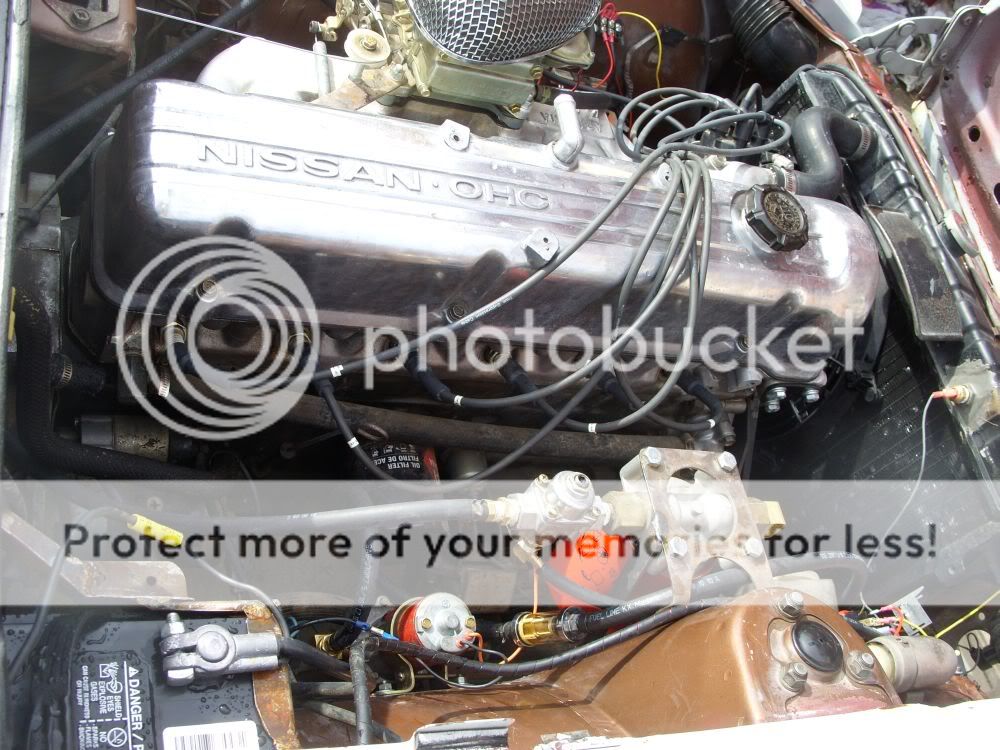

clutchdust Posted May 6, 2012 Share Posted May 6, 2012 I respect differing opinions but I went with an electric pump too. A little hard to make out but here's a pic of my set up. Quote Link to comment Share on other sites More sharing options...
odarp240z Posted May 6, 2012 Author Share Posted May 6, 2012 I respect differing opinions but I went with an electric pump too. A little hard to make out but here's a pic of my set up. What kind of electrical fuel pump and fuel pressure regulator are you running? Quote Link to comment Share on other sites More sharing options...
clutchdust Posted May 7, 2012 Share Posted May 7, 2012 It's a Holley "red" pump and a Jegs regulator. I didn't originally plan on running the red pump, I had a Carter electric pump at first but the pump wouldn't pick up from the tank. If it was primed it would work fine, but if fuel drained out of the pump chamber for any reason, I just couldn't get it to pick the prime back up. Part of the problem is that the pump was mounted so high in the car, it likely would be fine had it been mounted farther down on the rail or something. I have not had a similar problem with the Holley pump, but it is also mounted a little lower inside the fender. As for the regulator, it was just the cheapy one that they sell but you have to be specific when you order. You have to look specifically for one with a return. I ordered what I thought was the same regulator last year for another car and it turned out not to have the return. Keep your eyes on Craigslist and I'm sure you can find a good pump. I have now bought two Holley red pumps and that Carter pump on there. I think I gave $30 for the Carter (which still works if it's mounted low enough) and $40 each on the Holley pumps. The nice thing is the Holley pumps are rebuildable. Not a big fan of Holley carbs, but I do like their pumps. Quote Link to comment Share on other sites More sharing options...
