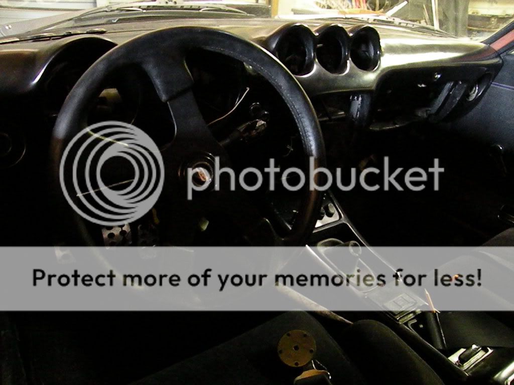

AllBoost Posted July 3, 2012 Share Posted July 3, 2012 Ive been a member on here for quite some time gathering information about my build. i recently bought a fully dressed lq9 with all the accessories and wiring harness as well as the entire fuse block and ecm. Im planning on dropping this into my 260z and getting my slide on. Im trying to finish my build in this next month and a half and am making this theres to see if there is anything i am forgetting. so please help me out! lol heres some pictures of the car. The body and suspension parts- -ground control coilovers -sway bars front and rear -r200 diff conversion from 280zx -Wilwood disc brakes on all 4 corners -4 point roll bar with 5 point harness and Corbeau Seats. And heres all the information about the motor. Short block is stock, pistons, rods, crank Just this month I installed a freshened up set of cathedral port 799 heads off a '08 truck. New FelPro MLS head gaskets, ARP head bolts Comp Cam .617/.605 225/230 Dur. Patriot gold .650 valve springs with titanium retainers, 7 degr. locks Comp hardened 7.4 pushrods 32 lb. "E85" injectors from flex fuel 5.3 Stock truck intake, throttle body, rails Parts i need to get. -JTR install kit. -T-56 trans and appropriate clutch. Because this is going to see mostly track use and heavy clutch kicks at speed which clutch do you think would suit my application best? -Master cylinder- Wilwood 15/16 replacement seems to be a popular choice. I also have a k-sport hydraulic handbrake with a 5/8 wilwood cylinder and im not quite sure how to get it working on my setup with a wilwood brake biaster. Any info on that would be greatly appreciated. -Fuel cell and fuel pump setup-I would love to see a could setups of what people are running why each is best. i need something with a decent bit of baffling because the rear of the car will always be sideways. -Radiator- Whats everyones opinion on these? Fans as well? Anyone have some cheap options? In the future i plan on getting a Arizona Z Car Lower control arms, Tension control rods, and shortened steering knuckles but i just want to get the car up and running with the new motor first things first. What else am i forgetting! Thanks to everyone in advance and yes i did search!!! Quote Link to comment Share on other sites More sharing options...

Dans toy Posted July 25, 2012 Share Posted July 25, 2012 Curious which Corbeau seat you managed to squeeze in your car. Fixed back or hinging. Most seats I've found don't fit well. If you have a picture and model number I'd appreciate it. Good luck on your project. Quote Link to comment Share on other sites More sharing options...
