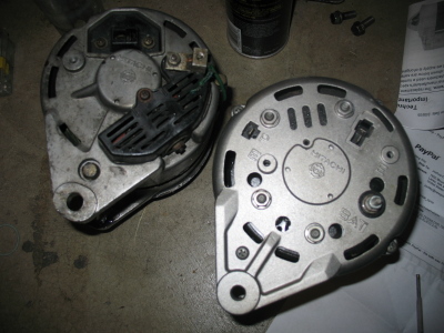

I'm having a few issues replacing the alternator in my '76 280z and haven't been able to find any information on this.
I had found this post: http://www.newprotest.org/details.pl?1236
It seems like the opposite problem of what I'm having.
The car currently has the alternator to the right. The automotive store gave me the one to the left.
I have no clue where to wire up the "Phase" wire and the Condenser wire to.
This is what I have:
Current (I've circled the areas where the wires were connected to):
New one from store:

Well it looks like you have a 280ZX alternator installed and you ordered a 280Z unit. Return the one you bought and get a 81-83 280ZX alternator and install the reverse of removal. You should check to make sure the car was properly converted to an internal voltage regulator as shown here: http://atlanticz.ca/zclub/techtips/alternatorswap/index.html
