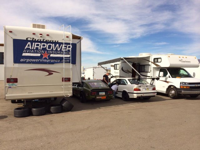

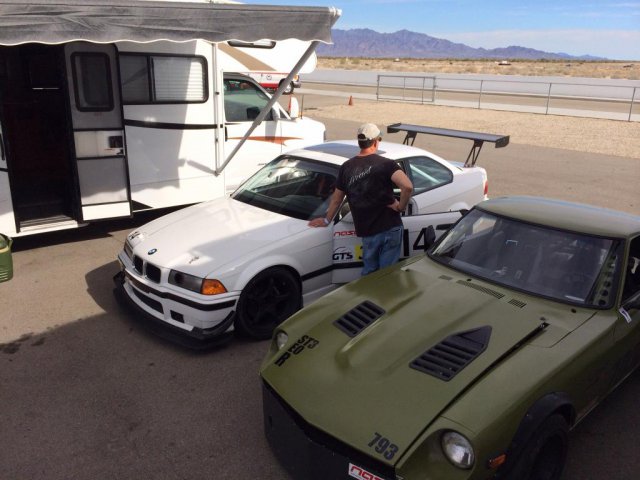

duragg Posted February 12, 2014 Author Share Posted February 12, 2014 Our paddock with a friends M3. #lolteammanagergotdrunk Rv is the only way Thanks to our generous sponsors: Airpower Insurance, LLC and GDMAC Consulting Quote Link to comment Share on other sites More sharing options...
