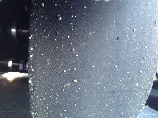

Check this photo of my tire wear pattern. The inside 3 inches look twisted and by the wear markers I am getting lots more wear on the inside of the tire. This is with 0.4-degrees POSITIVE static camber. From the videos above, you can see lots of rear suspension working. One of this winter's projects is to find some kind of rubber wedges to jam into the coil springs to further eliminate squat.

Its too bad I'm on Linux and don't have any software to play those videos. But you were so close to 10s. I think if you could launch a little harder you could get it, one really hot burnout and a good launch and shifting. Definitely looks like you have some serious squat/camber going on from that picture. Were you spinning any with the 2 step at 3500? I bet you could have just turned it up and either ran 10s or broke axles like the rest of us lol.

What is the toe like in the rear? I wonder if it's changing a lot under acceleration. Too bad you can't easily dial in some anti squat...
