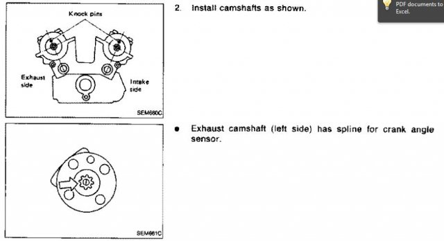

stony Posted November 13, 2012 Author Share Posted November 13, 2012 Cas sensor drive gear. its the little gear that is pressed into the cam that engages the cas sensor when its installed. In teh pic above you can see it on the right (exhuast) cam. it has a little half moon key way. When the half moon break you can pull the gear out and press another one in. It has to be clock a certain way so you timeing is correct and i want to verify is the VG gear is teh same as the Rb gear. I installed mine with the instruction provided from jim wolf. but my timing is not 180 Degrees out. So either the VG and RB drive gears are opposite each other or the instructions provided were wrong. I was told over the phone by a jim wolf tech they are the same. Quote Link to comment Share on other sites More sharing options...
Domzs Posted November 13, 2012 Share Posted November 13, 2012 I see what you are saying . Did my T-belt and all seals on my Z32 last year , Can't remember which way it clocks . Quote Link to comment Share on other sites More sharing options...
Domzs Posted November 13, 2012 Share Posted November 13, 2012 Found this . Quote Link to comment Share on other sites More sharing options...
