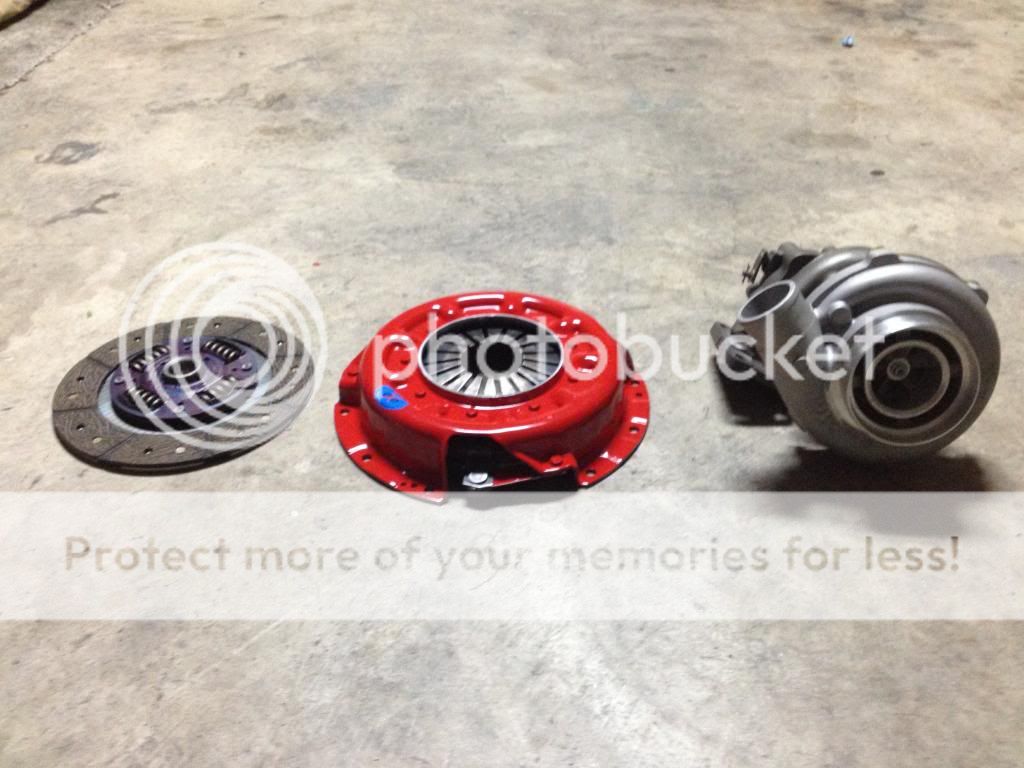

well i pretty much have everything to install the motor just received my clutch, turbo, and block last week and finished painting the valve cover, pan, head, intake manifold, and block. Just need to either modify the stock T3 wastegate actuator for the T04E or buy a bracket and new actuator...still trying to decide
Eye Candy!!!!

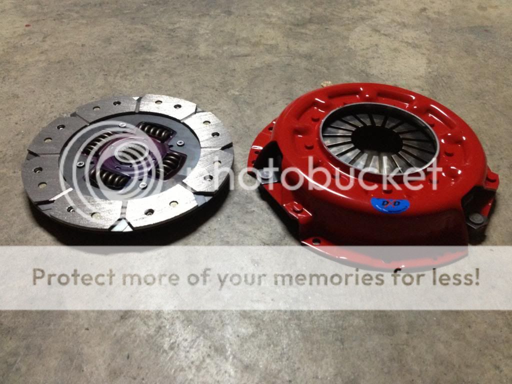

You can see on the disc that one side is organic and the other feramic material.
