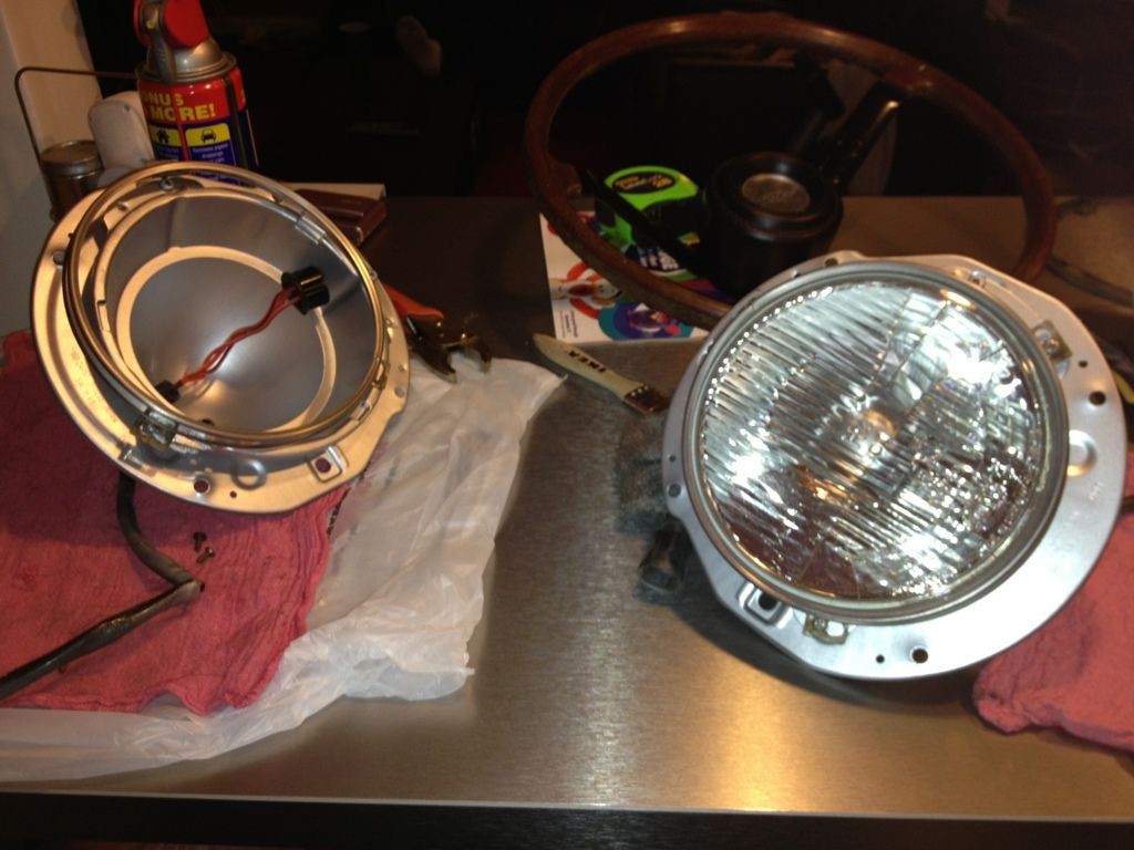

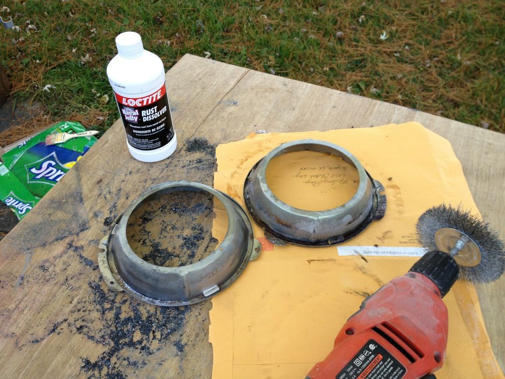

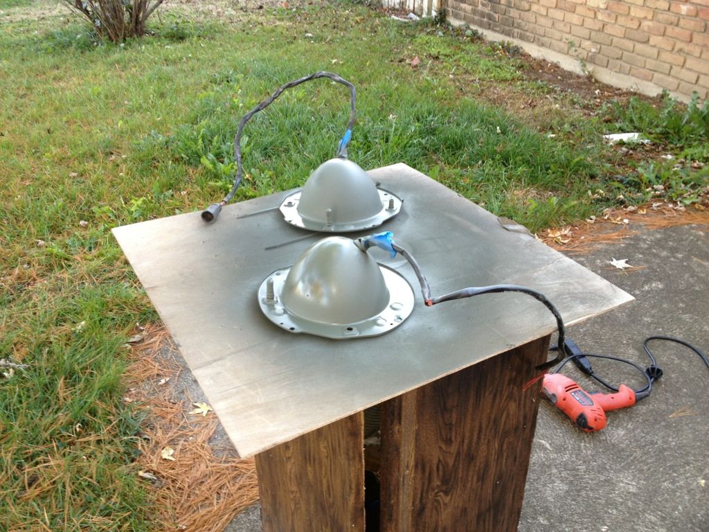

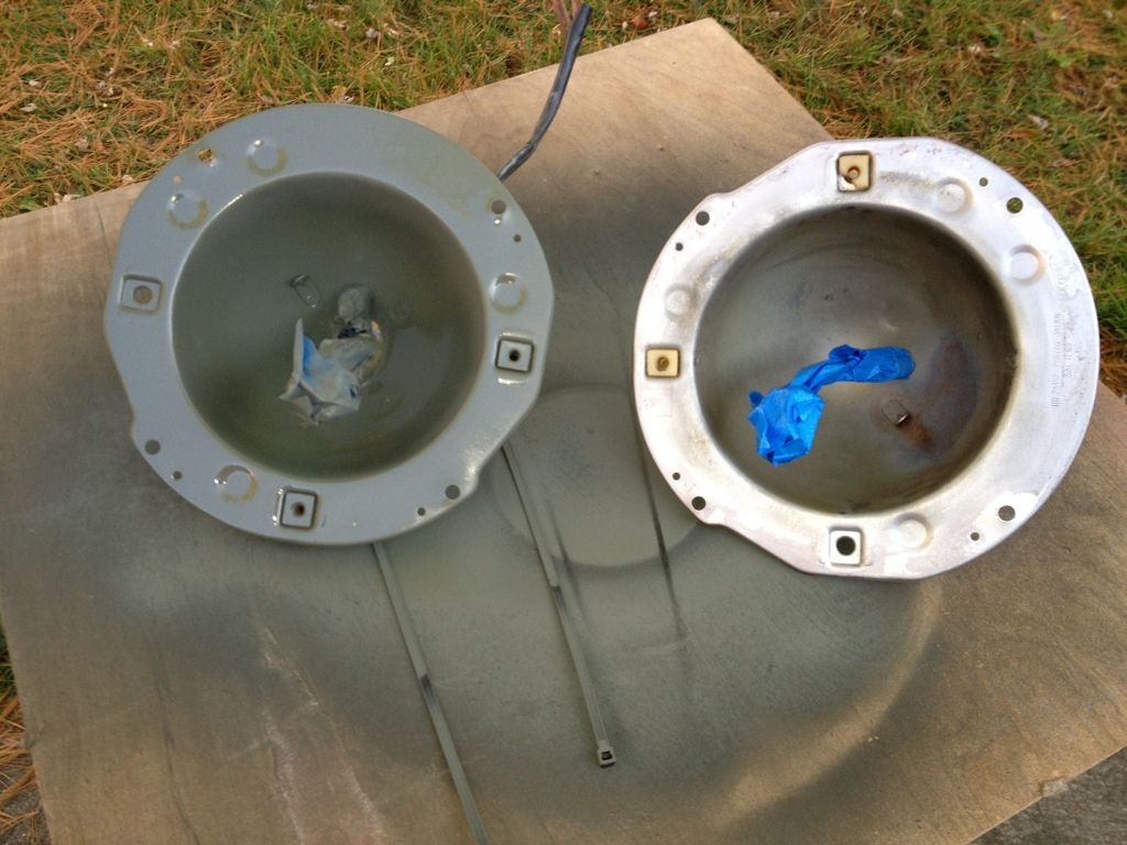

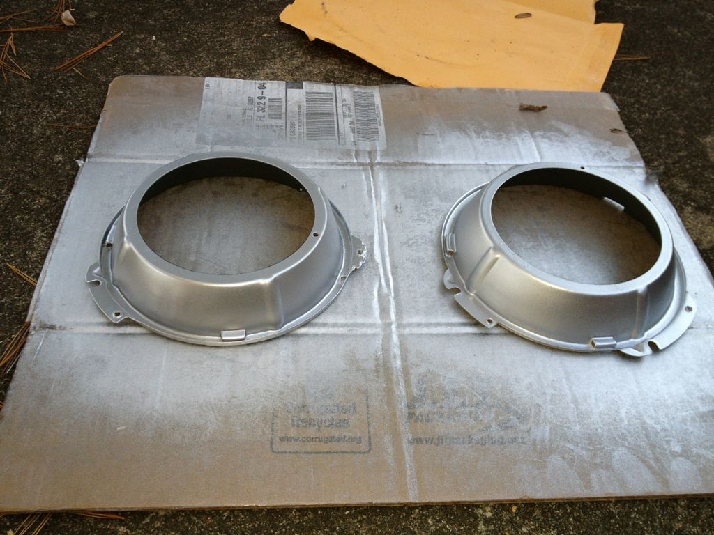

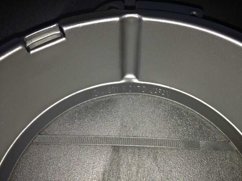

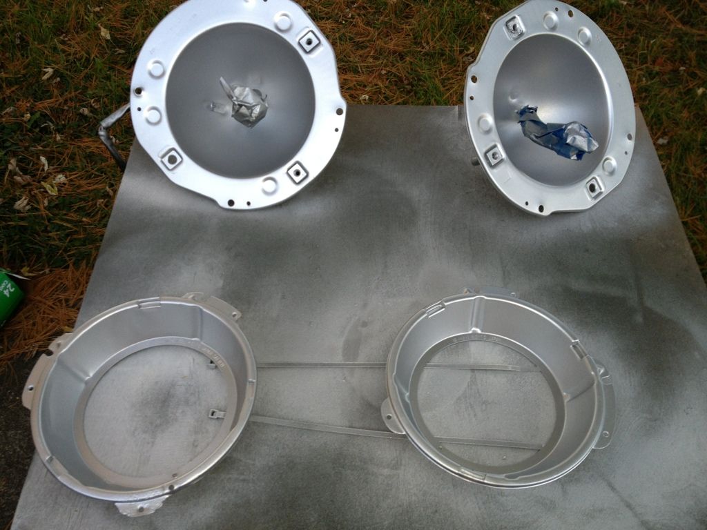

HI OFECR Posted November 19, 2012 Share Posted November 19, 2012 Head light bucket refinish Naval Jelly Lacquer thinner Wire wheel + drill WD-40 Self etching primer High temp paint Tap set Quote Link to comment Share on other sites More sharing options...
tamo3 Posted November 19, 2012 Share Posted November 19, 2012 Looks like a brand New one! Great work! Quote Link to comment Share on other sites More sharing options...
HI OFECR Posted November 19, 2012 Author Share Posted November 19, 2012 Thank you, They were all seized up took them apart and got the rust off and tapped & white lithium-ed the adjuster bolts and now they actually adjust. Quote Link to comment Share on other sites More sharing options...
