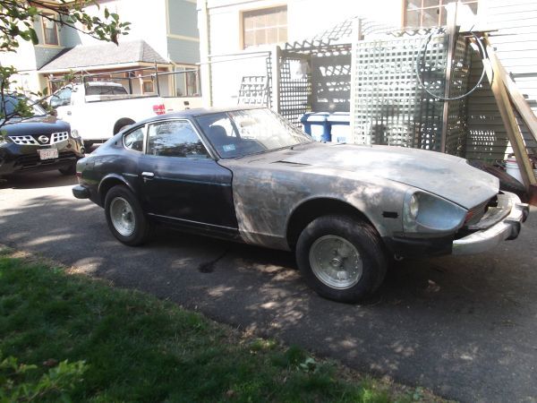

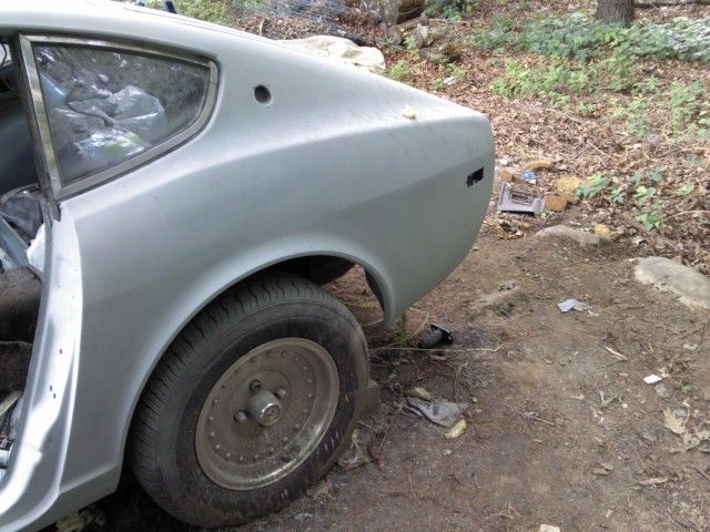

 i figured since its now getting colder up in mass and i figured theres not much i can do on my Z since im at college, id start my own build thread. I picked up a 75 280z back in may as a birthday present to myself i talked the guy down from $1500 to $800. i bought the car with 80,000 on the body and only minimal surface rust. There was no motor  in the car but the guy included a 79 zx that I've ended up adding a turbo to. Along with the motor the only thing that was in the car was seat and dash but when i got back from picking up the car it was packed full with boxes.

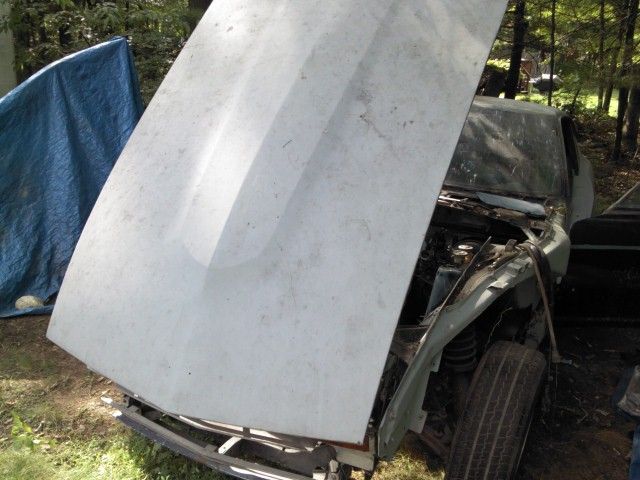

The day i went to see it

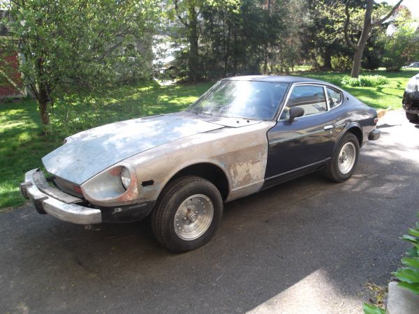

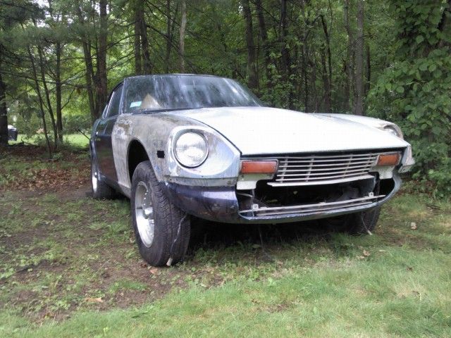

The front end was chemically stripped and the car was painted once
Home safe and sound

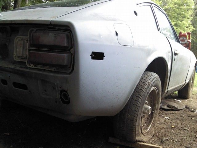

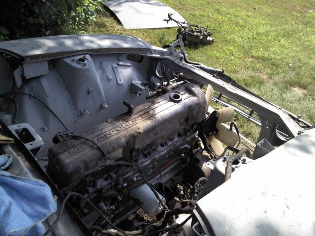

With my car home i got to work stripping the body down to bare metal and priming the entire car.
There was alittle bit of damage on the drivers rear quarter that i pulled the metal to get closest i could to original and then i used a light coat of body filler to get rid of the small dings.
The passenger side was in good shape besides right by the door
The front end was in pretty good shape

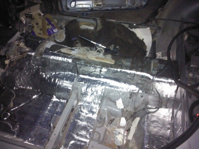

I did a little bit of sound deadening

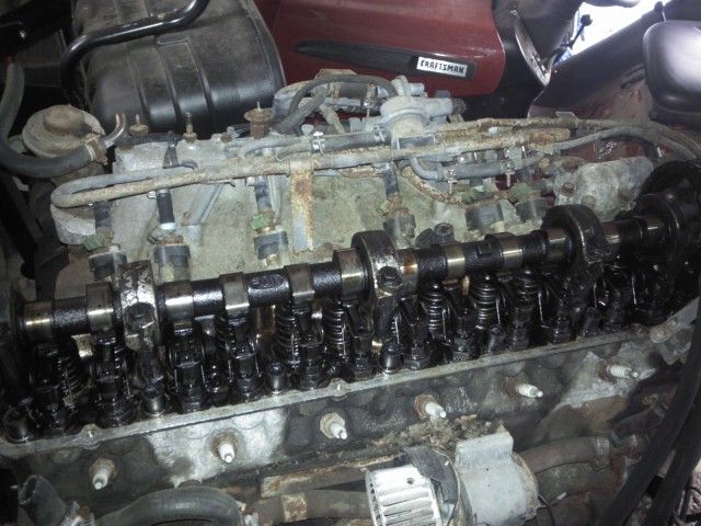

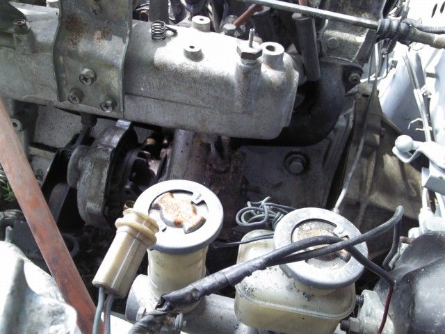

Once i finished most the body work and the massive 280z bumpers gone i got to work on the motor. i was a bit worried going into the motor since it appeared some  sort of an oil leak so i did most of the gaskets and got a new cam since mine snapped in half :banghead: but i fixed that and got some new spark plugs and replace the intake manifold off a turbo motor(not in pics) with injectors etc.

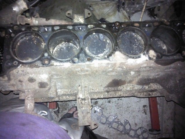

besides all the crap in the cylinders they were in great shape way better than i was expecting :D

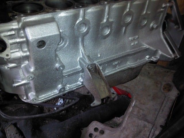

so i cleaned out the cylinders and block then painted the block
i put everything back together and dropped it in

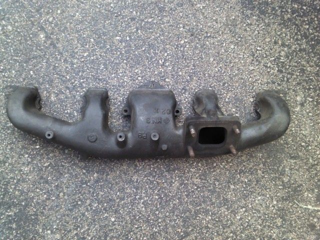

i picked up a stock turbo manifold off ebay that had been ceramic coated
