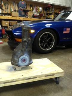

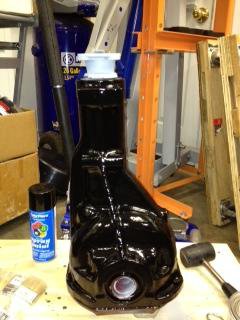

For painting of case, I took a furniture dolly and added some bracing and a 3/4" plywood platform.  These little platforms with casters are what I use for tire storage and for moving around engines and transmissions.  $15 from Harbor Freight.  Drilled (2) 1/2" holes in it for the diff cover studs.  Stood it straight up to allow me to paint the entire case without having to roll it around and paint one side at a time.  That saved me about a day of paint drying doing multiple coats.

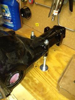

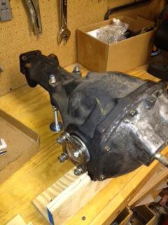

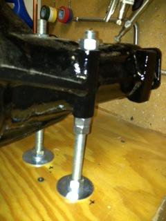

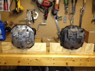

Plan for servicing the unit on the bench is (2) sections of 1/2" all-thread going thru the 3/4" plywood bench-top reinforced with big fender washers.  Photos when I have that built, Wednesday-ish.
Got the fixture(s) made.  Whole purpose of this is to be able to swap the CLSD from one unit to another without wrestling the diffs around like a big fish in the bottom of the boat.  Attached are photos of the finished product.  If I could change anything so far, it would be to use 3/8" all-thread instead of 1/2".  1/2" fits perfectly and it makes it a bit of a wrestling match to get the diff pulled up off the all-thread studs.  3/8" would be a lot more forgiving of minor misalignment, but still get the job done.  Burnout photo is just self glorification.  Now to get the job done!
