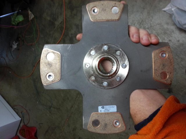

I have a clutch from Clutch Masters Industries that came with parts I bought. I will never go to the track and I am looking for something that will be great for the street and be smooth. I went to the clutch master website but I could not find my clutch on their website. So here is the picture and hopefully someone can identify if it is a street or track clutch.
Second, if it is the wrong clutch for me, what do you think about ebay clutches?
You don't want to use that disc if the car is to be street driven, it is an unsprung
four puck race.  You can, but it will be grabby and harsh.
As for ebay clutches, some are excellent, and some might be junk.  Without
knowing more about your car/engine, it is impractical to try to recommend anything
specific, well except that the disc pictured is a poor choice for regular street driving.
