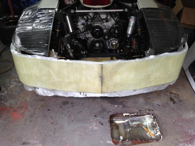

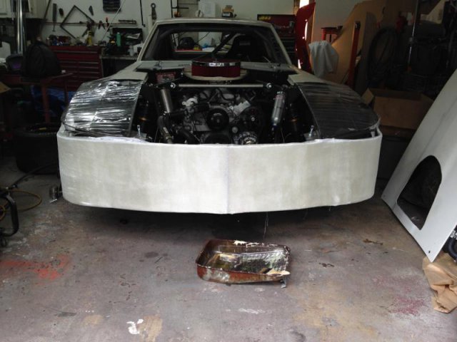

Suppose it's time to update this. Set this aside for the last few years, back at it now. Pulled all the foam off and chucked it in the garbage. Wasn't working and was making a HUGE mess when I tried to shape it. tube80z suggested fleecing the front end, which is pulling fleece (like sweatshirt material) over a frame and then glassing that. I thought that sounded a hell of a lot easier, so that's what I did.
Since the last post I cut the frame rails in front and built a front end frame that bolts to the ends of the stockers and I laid the rad down flat and built a duct to feed air into it. When I tried to fleece around the corners, the fleece wouldn't stay straight, so I used packing tape across the frame and then laid the fleece on top of that. Then I brushed some epoxy right onto the fleece to make it a little bit stiff, and used a couple layers of 8oz E glass over that. The E glass wasn't cutting it. Wasn't very stiff at all, so I went to TAP plastics and got some Knytex. Knytex is 3 layers of fiberglass in one, two 45 degree weaves and a mat layer behind that. It's much heavier and thicker. Laid one layer of Knytex across the front and figured it was going to be strong enough.

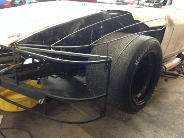

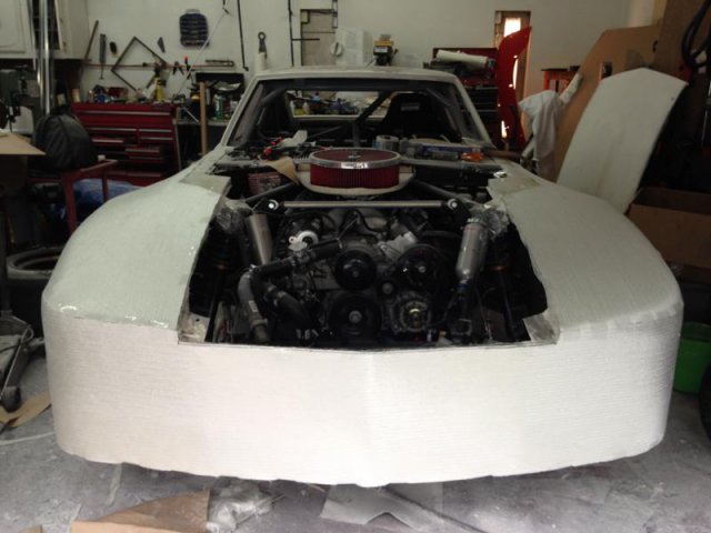

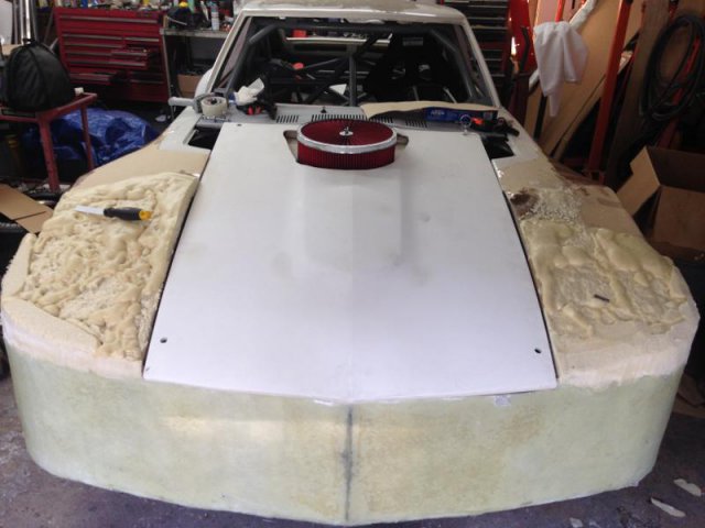

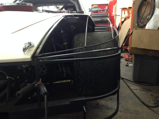

Then I started in on the flares again. Made a .25" thick wire frame for each side. Just measured each piece again and again, held the piece for one side up against the piece for the other side to make sure I had the shape the same. I can deal with a little assymetry but didn't want it to look really bad. Measured quite a few times, then tacked the steel frame to the front frame and the body. Put packing tape across the frame and then tried drywall mud on top of some packing paper. The mud was too thick and wouldn't dry. Also cracked a lot. Tried some 2 part expanding polyurethane foam, planning to shave it to the right dimension and then figured I'd lay the fiberglass straight onto that. The foam was too tall, I couldn't sand it low enough, so had to pull it all off and wrap the frame underneath instead of on top. Foamed again, had it just about exactly right, then the next day when I went out the foam had shrunk. I think I messed up the mix of the 2 parts and had too much foaming agent and not enough hardener. Went back to the mud. Laid the mud on top of the foam so that it didn't have to be as thick, and got a better result.
Got the pass side pretty well done today. Still need to finish up the driver's side, waiting for more mud to dry so I can sand the final shape. Then I will lay one layer of Knytex over the fender to meet up with the airdam part. After that, I'll lay a final layer right over everything. Then I can cut the fenders away from the front to separate later. The idea is that by having it all be one piece the lines will match up better.
Thanks Keith. Especially after having the blue foam experiment fail so completely, I'm pretty impressed with the result too. A little more mud on the driver's side today, was hoping to lay the glass today. Looks like tomorrow might be the big day.

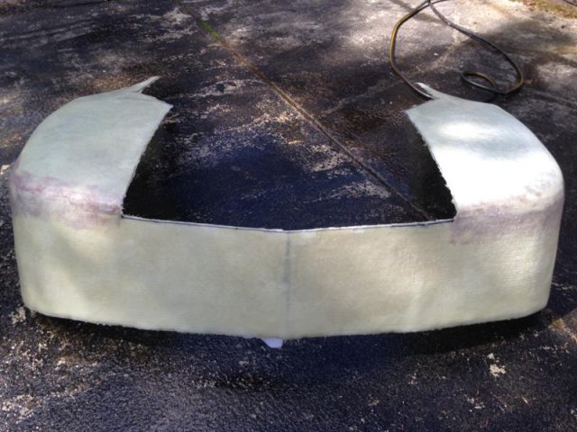

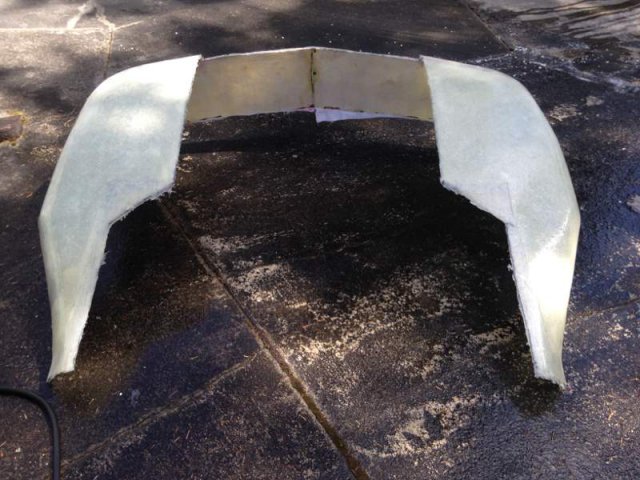

Here is the (hopefully) last layer of Knytex ready to be wetted out. Got some thicker 24oz/yard stuff this time, I think this will do it. Wetted this morning, will have to have a look tomorrow and see what needs fixing, etc. Not sure what comes next. Glazing?

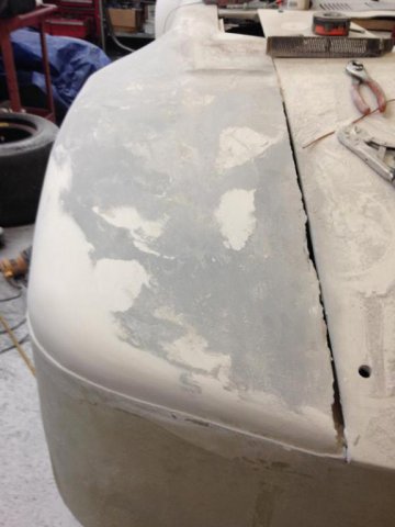

More. Pulled the fiberglass off of the buck. I waxed the crap out of it but it didn't come off very easily. Had to basically break apart the drywall and foam to get it off, then had to scrape and wire brush a lot of drywall off of the underside. Pulled it outside and washed it off with soap and water to get rid of the amine blush. Next I think it dzus fasteners, little bit of filler here and there, and a skim coat to get rid of the fiberglass weave pattern. I halfway thought about leaving it as one piece, but it is really difficult to get on and off like this, so I will cut the fenders away from the front. Need to figure out how to attach them on the car now...
Thanks. Got tabs welded the the front frame already. Will need to figure out some areas to put dzuses on the back part of the fender.
