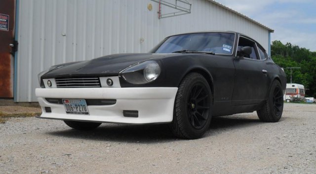

Domzs Posted March 7, 2013 Share Posted March 7, 2013 Ok , i just finished my LS1 swap , 78 280 Z . Now , with new wheels and tires are mounted , i'm ready to move on to suspension mod. . Questions are for those who cut their OE springs : I was thinking of cutting 1/2 a coil in the rear , that should give me the look that i'm shooting for . And the front , i need at least 2 in. lower . For those who cut 1 coil off , i need to know how much lower and ride quality ? I have done this , cut a coil off , before on my 83 ZX ( LS1 and 6 spd. ) . Got the look i wanted but the ride is a little too harsh for me . Any inputs or other options will be appreciated . Don't want to do coilover at this time . Thanks Quote Link to comment Share on other sites More sharing options...

Domzs Posted March 8, 2013 Author Share Posted March 8, 2013 Actually the rear is not so bad . Would like the rear to be a little stiffer . I'm very happy with rear on 83 ZX , by cutting a coil it helps the car from squatting too much during launch . Since the LS1 motor is a little lighter , i don't need it to be very stiff up front . I might just cut half and go from there . Just need to know how low will i get with half cut off . Don't think i will get 2 inches that i'm looking for up front . Might have to lower the spring seats . Thanks the above for your inputs . Quote Link to comment Share on other sites More sharing options...

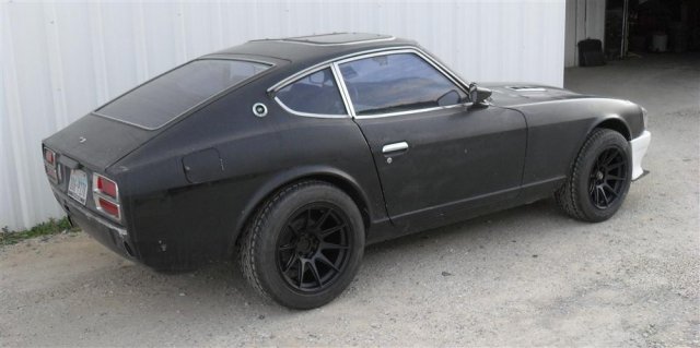

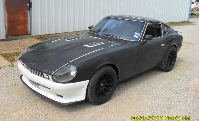

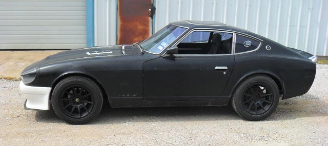

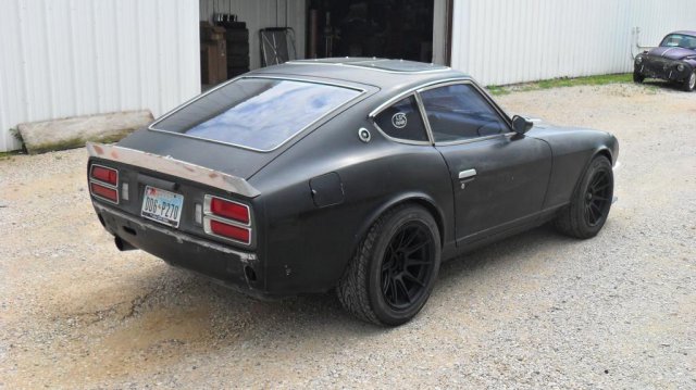

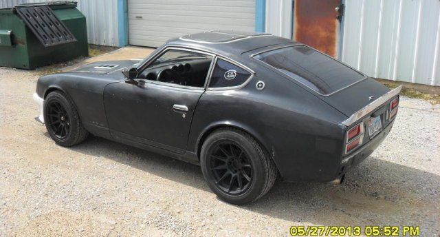

Domzs Posted June 1, 2013 Author Share Posted June 1, 2013 Here's the update . I cut 2.5 off up front and 2 off in the rear , 1.5 would've been better . Now , I have to redo my exhaust system . Sitting way too low , 2" off the ground . Quote Link to comment Share on other sites More sharing options...
