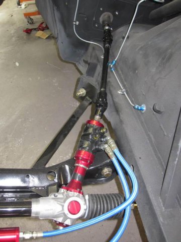

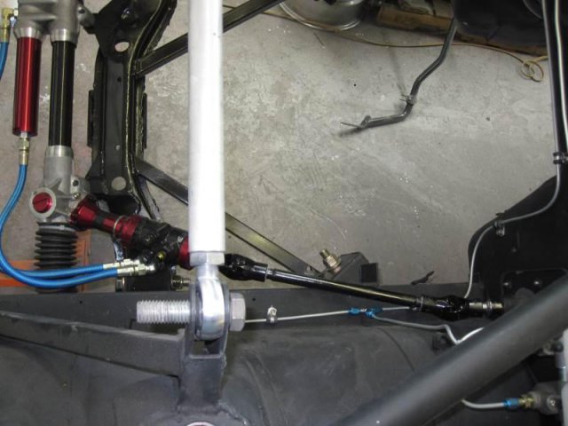

JMortensen Posted March 9, 2013 Share Posted March 9, 2013 (edited) I have one of the Woodward to Datsun joints that I'm not going to use because I ended up going with a whole custom Woodward rack. You would need to convert the center shaft to Woodward joints on the other end too. I also have another regular Woodward joint. In addition you'd need three of their male ends. 2 to make the intermediate shaft that plugs onto the U joints, and one to weld to your steering column. The joints are about $60 each. I'd sell these for $80, and I'll cover shipping. You can get a decent idea of what has to happen by looking at my shaft that I made for the Woodward rack. EDIT- Just remembered I have more than enough 3/4" steer tube too. You can have that as well, bump the price to $100 and then you just need three of the male ends and weld it together. Looks like they are $5.30 each from Woodward direct: http://woodwardsteering.com/images/steering%20universal%20joints.pdf (ST201) Edited March 9, 2013 by JMortensen Quote Link to comment Share on other sites More sharing options...
