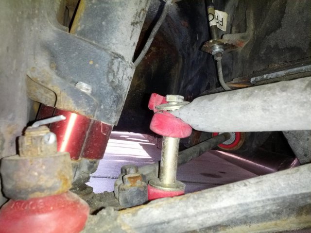

When I looked at the suspension, though (suspecting tension control rod), I found this on the right sway bar.  It has some play in it.  Could a blown sway bar bushing cause a braking pull?  Googling was ambiguous; some said yes, some no.
I plan on replacing it in any case; they're only $16
EDIT: Sway bar end link, to be precise.  My mistake.

For what it's worth, I replaced the broken set, and took apart and re-greased the other.  The other side appeared to be massive over-torqued, severely squishing the bushings.  I read 15 ft lbf as a torque spec somewhere.  Unfortunately, I was unable to get a torque wrench up there and see it, so I went with the "feels about right" method.
The pulling is diminished.  I think after re-checking torque (one side seems a little low based on thread protrusion through the nut) and letting everything settle, it might disappear entirely.
If someone installed the anti-roll bar so it was preloaded or asymmetrically loaded then it could have some affect on braking.  But a properly installed anti-roll bar will have no effect on braking unless the braking area is very bumpy.
