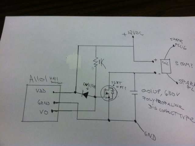

280zex Posted April 11, 2013 Share Posted April 11, 2013 for those who know how to read this diagram, is my thinking correct?? I'm still unsure about the IGBT, should it be pt or npt?? Quote Link to comment Share on other sites More sharing options...
280zex Posted April 11, 2013 Author Share Posted April 11, 2013 Well it looks like the Bosch BIP373 IGBT is the best on the market for this application. Looks like I'm just going to wire this up and see if it will fire up a head lamp first before I try to run my coils.. Quote Link to comment Share on other sites More sharing options...
