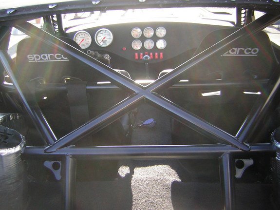

  5. I did find something on car domain I like.....I think this person is a HBZ member....I kinda remember this pic from around here some place....I love the interior!!!
