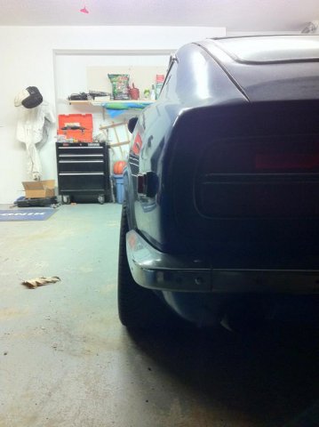

Okay so I finally bought a new pair of wheels for the Z.
They are SSR Formula Mesh in 15x8 -14 offset.

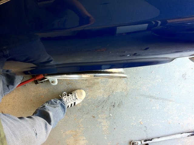

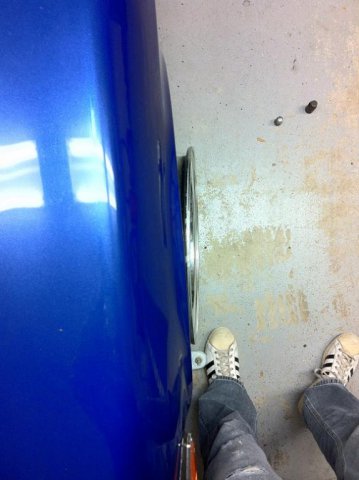

Current set up is coilovers, 15x7 Konig Rewinds with 205-50-15 in front and 225-50-15 in rear. Lips are unrolled.

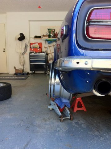

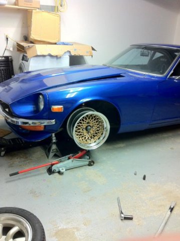

I did a test fit of the new wheels without tires on the car and they stick out more than I thought they would. I wanted to run a 225-50-15 all around, or a 205-55-15 in the front. To me it doesn't look like I can fit that. What tire sizes do you guys think will fit? I am not into a stretched look like 195s and I think my current 205-50s have too short of a sidewall.
Also, I only bought a pair of these, but there is another set for sale in the same specs. If I cant fit the tires I want then I will have to buy a smaller size.
Thanks for any suggestions.
I am running 15x8.5 -2 Work Equips on all fours with NT01s 225s - mild mild stretch and I rolled my rears (which is super easy to do BTW).
I say 205/215.  Go sticky with a mild stretch.  Gorgeous car BTW.

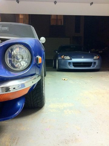

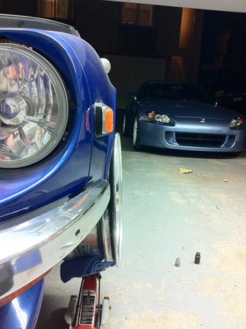

thanks haajehaa and ryne those are some good looking cars. i prefer a car with stock fenders and wide wheels.
for this fitment i took my existing tires (205-50 & 225-50), put them on the new rims, and put them on the car. i think it looks pretty good
