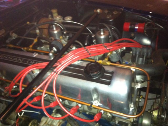

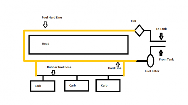

T-Bone028 Posted April 30, 2013 Share Posted April 30, 2013 Folks, looking for some feedback on my planned fuel line routing for my triple weber install. Currently, my set-up with SU's is as follows: Tank > fuel filter > fuel pump > fuel filter > custom fuel hard line with two T's that feed the SU's > fuel pressure regulator (3.5 PSI) > return to tank. My question is, would it be feasible to plumb the triples in-between the two T's on the current fuel hard line? Right now, the existing 2 T's feed 1 SU each. My triples have T fittings on all 3 carbs. Pictures are worth a thousand words, so first picture is my current plumbing with SU's, and then the beautiful and very professional MS Paint picture is what I was thinking I could do without having to change too much to my current system. Thoughts on why it would or wouldnt work? Any risk of fuel starvation? Thanks in advance. Quote Link to comment Share on other sites More sharing options...
duragg Posted April 30, 2013 Share Posted April 30, 2013 I am sure it would be fine. Personally I don't think Webers are as picky about how they get their fuel. I've run a variety of pressures (including none) and it has to be a pretty gross violation for them to stop working. Mine are just deadhead. Tank-pump-filter-regulator (5 psi) to carb 1, 2 then 3 and done. One day I will do a cool looking setup like yours. Quote Link to comment Share on other sites More sharing options...
Leon Posted May 1, 2013 Share Posted May 1, 2013 That'll work fine. Quote Link to comment Share on other sites More sharing options...
bradyzq Posted May 1, 2013 Share Posted May 1, 2013 Tank => filter => pump => filter => carb => carb => carb => FPR => return This is what you have suggested, but with your hard line immediately above and parallel to the carbs removed. It may be redundant anyways. You Paint skills far surpass mine, BTW. Quote Link to comment Share on other sites More sharing options...
