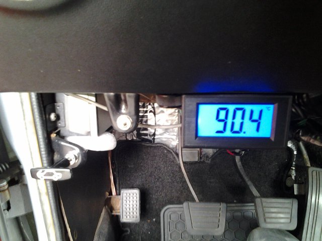

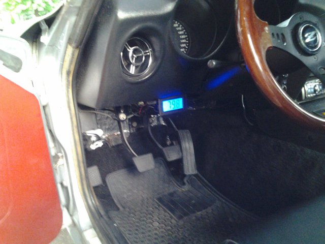

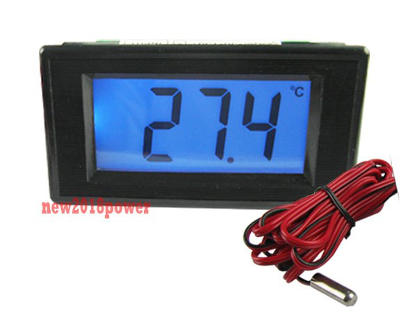

PLATA Posted July 22, 2013 Share Posted July 22, 2013 (edited) My 40+ yr old original temp gauge is erratic( works fine one day then goes on crazy mode and back to OK status), I want to keep the original gauges and not to mess with old electronics , the plan is to add a secondary mini temp gauge , there is an extra spot on the LS1 engine to do this, gauge/adapter on hand. But this mod will be l done at a later date, for now I will place this temp/digital/gauge as a quick fix in order to monitor the temperature , I will place the probe on the returning radiator hose ( no butchering, the probe all it needs is contact) and the small digital gauge ( 3''x1'') under the driver's side cabin vent, that will keep me informed >>>> Edited July 23, 2013 by PLATA Quote Link to comment Share on other sites More sharing options...

PLATA Posted August 5, 2013 Author Share Posted August 5, 2013 I got the temperature device installed, works fine, it reads in Celsius not in Fahrenheit , i'll just double the reading for a WAG . Now I have a temp gauge as a back up . Pics on the way Quote Link to comment Share on other sites More sharing options...

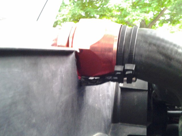

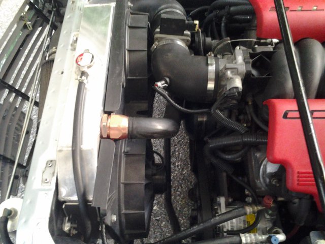

PLATA Posted August 5, 2013 Author Share Posted August 5, 2013 (edited) My low tech mod>>>>>> sensor on rad/hosedigital gauge in cabin looks cool blue at night Edited August 6, 2013 by PLATA Quote Link to comment Share on other sites More sharing options...
Domzs Posted August 6, 2013 Share Posted August 6, 2013 Looking good . But I don't think you are getting good temp. reading from there . Since you don't have P/S , can you put the temp. probe in one of those holes in front of the head ( driver side ) ? I think it's hotter there and that's where the CTS for the ECM . Just a thought . Quote Link to comment Share on other sites More sharing options...
PLATA Posted August 6, 2013 Author Share Posted August 6, 2013 (edited) It is fairly accurate, at 89c=190f it kicks the fans, the auto fan relay is set to go at 175f , so it is Ok for now. It's keeping me informed and that was the target for this quick fix. Edited August 6, 2013 by PLATA Quote Link to comment Share on other sites More sharing options...

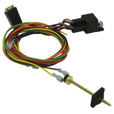

PLATA Posted August 6, 2013 Author Share Posted August 6, 2013 Mine has this external type rad fan relay, set at 175f . Quote Link to comment Share on other sites More sharing options...
Domzs Posted August 6, 2013 Share Posted August 6, 2013 What's off temp. ? What's your T-stat temp. ? If off temp. is lower than T-stat then your fans run all the time , once they are activated . Quote Link to comment Share on other sites More sharing options...
PLATA Posted August 6, 2013 Author Share Posted August 6, 2013 What's off temp. ? What's your T-stat temp. ? If off temp. is lower than T-stat then your fans run all the time , once they are activated . Pre set to turn on at 175/185, turns off the fans at 165f , it has worked fine for over a yr. The ECM for some reason was not sending the signal for proper functions. Quote Link to comment Share on other sites More sharing options...
