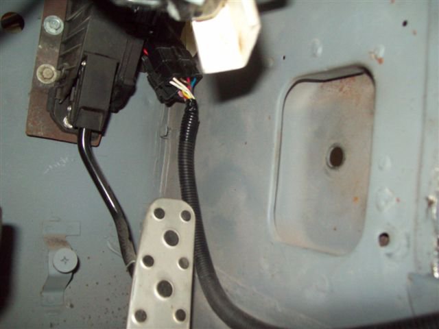

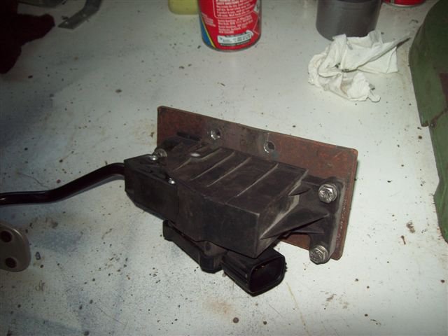

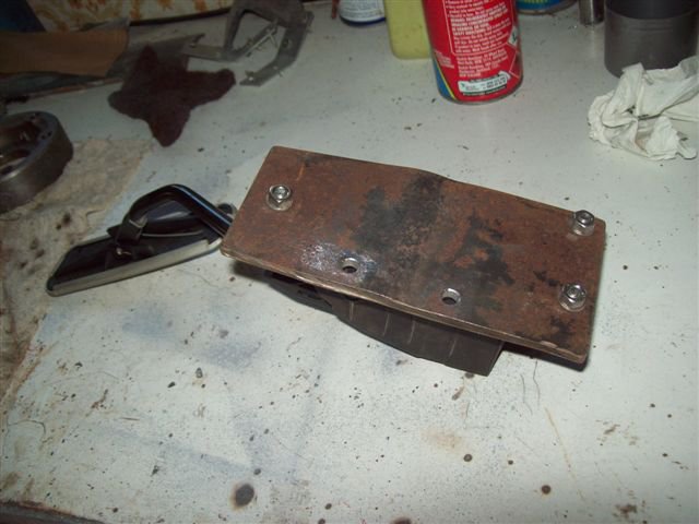

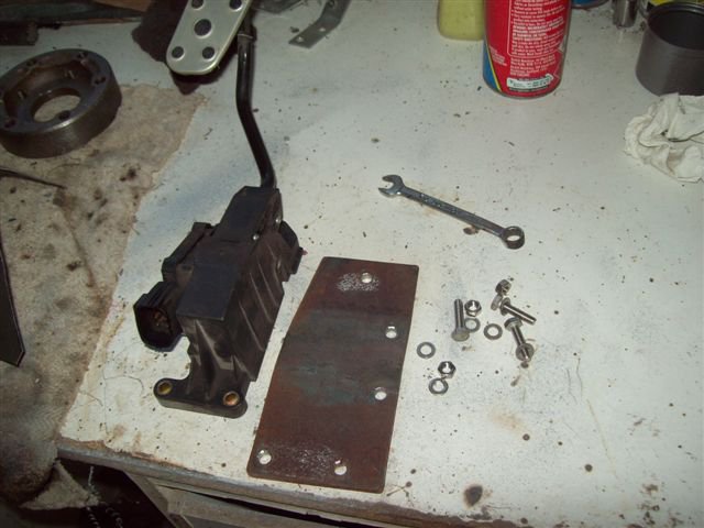

Boy from Oz Posted August 16, 2013 Share Posted August 16, 2013 This was my first attempt but I hope to later make a new mount out of 3/8" aluminium plate and countersink the bolt holes where it mounts to the car. That way I can position the accelerator directly over the existing car bracket instead of offset as you see in the photos. Quote Link to comment Share on other sites More sharing options...

RebekahsZ Posted August 16, 2013 Share Posted August 16, 2013 Hey Oz Boy- you put the pedal on the wrong side! The pedal is on a hinge. It doesn't need to be very strong. Just make sure you have a stop at the bottom so you don't crack the plastic. Quote Link to comment Share on other sites More sharing options...

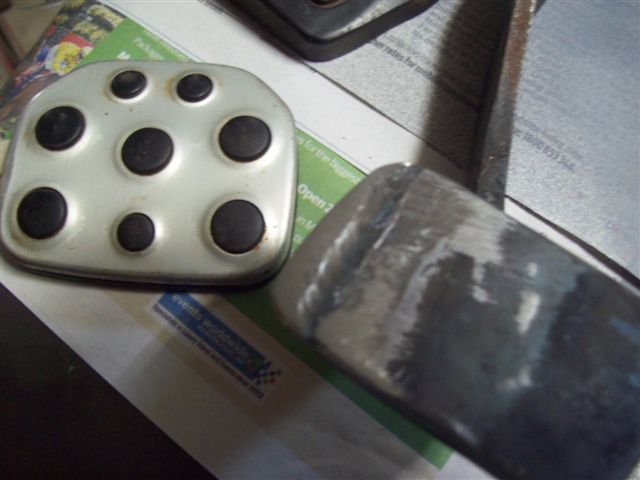

Boy from Oz Posted August 17, 2013 Share Posted August 17, 2013 On 8/16/2013 at 7:41 PM, RebekahsZ said: Hey Oz Boy- you put the pedal on the wrong side! The pedal is on a hinge. It doesn't need to be very strong. Just make sure you have a stop at the bottom so you don't crack the plastic. Don't call me "Boy"! Thanks for the tip on fitting a stop. I used the Holden (GTO to you) donor foot pads as well, to match the accelerator.. I just needed to weld an extenion piece on so they wouldn't flex during any heel and toe action. Quote Link to comment Share on other sites More sharing options...
