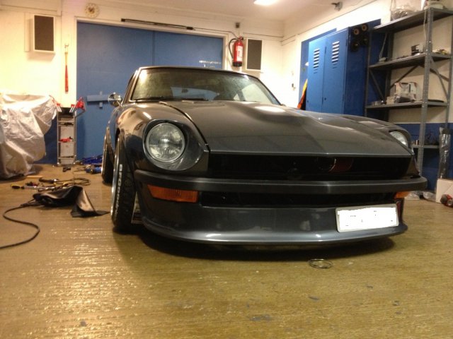

HaaJeHaa Posted September 18, 2013 Share Posted September 18, 2013 Coilovers or lowering springs? Front will most likely hit the strutcasing at 17x8,5 et5 and the rear will definitely hit at 17x10 et-5. You need about 10mm thicker spacers to clear the inside fender. For the front 17x8,5 et-5 will work, but the rear at 17x10 et-15 would need flares. It would poke way to much... As all cars have small differences, suspension setups etc you will have to measure yourself to be safe. 10 min of work will answer all your questions. See www.willtheyfit.com and go and measure;) Quote Link to comment Share on other sites More sharing options...
HaaJeHaa Posted September 18, 2013 Share Posted September 18, 2013 (edited) I would also go for a lot thicker spacer in the front to let it even with the rear. Go for about 10mm less offset on the fronts, so you'll be at 8,5 et-25 front and 10 et-15 rear. This will require flares both front and rear. In my experience 10" rears without flares are not doable if you're not running a lot of stretch, negativ camber and pulled fenders... Edited September 18, 2013 by HaaJeHaa Quote Link to comment Share on other sites More sharing options...

HaaJeHaa Posted September 18, 2013 Share Posted September 18, 2013 I see;) Coilovers will give you more space to play with, thats why I asked. Yup, you'll need an extra 10mm for the rears to work (about -15 offset on 10"). I would recommend measuring this aswell as my comparison is on Arizona Z coilovers. The fronts will be ok at -8 but they will look sunk-in compared to the rear. That's why I recommend thicker spacer in front. The camber kit won't solve any issues. Your issue is on the inner side of the fender towards the strut assembly. That space won't change whether you give it camber or lower it. I'm not sure about what your thoughts are on the stance of the car. If you're going to run flares a flush setup does look the best. For this about -20 to -25 offset on the 10" is required. Do the math for the fronts yourself;) The stock fenders can run the same width/offset wheels both front and rear as the track (for the 280z atleast) is the same, so you can space the fronts to match the rear. It's really a gamble if you're purchasing parts without knowing the measurements yourself... Quote Link to comment Share on other sites More sharing options...

HaaJeHaa Posted September 18, 2013 Share Posted September 18, 2013 I did not read the previous posts because I'm in class but I will try to chime in my opinion lol Rear: the offset you have is way too high. You will hit your struts. Highest you can run on a x10 safetly is 0. Keyword is safetly lol No matter what offset you're running you're going to have to run ZG flares with x10 wheels if you don't want to poke out of your fender. Fronts: you can get away with 15mm spacers and MAYBE some neg camber Tires on the x10 Im about to run R888 235/50 On your fronts I would run 195/50 R888s Nope, you'll need more negative offset to run 10" rear. You'll hit the strut at zero offset. Measure for yourself if you don't believe me;) Not if you pull the rear fenders and run 225/45's. That will work, although not recommended. No need for negative camber at that width for the fronts. Depends on tires though.. Quote Link to comment Share on other sites More sharing options...

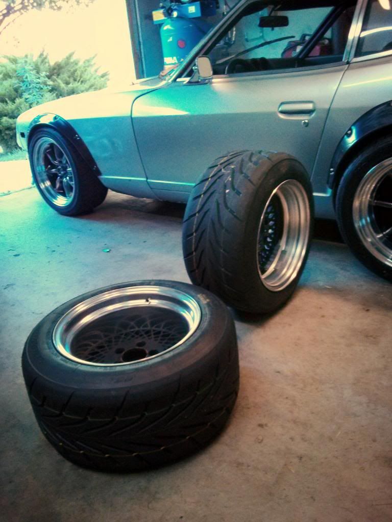

miky360 Posted September 19, 2013 Share Posted September 19, 2013 (edited) This guy is running 15x10 -29 with plenty of room -29mm + 38mm = 9mm. and that would sit on the struts. Of course you need to give it some space for tires but if he plans to go stanced and do a badass stretch then thats pretty ballsy to do go with a positive offset. I feel like Zero is a safe bet for him. Rodriquezf0913, what kind of look or function are you going for? do you want flares or no flares? Edited September 19, 2013 by miky360 Quote Link to comment Share on other sites More sharing options...

HaaJeHaa Posted September 19, 2013 Share Posted September 19, 2013 (edited) This guy is running 15x10 -29 with plenty of room -29mm + 38mm = 9mm. and that would sit on the struts. Of course you need to give it some space for tires but if he plans to go stanced and do a badass stretch then thats pretty ballsy to do go with a positive offset. I feel like Zero is a safe bet for him. Rodriquezf0913, what kind of look or function are you going for? do you want flares or no flares? Hmm, thats why he should considering measuring himself. I do not have that room to play with;) Edited September 19, 2013 by HaaJeHaa Quote Link to comment Share on other sites More sharing options...
miky360 Posted September 20, 2013 Share Posted September 20, 2013 With an RB swap I would go with F:17x9 0 R:17x10 -15 Tires, I'd still stick with the R888s (Best bang for your buck) at 235 in the rear and 205 in the front. That's a 235 R888 on a 10. That's 280zcar's setup btw. Absolutely love it HaaJeHaa, with our cars being 40 years old im sure most peoples setup vary differently from the next guys with all the wear&tear LOL but hey, that's just how things go Quote Link to comment Share on other sites More sharing options...
