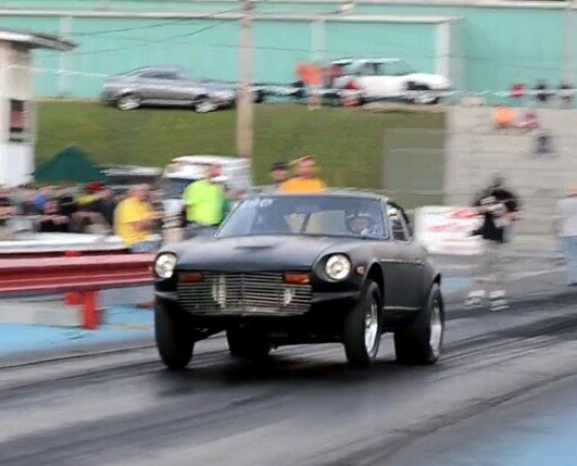

ls280z Posted September 18, 2013 Share Posted September 18, 2013 1.32 60ft 6.06 @111.95 Think ive reached the flow limit for the stock ls1 intake. still on the 230 dru shot. Added 65lb to the nose helped it from wheelstanding couldnt believe how good the car worked. Quote Link to comment Share on other sites More sharing options...
ls280z Posted September 18, 2013 Author Share Posted September 18, 2013 had to weigh 3000lb at this race it weighed dead on 3000 Quote Link to comment Share on other sites More sharing options...
SUNNY Z Posted September 19, 2013 Share Posted September 19, 2013 you should add the setup to your sig so i don't have to ask every time! glide? what stall? Quote Link to comment Share on other sites More sharing options...
ls280z Posted September 19, 2013 Author Share Posted September 19, 2013 glide with 2800 stall Quote Link to comment Share on other sites More sharing options...
