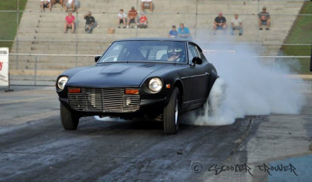

  3. had to weigh 3000lb at this race it weighed dead on 3000
  4. 1.32 60ft 6.06 @111.95 Think ive reached the flow limit for the stock ls1 intake. still on the 230 dru shot. Added 65lb to the nose helped it from wheelstanding couldnt believe how good the car worked.

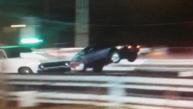

  9. Got put out 1st round because of this whhelstand I'll post a pic later to show how high it actually was
