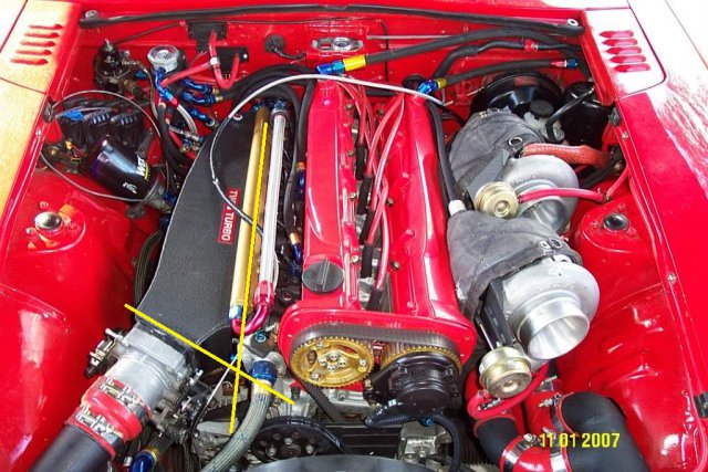

Arif Posted September 21, 2013 Share Posted September 21, 2013 (edited) I was looking at the ks racing manifold from Thailand. They sell it on ebay and the Supra guys have been using them for awhile along with one or two members here. I remember reading someone had to modify the flange because it would hit the passenger side fender. Does anyone have measurements on how much they had to cut the manifold to make it fit? I'm going to order one and the guy said he could modify it before he shipped it. For reference here's the manifold in question: http://www.ebay.com/itm/nissan-rb26-intake-manifold-skyline-r32-r33-r34-/281160700892?pt=Motors_Car_Truck_Parts_Accessories&hash=item41767bd3dc&vxp=mtr Edited September 21, 2013 by Arif Quote Link to comment Share on other sites More sharing options...
RB26powered74zcar Posted September 21, 2013 Share Posted September 21, 2013 (edited) I will try and get this angle degree needed to fit the s30 off of my plenum for you if you need it. Let me know. Edited September 21, 2013 by RB26powered74zcar Quote Link to comment Share on other sites More sharing options...
str8pipez Posted September 21, 2013 Share Posted September 21, 2013 For "only" $350 that thing is beautiful. Quote Link to comment Share on other sites More sharing options...
Arif Posted September 22, 2013 Author Share Posted September 22, 2013 On 9/21/2013 at 2:53 PM, RB26powered74zcar said: I will try and get this angle degree needed to fit the s30 off of my plenum for you if you need it. Let me know. dcp_0702.jpg 7.jpg RB26powered74zcar, yes if you could give me that info I'll let him know. He could then keep the dimensions and offer a RB26 intake that fits the s30 chassis that bolts right in without modification. Quote Link to comment Share on other sites More sharing options...
RB26powered74zcar Posted September 22, 2013 Share Posted September 22, 2013 I will do my best to get that for you asap. Only issue is I don't have a tool to show the degree of angle... I will work on getting one, soon as possible. Quote Link to comment Share on other sites More sharing options...
Arif Posted September 24, 2013 Author Share Posted September 24, 2013 On 9/22/2013 at 3:46 PM, RB26powered74zcar said: I will do my best to get that for you asap. Only issue is I don't have a tool to show the degree of angle... I will work on getting one, soon as possible. Could you use this to calculate the degrees between those two lines? http://www.acidrod.com/files/degreewheel_wInstructions.pdf Quote Link to comment Share on other sites More sharing options...

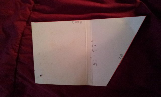

RB26powered74zcar Posted September 24, 2013 Share Posted September 24, 2013 I'll give it a try and let you know asap... joel Quote Link to comment Share on other sites More sharing options...
RB26powered74zcar Posted September 24, 2013 Share Posted September 24, 2013 Kind of crude but it's as close as I could make it... Quote Link to comment Share on other sites More sharing options...
Arif Posted September 24, 2013 Author Share Posted September 24, 2013 Thanks Joel. That's close enough for government work. Quote Link to comment Share on other sites More sharing options...
