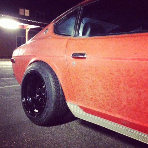

austyn Posted October 30, 2013 Author Share Posted October 30, 2013 i have ground control coils. what are your wheel dimensions? i love how your wheels sit under your car! i wanted rims that will fit under my car without flares but then fit good when i actually put my flares on. Â Quote Link to comment Share on other sites More sharing options...
rome03 Posted October 31, 2013 Share Posted October 31, 2013 They are 15x10 - 25 front and -38 rear running 225 50. They poke on all four corners. Im getting my flares installed right now, it should be ready tomorrow! Quote Link to comment Share on other sites More sharing options...

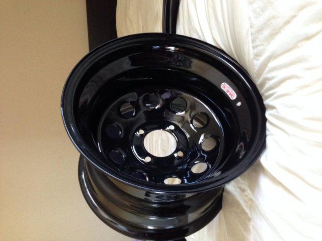

VQS30Z72 Posted October 23, 2014 Share Posted October 23, 2014 I've ordered some diamonds in 15x10 -64® and 15x8 -51(F) I should get them this Monday can't wait. Quote Link to comment Share on other sites More sharing options...
