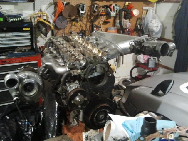

Avernier Posted November 18, 2013 Share Posted November 18, 2013 Ebay 1jz t4 mani, welded on a t3 flange, cleaned it up and braced it. Running a holset he341, adequate frame rail clearance, and it was cheap! Quote Link to comment Share on other sites More sharing options...
Avernier Posted November 18, 2013 Share Posted November 18, 2013 Here's a pic. Quote Link to comment Share on other sites More sharing options...
makaofox Posted November 19, 2013 Share Posted November 19, 2013 I like it! did you cut off the t4 and weld the t3 or did you weld the t3 on top of the t4 flange? I wanted to go ebay but 120 is kind of sketchy lol. I saw the cx racing mani which is 11ga but its $500, which is steep but looks heavy duty. I also am running a holset, he351cw. Quote Link to comment Share on other sites More sharing options...
Avernier Posted November 20, 2013 Share Posted November 20, 2013 Basically the same turbo, 12cm exh housing? 3 5/8" vband out the back? Quote Link to comment Share on other sites More sharing options...

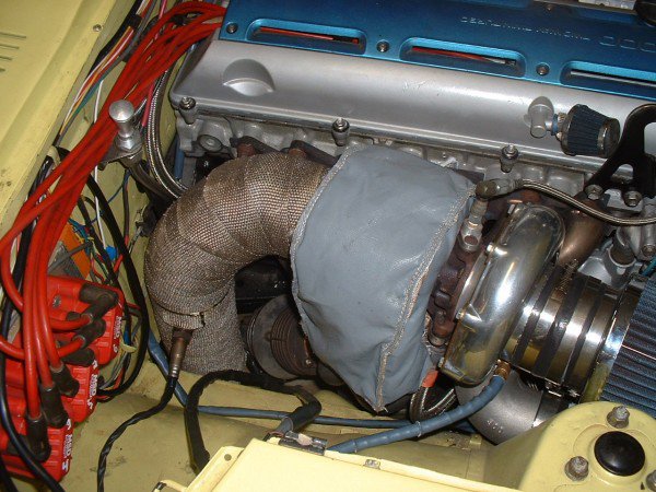

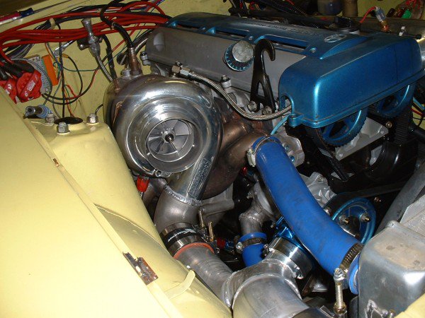

Z-Gad Posted January 24, 2014 Share Posted January 24, 2014 My old setup, but Greddy T88H manifold and Precision 76-GTS turbo with 4" downpipe Quote Link to comment Share on other sites More sharing options...
Ryan Merrill Posted January 25, 2014 Author Share Posted January 25, 2014 (edited) Badass. How was the 76 GTS on the street for driving? custom header? Wat was the primary size? Edited January 25, 2014 by Ryan Merrill Quote Link to comment Share on other sites More sharing options...
Z-Gad Posted January 25, 2014 Share Posted January 25, 2014 Badass. How was the 76 GTS on the street for driving? custom header? Wat was the primary size? 76GTS was like an on/off switch around 5500 rpm's. As long as the rpm's were above 5500, it pulled HARD. below that, no so much. As for street driving, It was like a normal 6-cylinder until the boost kicked in. Engine was built for high rpm's, and i shifted around 8500. Below 5500, it was a bit of a dog, but if I was running the car hard, I wasn't running in the low rpm range. Header was a Greddy T88H manifold - 50mm runners, they also made a smaller runner manifold for the T78 and T88 kits - 45mm runners Quote Link to comment Share on other sites More sharing options...
Ryan Merrill Posted January 25, 2014 Author Share Posted January 25, 2014 76GTS was like an on/off switch around 5500 rpm's. As long as the rpm's were above 5500, it pulled HARD. below that, no so much. As for street driving, It was like a normal 6-cylinder until the boost kicked in. Engine was built for high rpm's, and i shifted around 8500. Below 5500, it was a bit of a dog, but if I was running the car hard, I wasn't running in the low rpm range. Header was a Greddy T88H manifold - 50mm runners, they also made a smaller runner manifold for the T78 and T88 kits - 45mm runners I was thinking GT35R or something around 68mm with .81 a/r on the hot side. I will probably need to add the corn to support the boost. This car is a street car that will see road course duty and probably the drag track for some shits and giggles. Was your manifold for a T4 housing? Quote Link to comment Share on other sites More sharing options...
