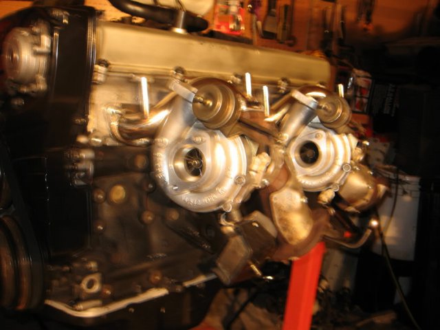

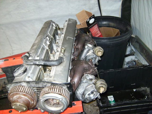

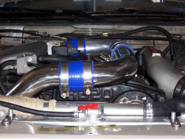

Its been done very few times, but it has been done. Someone here on Hybridz did it. RHD makes it easier to clear if you want to build custom manifolds. Otherwise, you should run modified RB26 twin turbo manifolds. They will allow you to clear the S30 steering shaft. Or run some aftermarket top mount twin manifolds. Either way youll have to mod the flange by rotating the 1 runner flange 180 degrees on both manifolds.
Theres a few pics out there of RB20DETT's. Any I've seen use modded RB26 manifolds and stock RB26 collector pipe.
