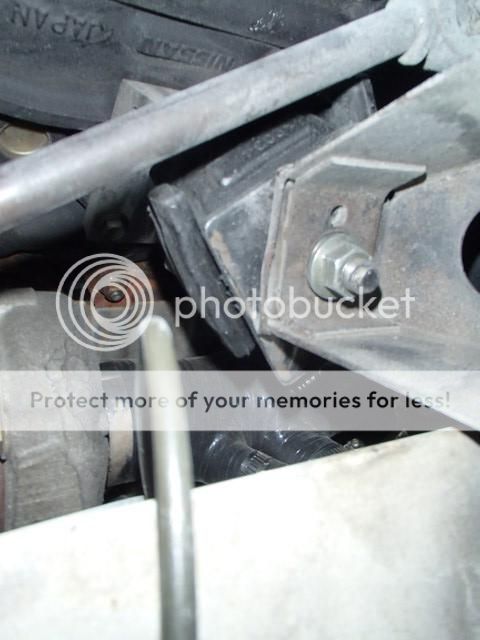

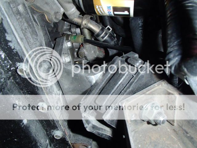

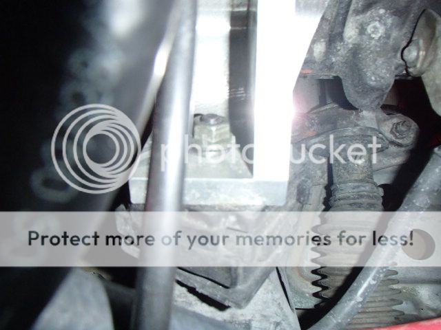

wrcbonk Posted December 27, 2013 Share Posted December 27, 2013 I growned down the set pins on the factory cross member to allow me to rotate the supra isolators positioning the engine at the right orientation. Quote Link to comment Share on other sites More sharing options...
05plsrt4 Posted December 27, 2013 Author Share Posted December 27, 2013 Your mounts kinda do the same thing as mine. They're all twisted. They don't look like they will last very long like that. Quote Link to comment Share on other sites More sharing options...
wrcbonk Posted December 28, 2013 Share Posted December 28, 2013 I anticipate having to swap them out for something more generic like the puck style isolators you see in the McKinney kits, maybe something made by Energy Suspension. Quote Link to comment Share on other sites More sharing options...
