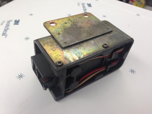

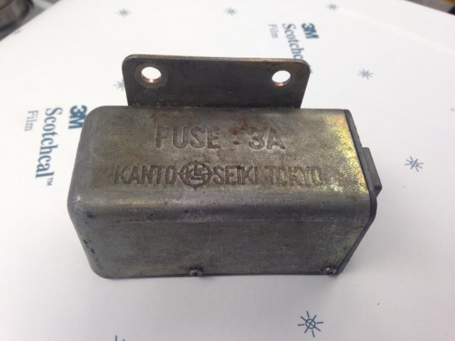

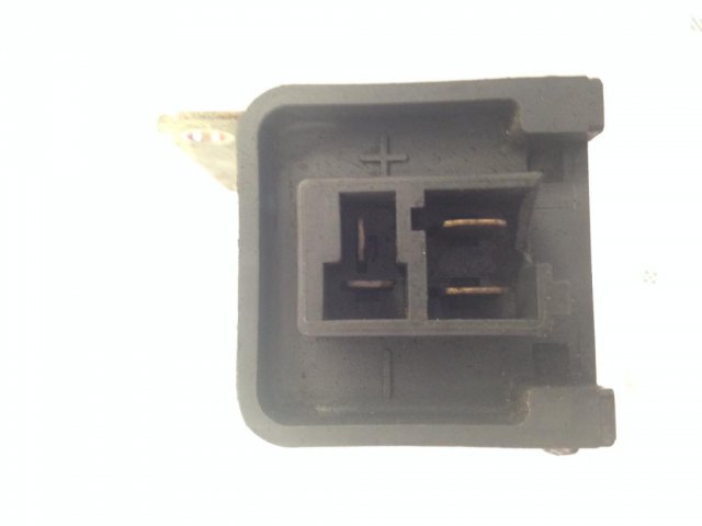

Can anyone ID this?
GeeZ
Sure thing. ;)
It mounts on the right fender, underneath the engine bay plate and voltage regulator. All the car's power runs through it, so unless you modify the wiring (jumper across shunt) then you will need it. It's one of those 260Z-only things. I have two 260Zs but only one shunt, as I can't seem to find my other one...
