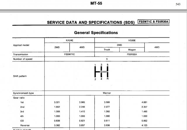

NewZed Posted January 29, 2014 Share Posted January 29, 2014 (edited) Opportunity to keep the picture-editing skills in shape. 1995 Pathfinder ratios. Edit - of course the 4WD's transfer case would be an issue. Better check overall transmission length also, Nissan likes to make the truck transmissions shorter. Edited January 29, 2014 by NewZed Quote Link to comment Share on other sites More sharing options...
