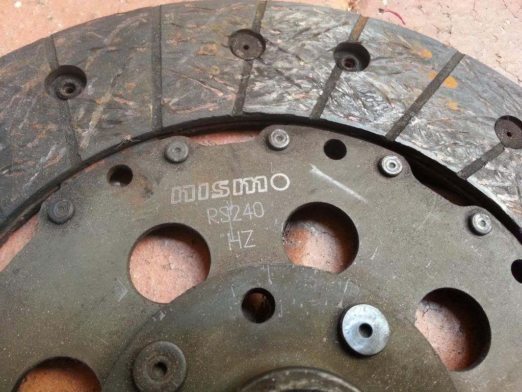

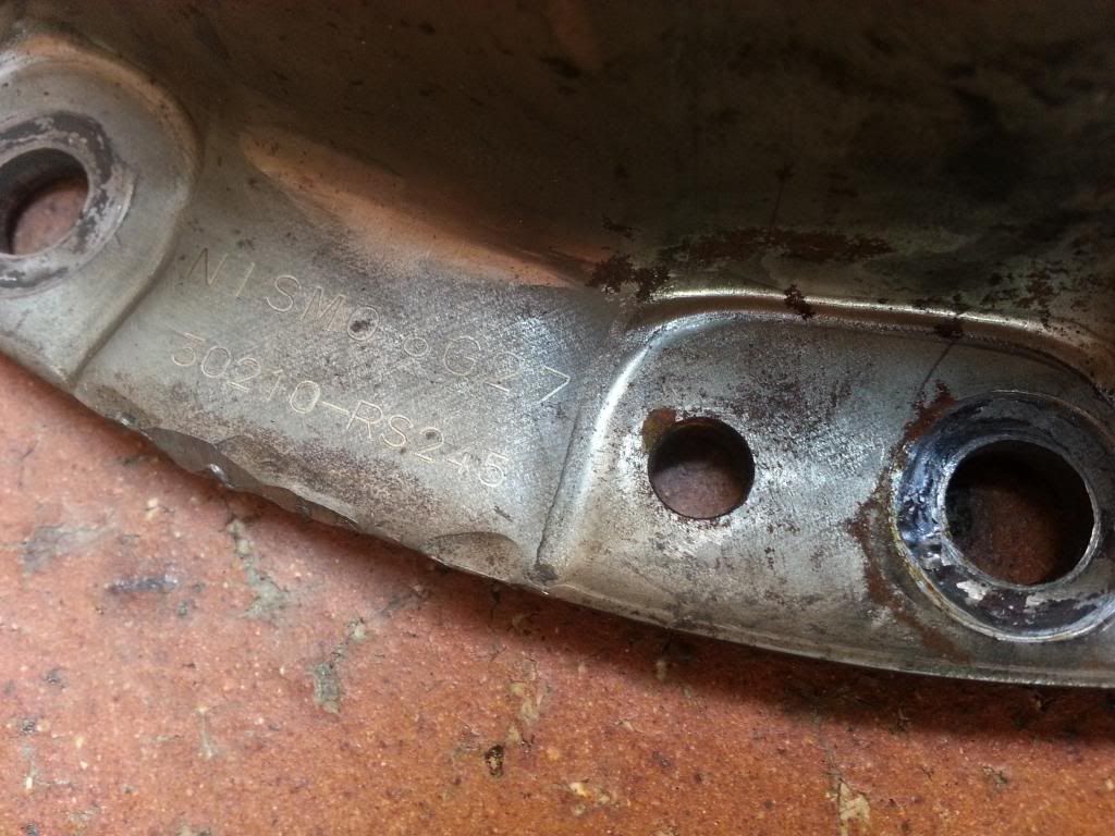

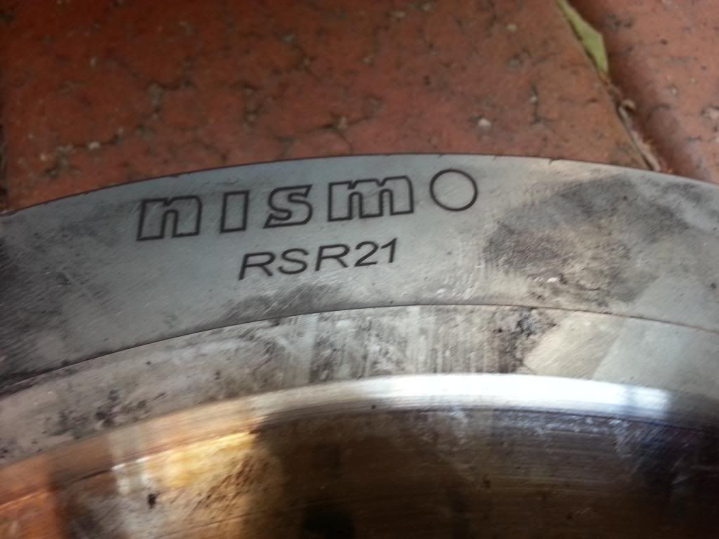

Engine is an RB26 with a Nismo RSR21 flywheel, Nismo RS240 HZ clutch, and Nismo G27 30210-RS245 pressure plate.
